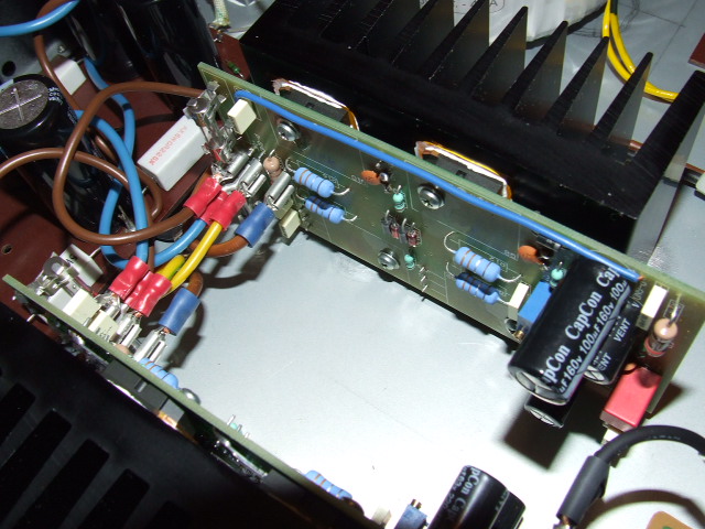

Rod's boards are for two pairs of TO3P latfets (flatpack plastic types), not for TO3! Here is the pic of my ESP P101 build.
