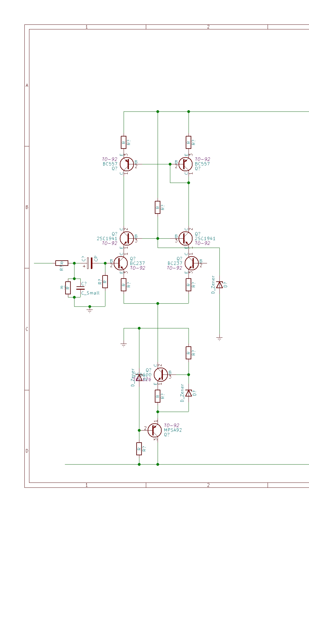

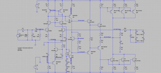

First, I will admit to myself that these attempts may prove useless.
After so much head scratching, I inputted the input stage of what I think the input stage should look like. I am using the CAD hog named KiCad. It is a huge piece of software that probably requires one to buy a book to even start using it. As you can see, I haven't figured out how I can neatly display the various texual descriptions displayed next to components.
The attachment is the first stage as I am imagining it. I will use a cascode to isolate the input from the high voltage of the power supply. I am aiming to first make the input stage, test it to make sure it meets its required standard and then proceed to the VAS. The power stage is already built as it was part of a large public address amplifier that failed. I will usethe PA amplifier's chassis, power supply and power stage and redesign the pre-driver stages.
You may deem me mad, but sometimes being mad may be the only adventurous and successful route.
I am posting both for your comments (criticism) and hints about how I can use KiCad to get a better looking schematic and for improvements that I can make to the input stage.
Thanks to all those who made this website a reality and to those who will contritbute to this thread.
Mooly 8th August 2018 12:31 PM
I can't answer your KiCad question, but would say that if your are interested in both drawing circuits on screen (and if you wish simulating them as well) then LTspice might be worth looking at.
As to your circuit, well the most obvious problem at the moment is you have all NPN transistors as drawn whereas the upper two should be PNP's while the lower NPN appears to be the wrong way around. Not quite sure what you are intending the lower one to do actually :)

spladski 8th August 2018 04:42 PM
I am seconding Mooly's reply with a stronger recommendation that you use LTspice simulator. The circuit as drawn cannot work so there is no point in a prototype.
LTspice will prove the concept functionally. Although simulation cannot emulate with 100% accuracy, it will save you a heck of a lot of time. It is also standard procedure for this site, as it makes collaboration with others more productive.

I am on Linux, Devuan ASCII. Installing more software means more time dedicated to setup software that I have never used in my life. Using KiCad my concentration is more focused on the new commands that I am learning to use rather than the components. Yes, as mentioned to me, there were 3 transistors that should be PNP: the two comprising the current mirror and the transistor at the bottom negative power rail. Software teething problems are distracting me from focusing on circuit design and on doing circuit calculations to make sure everything works within planned currents and voltages.
The lower part of the circuit consists of a series pass voltage regulator which powers a current source that is used to supply a constant current to the differential pair. The voltage of the differential pair is truncated using a cascode so that they work with a voltage of around 6.8V - 0.7V = 5.9V. According to Douglas Self, I should try to use a constant current of 6mA but I find this a little too high. I know there are amplifiers that use less about 2.5mA. I am still hesitant about using a current mirror as the interface for the differential pair. I think, using a complementary pair of small signal transistors with their bases connected to both heads of the differential pair, can also work and ensure the differential pair always conduct nearly equal currents.
