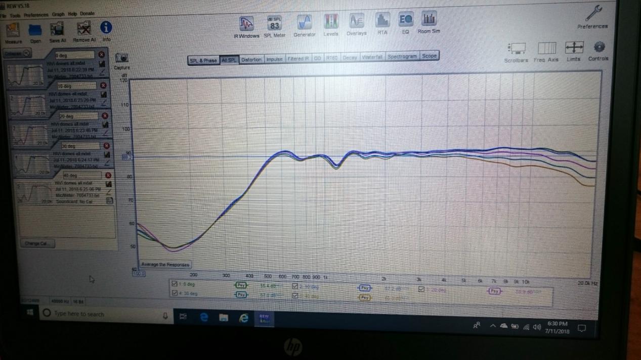

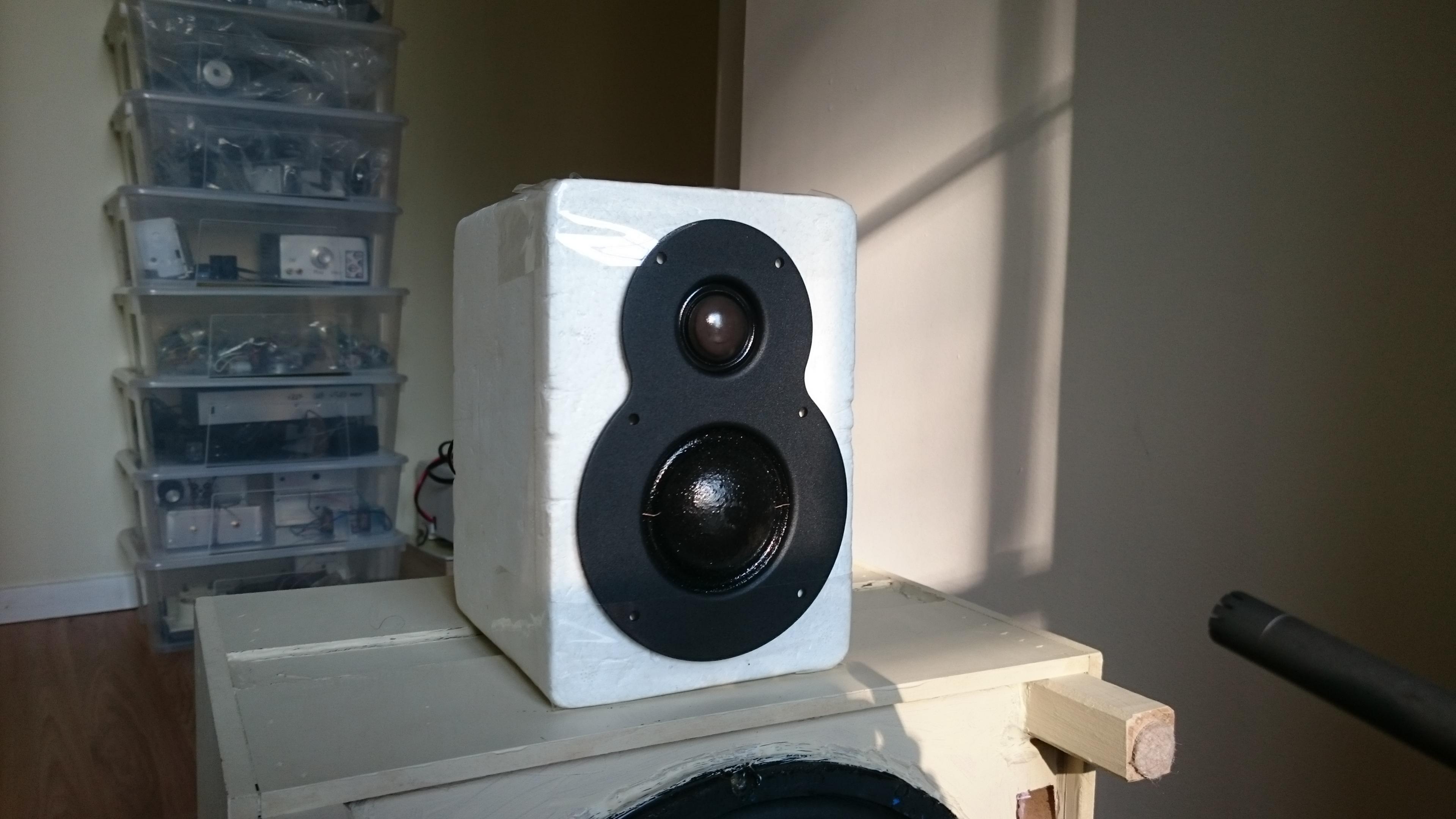

Hi all, just wanted to point out to nice dome midrange and dome tweeter combo from Hivi. I have seen pair for $59 on ebay, so I bought it. Mainly because I love domes. I got plenty projects done in the past with old Philips domes, lately with Dayton domes, all good sounding. Frankly I do not understand why dome mids are not used more often.
Here is the measurement I obtained, just slapped on its styrofoam transport box. 30uF and 3 uF caps used for measurements, no coils.
Now I just need to find nice 8-10" midbass to mate it with.
Cheers!

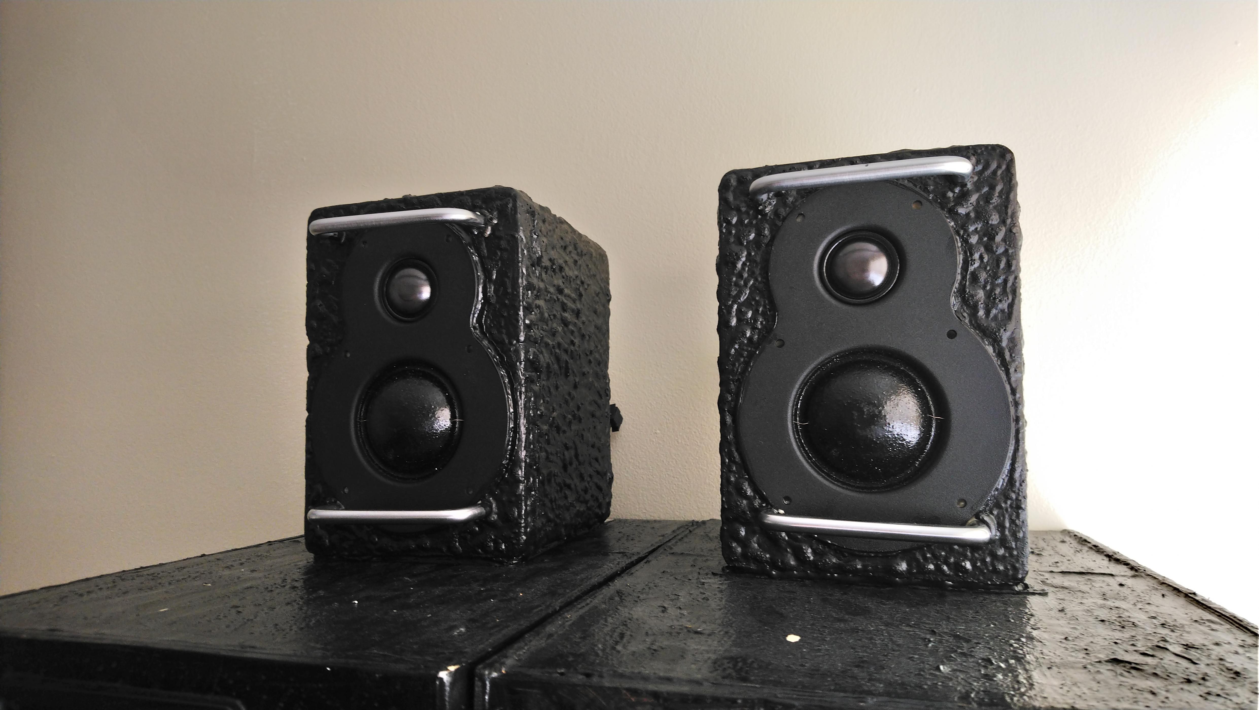

There is dc50 dayton dome, soft dome with almost no breakups, i am using two per side now in mtm arrangemet with hivi ribbons. Great sound.
But i removed front plates to be able to mount all as close as possible.
Big front plate is limiting crossover frequency, but once removed, no problem. Its just glued in place.
