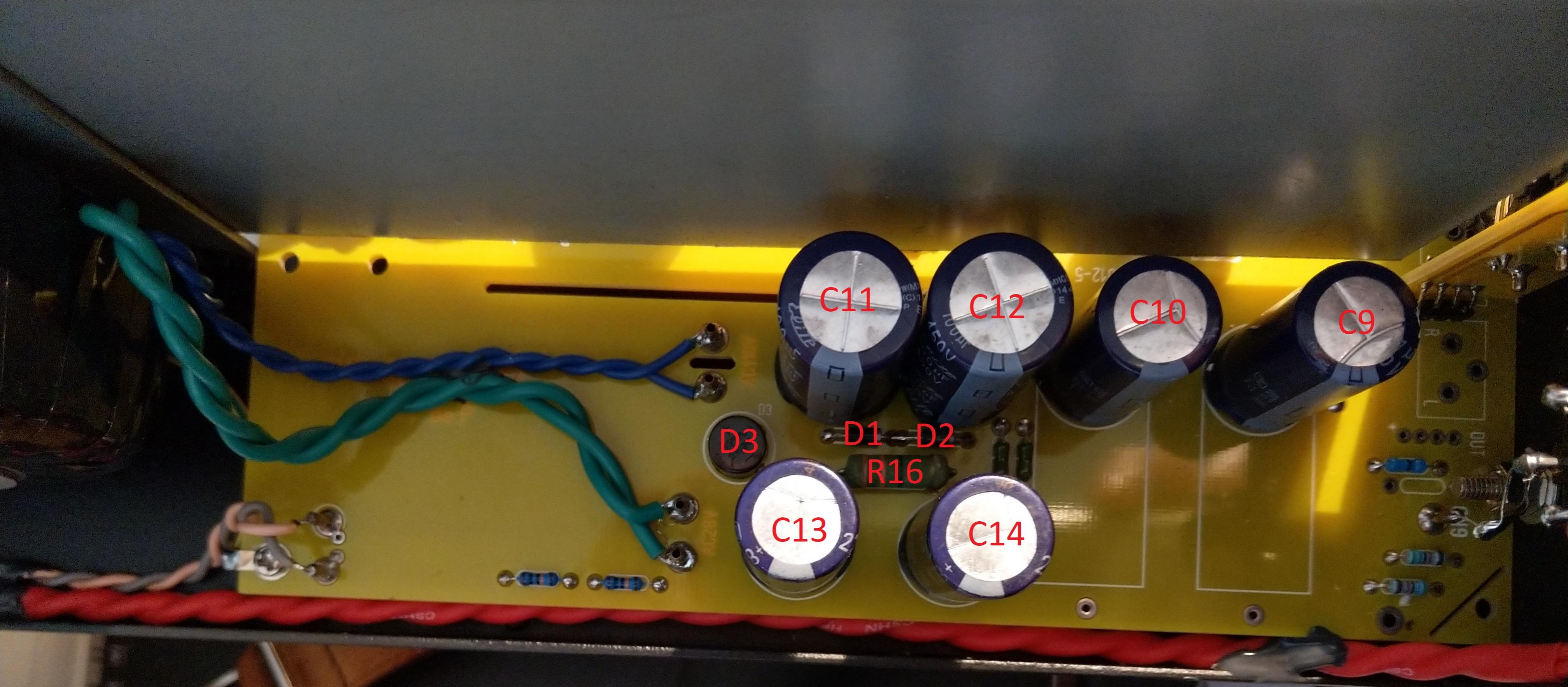

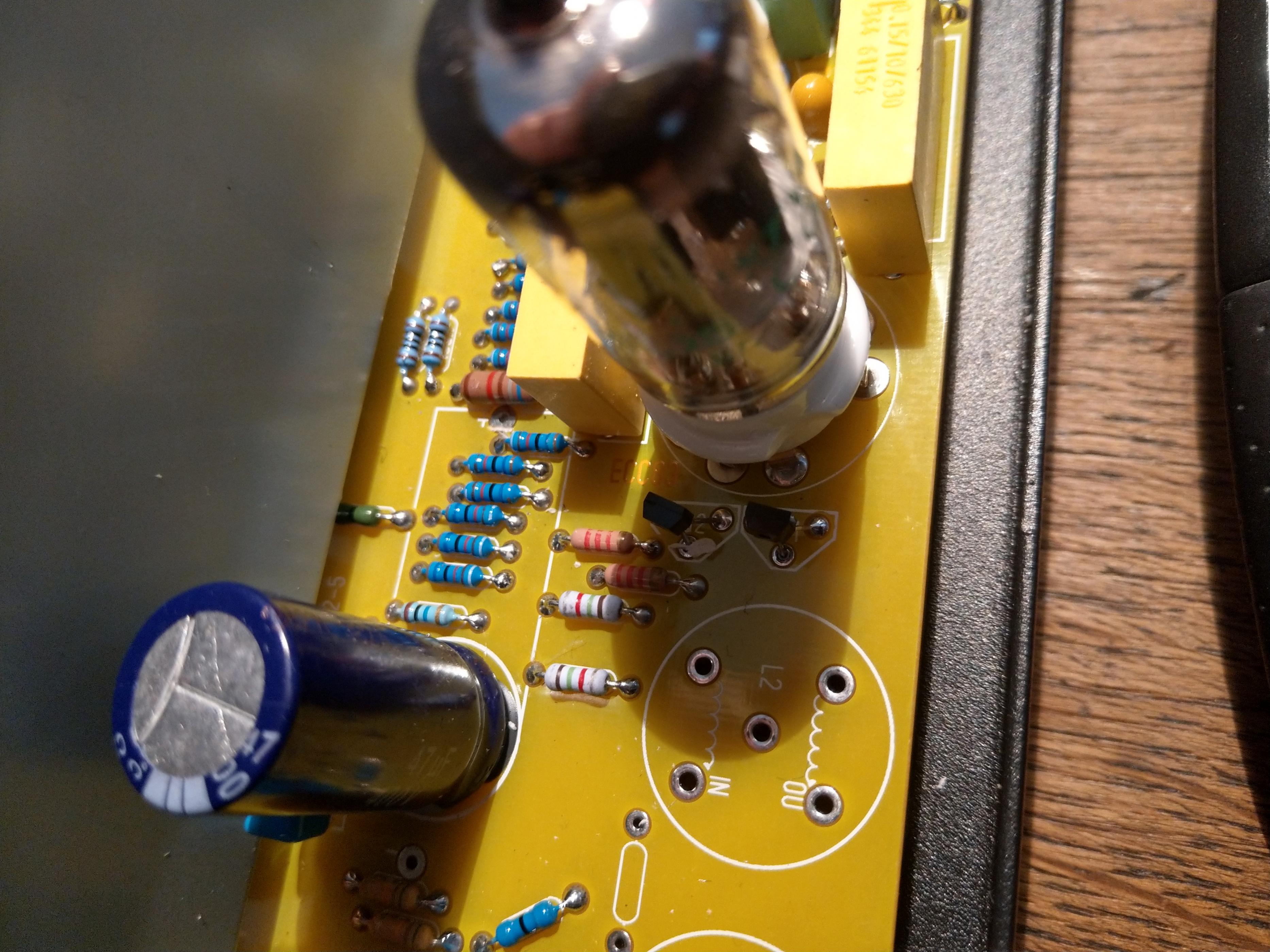

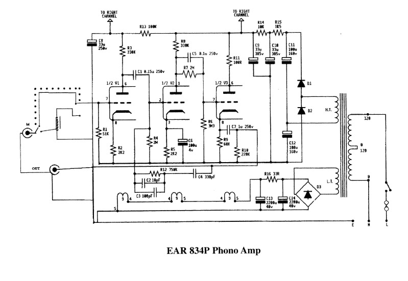

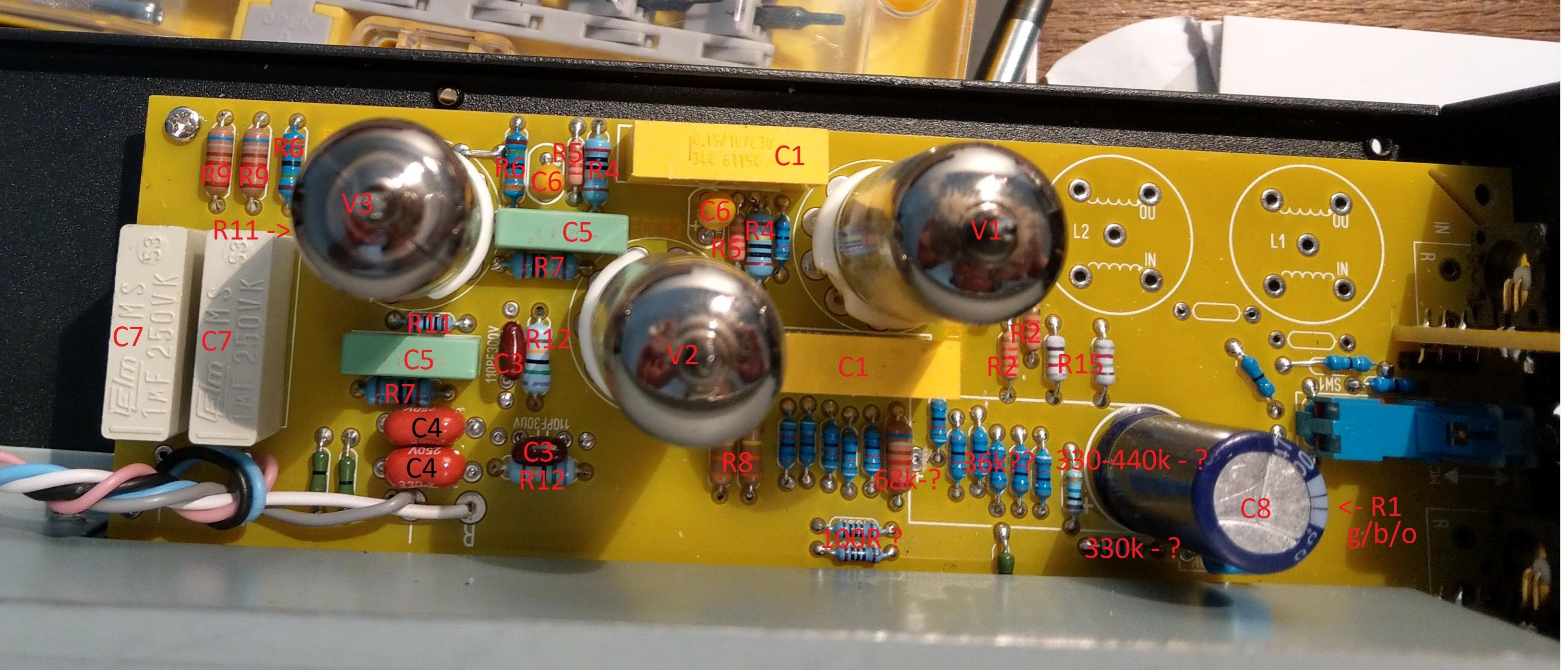

I am currently in the process of modding a Douk clone EAR 834P. Not reinventing the wheel here, mostly just upgrades of coupling caps and whatnot .. Thorsten Loeschs Mod guide is well known and I am mostly keeping to it. Most components were easy to identify on the board, but some are really strange. Maybe somebody with experience with the unit can help me.
I have labelled a photo I am using for reference to the markings of the original schematic. I'm having trouble identifying the anode resistors of V1. They are supposed to be 330k, but I don't see them (maybe the two close to C8?..). I don't know where the 12 little 36k Resistors come in .. guessing they are somehow drawn together to substitute for a bigger resistor, but I don't yet know what and why. There is a single stray 68k Resistor close to V1 I can't place... And the strangest thing are two .. well I think semiconductors / transistors close to V1 labelled Q1 and Q2 (see last picture). What would they be doing there?...

The schematic you are referencing is not precisely the same. I’m assuming Douk made some alterations.
Also, complicating matters the 834p schematic often circulating the web from one of the manuals which you reposted here is also not the same as the production 834p. Maybe the first iteration circa late 90’s but there’s notable differences now such as the JFETs you referenced.

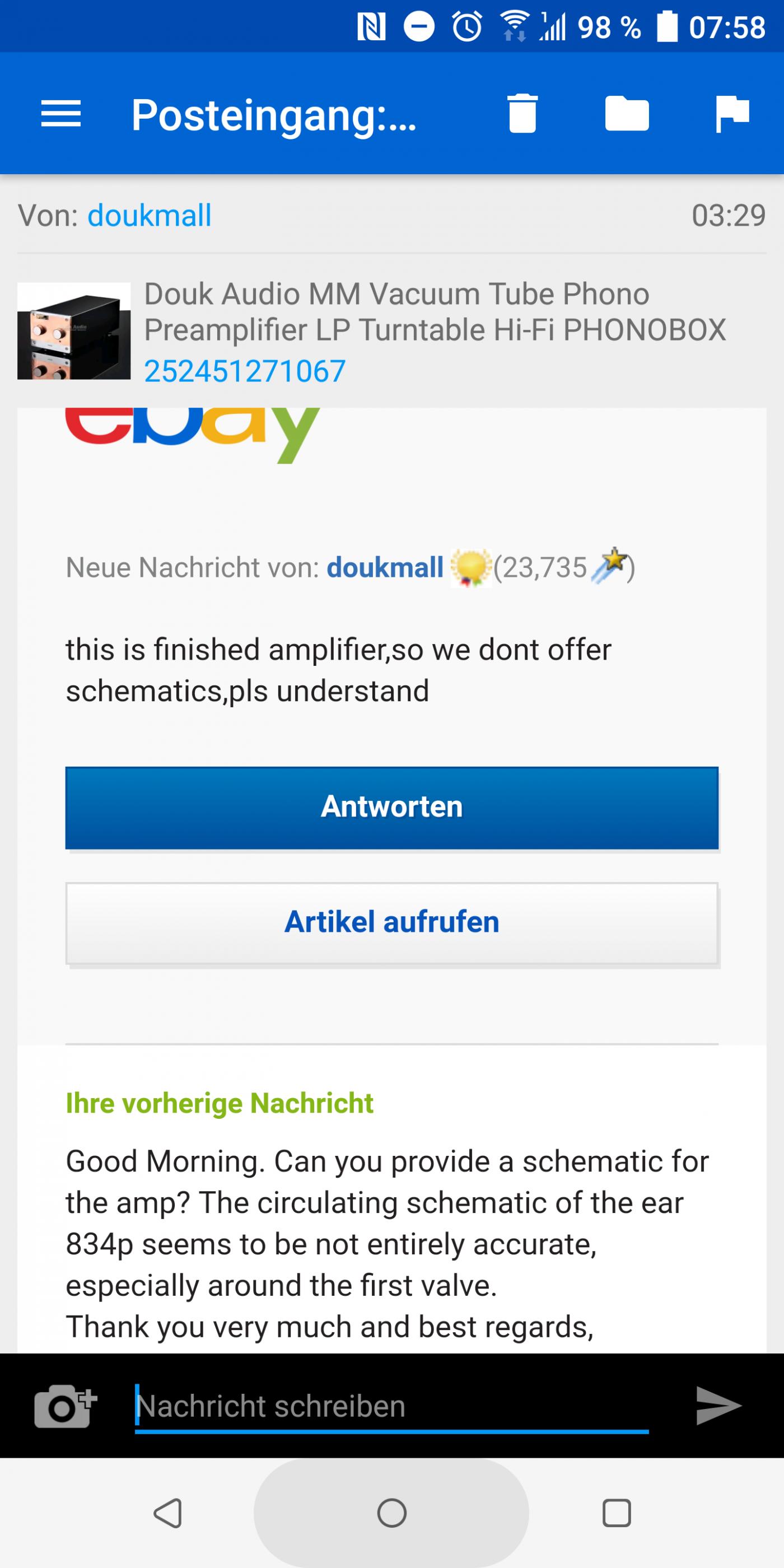

I would ask Douk for a schematic of this design in particular or else you risk causing more harm than good.

Yeah, I kinda noticed that it didnt quite fit the schematic around the first tube .. the rest is accurate though. And swapping parts for equal value never caused any harm, so...
Just trying to understand the thing entirely, since learning is one part of the reason I'm doing work on valve amps.
Get the schematic from Douk and post it here, then we can actually learn something.

JFETs may be the critical component to replace in matched pairs anyhow. Can you get part numbers off them? (Q1 and Q2)

I've written to Douk some days ago, but they are yet to reply. I don't quite count on getting a schematic.

Regarding the Transistors, I will take a closer look when I open the amp up again. I'm needing it in working order these next days. I guess things will get much clearer once I've removed the board and can see the traces. Right now I'm suspecting the Transistors might be remnants of the not installed MC part, which in the Douk version is supposed to be a cheap step up amp encased to look like transformers... Will keep you posted. ;)
Looking at the pictures, it appears that Douk even copied the terrible board layout of the original...
I would hope/expect that those jfets are actually signal input, cascoded under the first 12ax7/e83cc. This would be a very good thing if it is the case. It would keep input miller capacitance low, which helps keep most MM cart freq. response a bit flatter after 15kHz.
If you are really interested, you could trace the circuit from the back of the board.
I have a feeling some of those 36k resistors are in parallel. If you don't have a 10k 2W resistor, but have four dirt cheap 36k 0.5W resistors... well, you can figure this out this I think. ;)

I had very much feared someone would say that. Although I searched extensively, I have not found a schematic with that topology. Which advantages might this design offer over the original?
cascoded jfet input is something that Allen Wright did too. It is a nice way to keep miller capacitance low.
The purple guy in the above diagram is not what you want. I don't know how many times I hear an MM phono set-up that sounds like purple-guy. Shrill sounding... I can hear it right away. Very quick listening fatigue...

I would hope/expect that those jfets are actually signal input, cascoded under the first 12ax7/e83cc. This would be a very good thing if it is the case. It would keep input miller capacitance low, which helps keep most MM cart freq. response a bit flatter after 15kHz.[...]cascoded jfet input is something that Allen Wright did too. It is a nice way to keep miller capacitance low.
Thats a good improvement then. My hate on what I thought was a repair on something not broken slowly subsides. :D
I'm planning on doing that. They peaked my curiousity. Gonna draw up a schematic also.

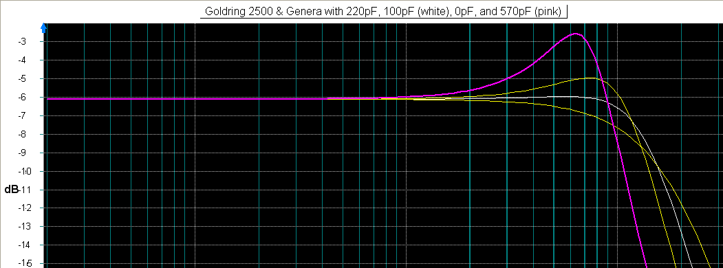

to keep miller capacitance low.The purple guy in the above diagram is not what you want.
Many others have, like Audio Research. There's lower noise too. Are those actual
cartridge response curves? Usually there is a broad dip before the peak.
Nagaoka MP500 is a fine cartridge. So you definitely do want to keep an eye on the miller capacitance on the phono input. once checking, I would leave in the jfets.

The power supply change made a big difference for me. Back then I used a well shunted supply. Today I would probably build a statistical regulator like Morgan Jones...

Yes the FETs are a good thing if implemented well.... I’m just skeptical Douk used closely matched devices or the same as ear. Do you have a way to test the FETs? The ideal RIAA values would be 787K, 100pf and 303pf.
Also special care should be given to the 2M feedback resistor. Placing a grounded can over V1 will also make a big difference. Also using channel matched low noise and microphonic selected tubes is critical. I’d recommend the 12ax7EH or SPAX7A for new production.

I am planning on leaving them, you have made a compelling argument. I have no way to test or match FETs. I had rigged something about seven years past to test FETs for a symasym build I did, but it was a breadboard and was quickly taken apart after... I hoped I did not have to do that again...
Can you fit a Salas shunt regulator on the ps side? If so I’d gut what’s there.
I think it's safe to say that the PSU is critical in pre amps and propably the biggest improvement you can make to an existing circuit. I have early on made the decision to not rebuild the PSU, because I just don't have the time anymore. Initially I only wanted to change the coupling caps, but the whole thing escalated once again...

There is honestly only so much to get out of this topology. It can be pushed pretty far, but at some point you might want to go for something different.
The riaa is tricky... easily changed by a few picofarad. The input 12ax7 can easily change it too - checking input jfets is probably not necessary, but you can run a jfet off a battery supply (which makes setting up a testing rig easy). Jfets from the same batch tend to exhibit similar characteristics. Mosfets however are a different story... From my experience there will be far greater potential variation between input 12ax7 triodes than the jfets.
What is the psu transformer like? The original ear834p was quite modest. Be happy you have no hum.
