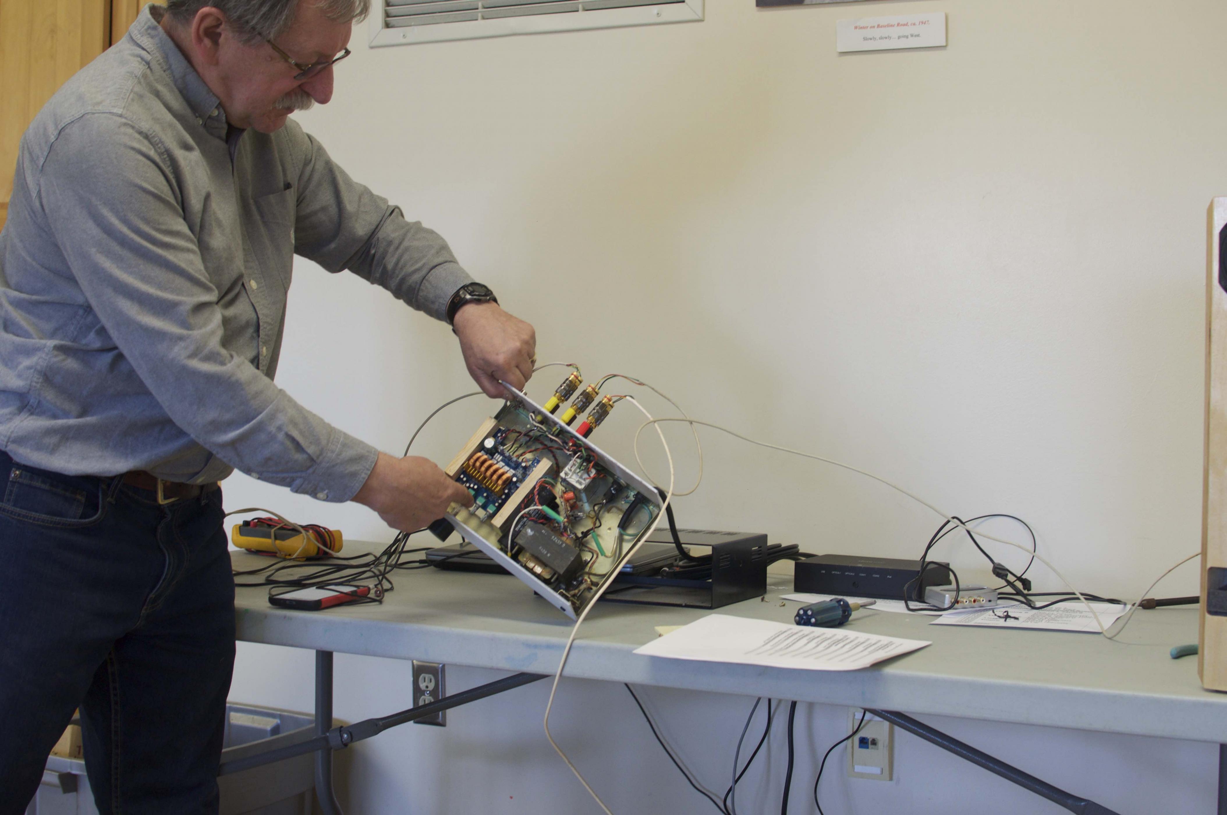

the tpa 3116/3118 is very popular and can be powered from a laptop brick. There are several hundred posts concerning those chips here. I put one together for my daughter for $10 and what I had in the junk box. 20 watts per channel is more than plenty for her apartment.
