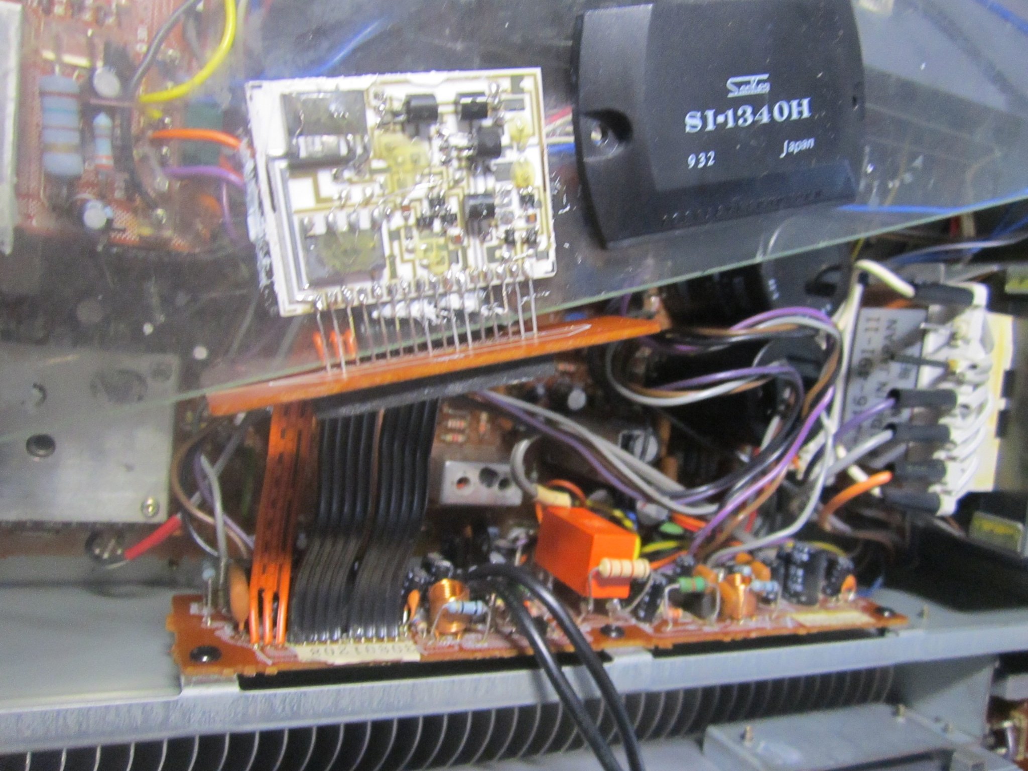

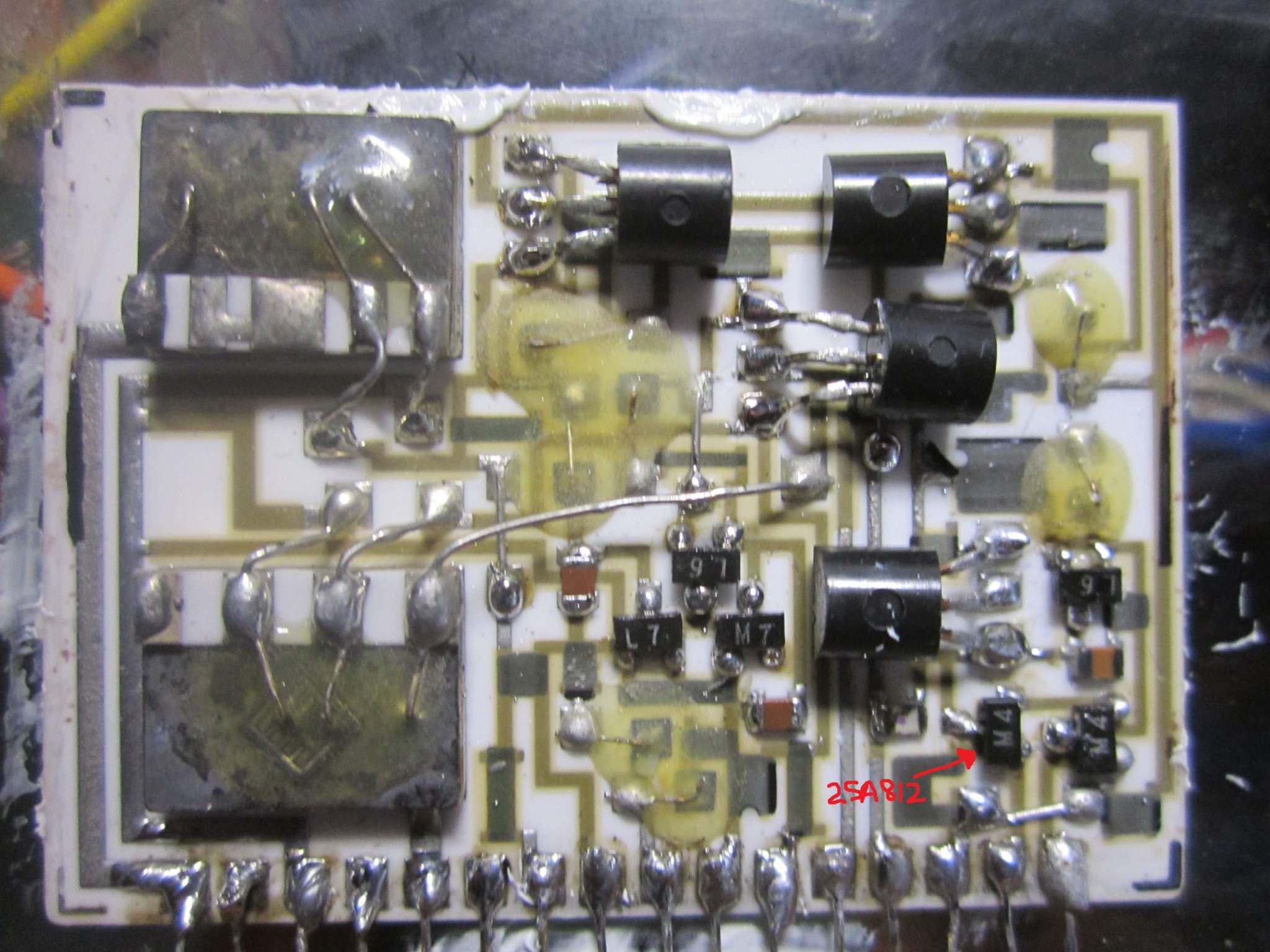

Hi. I repaired one SI1340H with the same symptoms. The problem was caused by a 2SA812. In the picture is pointed the replaced transistor. I think that in case of failure, all the smd transistors are suspiscious. They are 2SA812 and 2SC1623. In the transitor datasheet, number in marking code is asociated to hfe data.
Is paradogic, but for to know how to open the SI1340H I broke the other good IC. For to open the IC, aply hot for to burn the glue, then you open the IC like a oyster. Then, applyn hot in the pins for to remove, because the pins are bonded to the plastic cast. You have to remove the pins from the plastic cast later.
