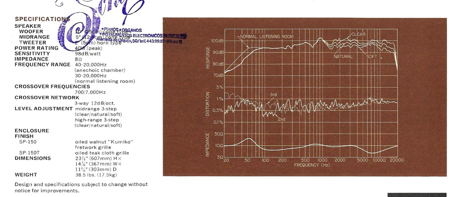

Hello,
I have a pair of beautifull Sansui SP-150. My living room is around 15/20m².
So well can you help me to define my power needs and the amp style between :
1/ 25 Watts push-pull KT88
2/ 10 Watts SE 300B
For both I will use Lundhal output transformers, the standard version (probably ll1623 for both).
The spec of speaker :
Type: 3 way, 3 driver loudspeaker system
Frequency Response: 40Hz to 20kHz
Power Handling: 40WC
rossover Frequency: 700, 7000Hz
Impedance: 8Ω
Sensitivity: 98dB
Bass: 1 x 250mm cone
Midrange: 1 x 125mm cone
Tweeter: 1 x 50mm horn
Enclosure: bass reflex
Grille: hand carved Kumiko fretwork
Finish: oiled walnut
Dimensions: 607 x 367 x 303mmWeight: 17.5kg
Thank you in advance !

More over, I have some doubt about the datasheets of the loudspeaker .... at least I doubt than the annonced efficiency could be for all frequencies ... from 20 Hz to 20 kHz ...
According to the graph on the datasheet above, your Sansui has -20 dB on 40 Hz. How much power do you need to boost 20 dB on 40 Hz?
