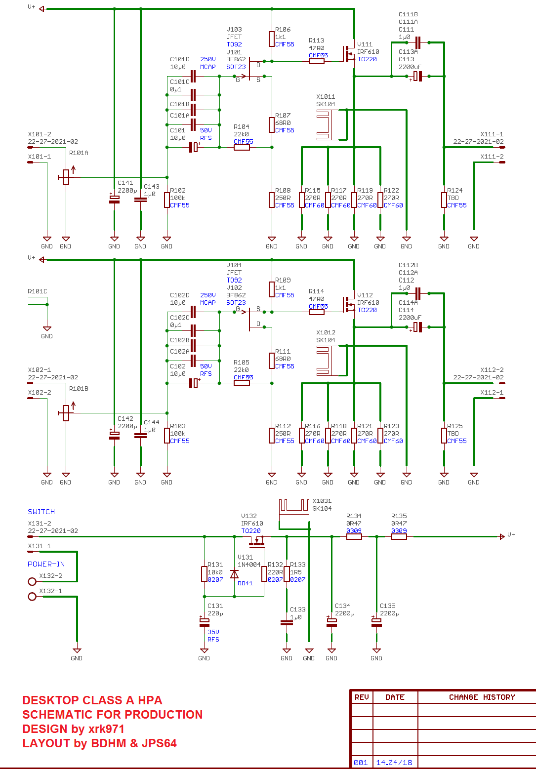

This is a spin-off from the PCA (Pocket Class A) amp. It’s the same topology but I wanted a separate thread to discuss the technical aspects which are different. This amp is a joint effort between myself, BabyDontHertzMe (BDHM), and JPS64 whom both did a fantastic layout for the PCB. The DCA is designed for through hole components with lots of room for capacitor rolling options, a built in capacitance multiplier and CRCRC power supply section. There are 3 ground planes (PSU,Left, Right) that come together at a star topology. The board has almost identical high current traces on both sides that are joined with thousands of vias for a true low impedance path. Nominal design is for 20v Vcc, 125mA bias current and can be pushed as high as 25v Vcc for driving low impedance cans. Typical performance is 0.015%THD all H2 and a little H3 for 1vpp into 42ohm load. Can drive 42ohms as high as 544mW without clipping. Sound is powerful, and being zero global feedback, has an impressively wide and accurate soundstage. The signature is engaging and natural with no hint of fatigue. Tested with DT880-250, OB-1’s, and HE-400i. All sound fantastic and can get louder than you can handle comfortably without strain. In summary, it’s an easy to build amp and and designed for the DIYer who likes to tweak. The nice low noise PSU built in simplifies the power supply logistics.
Schematic of Production Board:
679489d1525836497-xrk971-pocket-class-headamp-gb-xrk971-desktop-amp-schematic-v2-production-portrait-png

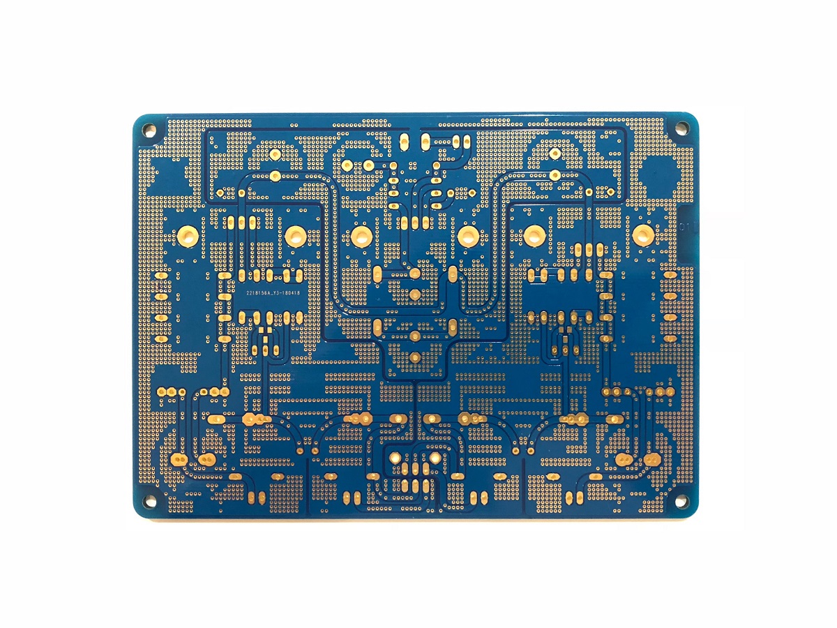

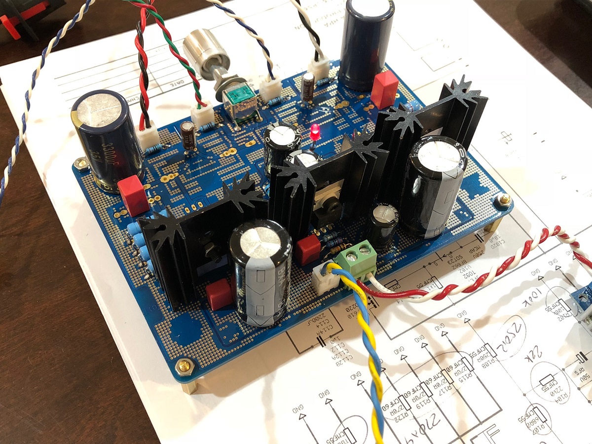

Actual PCB:
679262d1525754963-xrk971-pocket-class-headamp-gb-desktop-amp-pcb-photo-jpg

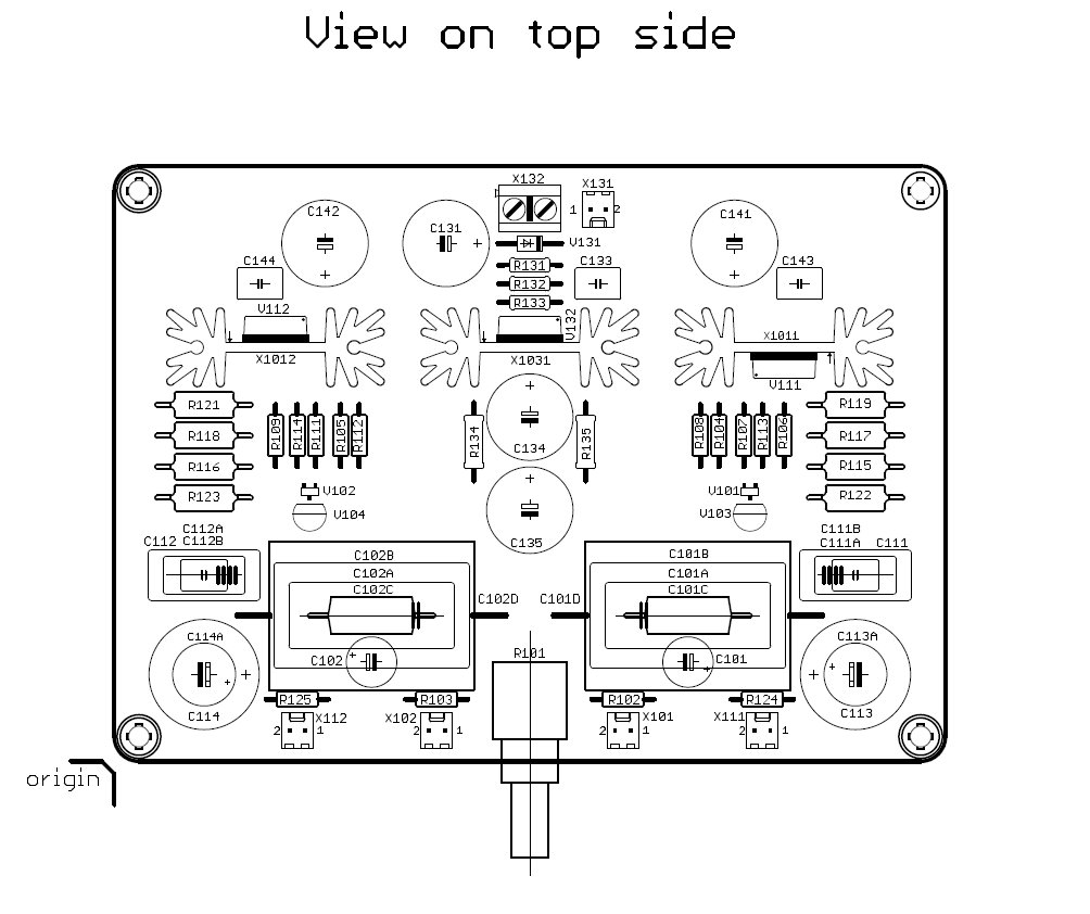

Stuffing Guide:
679339d1525781867-xrk971-pocket-class-headamp-gb-0bc0cbc4-0d1b-41b9-9c0c-04ed6985b5a3-jpeg
Please note that polarity of 4 jacks on front from left to right is +ve -ve / -ve +ve / +ve -ve / -ve +ve
Due to mirror symmetry.

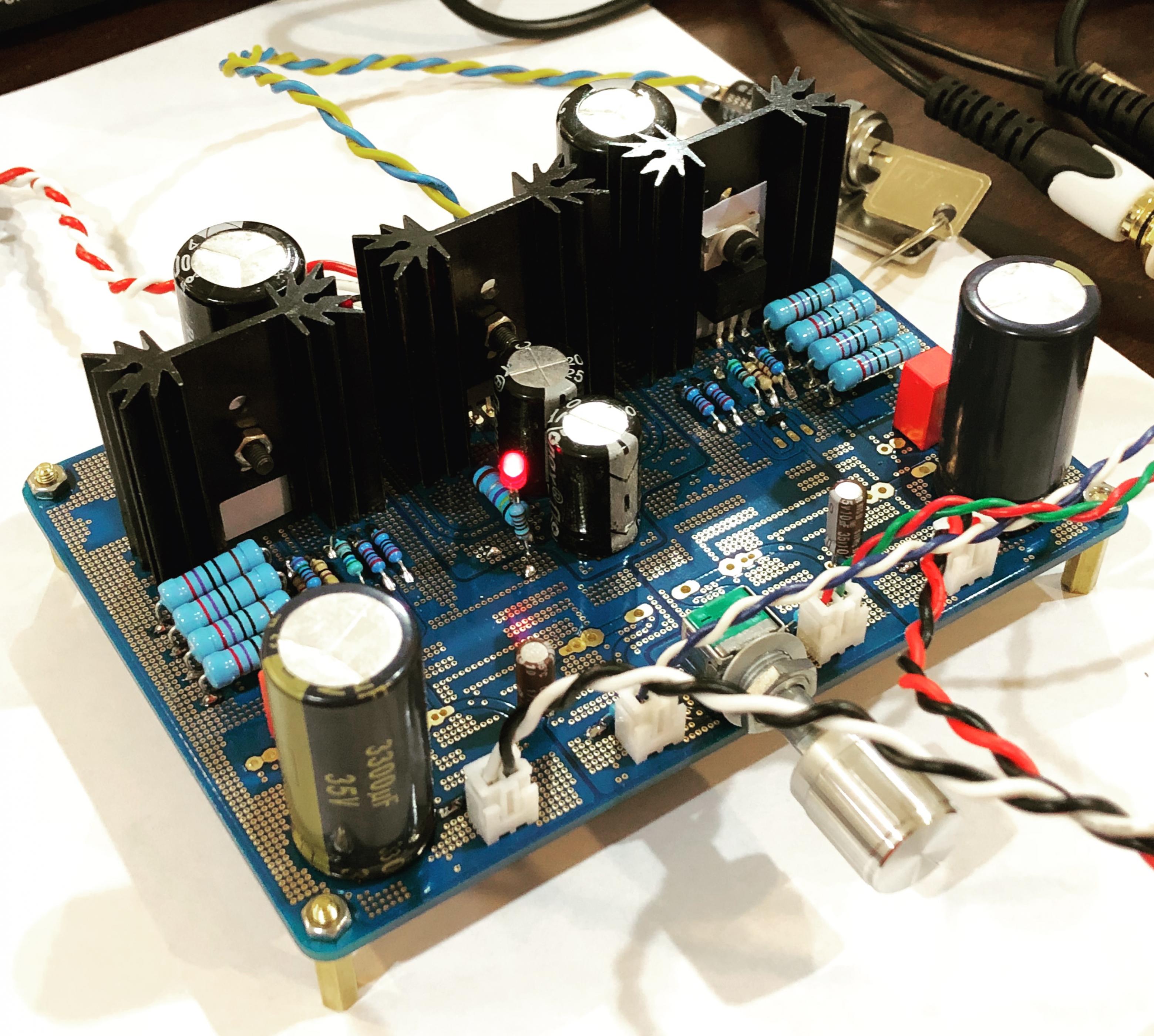

Built up Amp:
679919d1526006465-xrk971-pocket-class-headamp-gb-607a5f68-c10e-43c5-aa9b-984bbdb911e7-jpg
Rear View
679735d1525938938-xrk971-pocket-class-headamp-gb-build-desktop-hpa-03-jpg

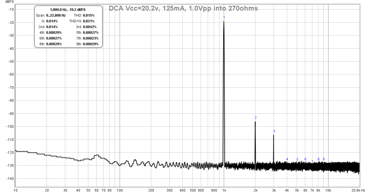

Measurements:
20.2v Vcc and 125mA bias
679967d1526039467-xrk971-pocket-class-headamp-gb-dca-20-2v-125ma-1vpp-270ohms-fft-4-png
21.3v Vcc and 0.0066% THD
679969d1526039508-xrk971-pocket-class-headamp-gb-dca-21-37v-135ma-1vpp-270ohms-fft-1-png

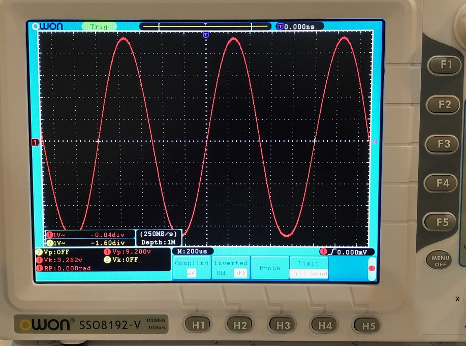

Power Measurement Test into 42ohm load:
680143d1526117185-xrk971-pocket-class-headamp-gb-build-desktop-hpa-max-power-dmm-05-jpg
Corresponding O-scope shot:
680144d1526117185-xrk971-pocket-class-headamp-gb-build-desktop-hpa-max-power-oscope-04-jpg
I was able to get 10.5vpp without clipping for 544mW into 42ohms.
