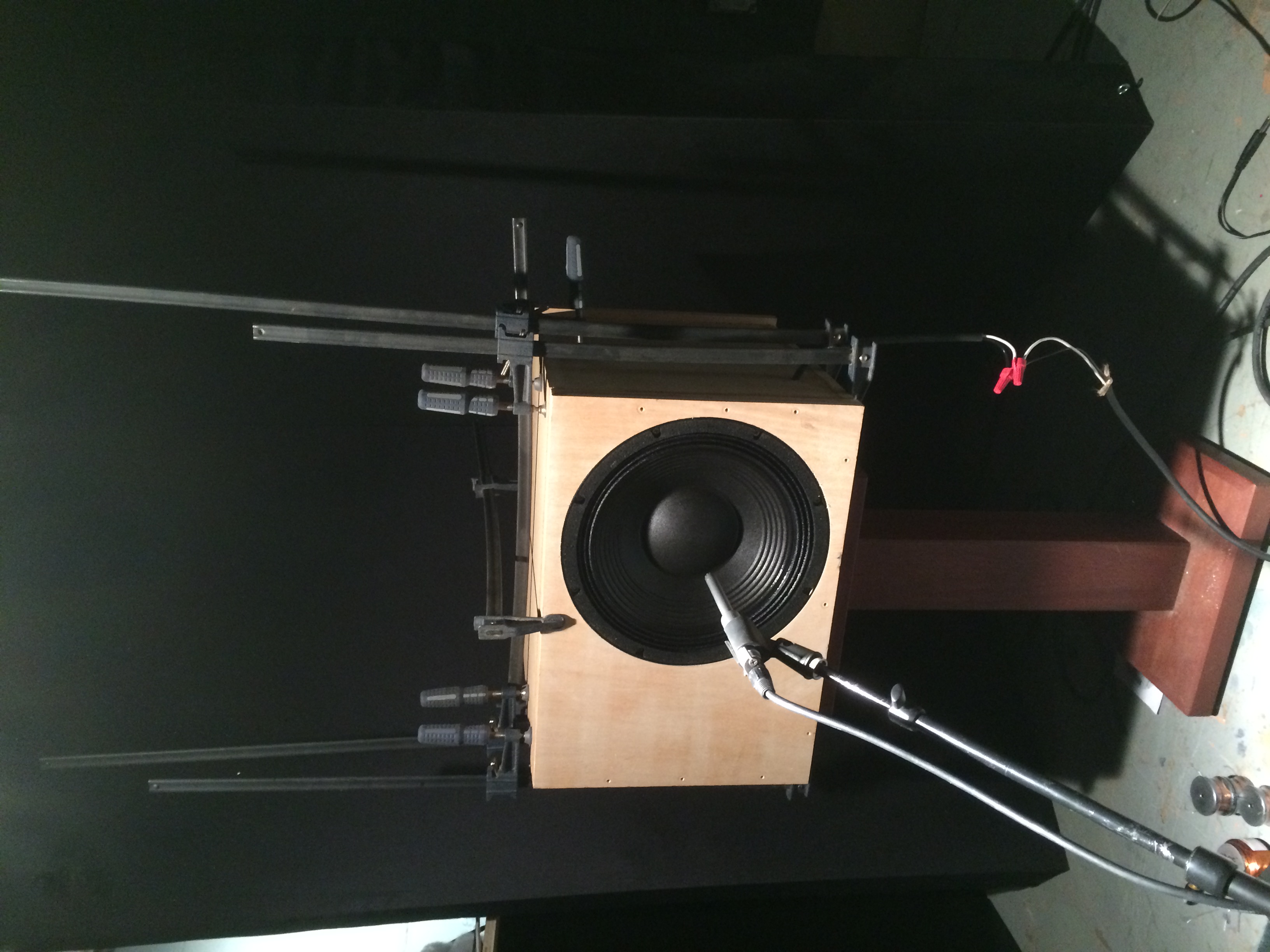

When I put a sound source into a complete cabinet, I found that almost 100% of the sound was able to leak out through the woofers. Moderate vs heavy stuffing only made a ~2dB difference under 400Hz.

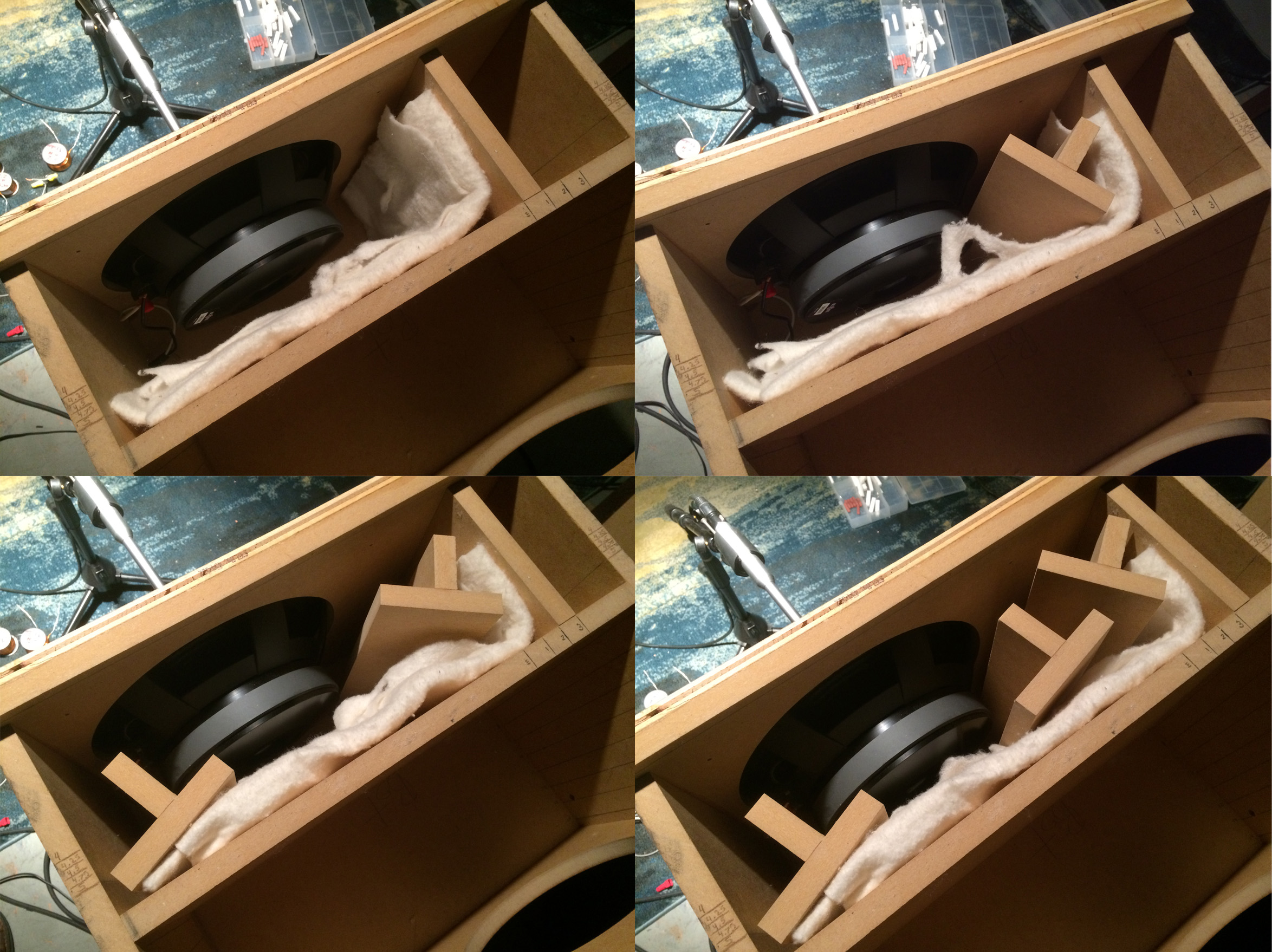

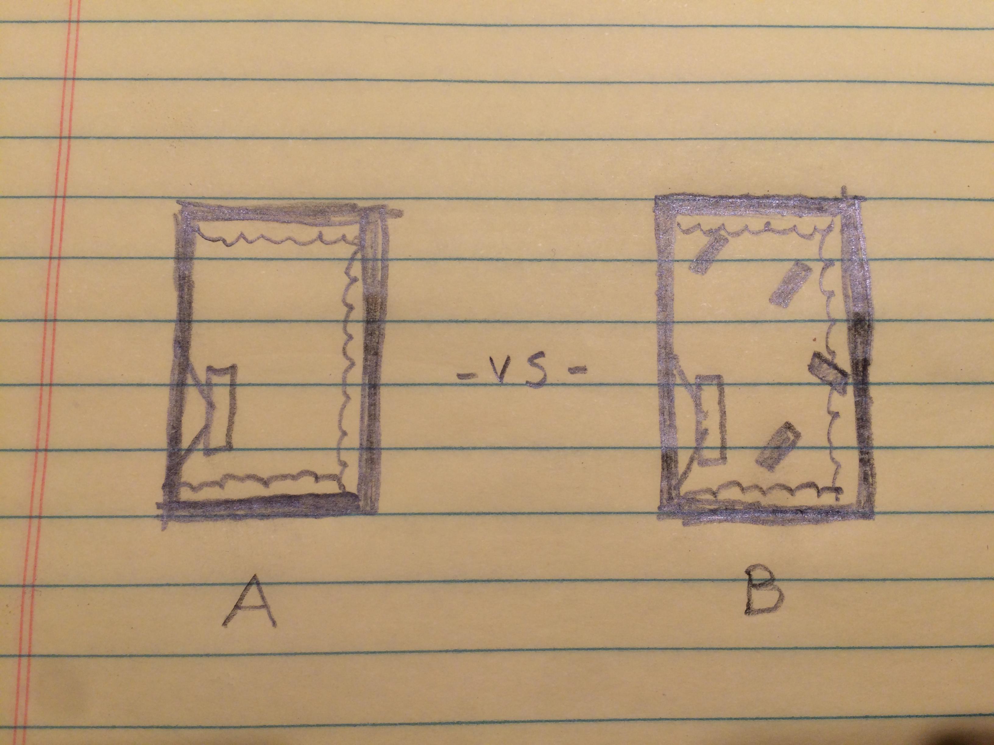

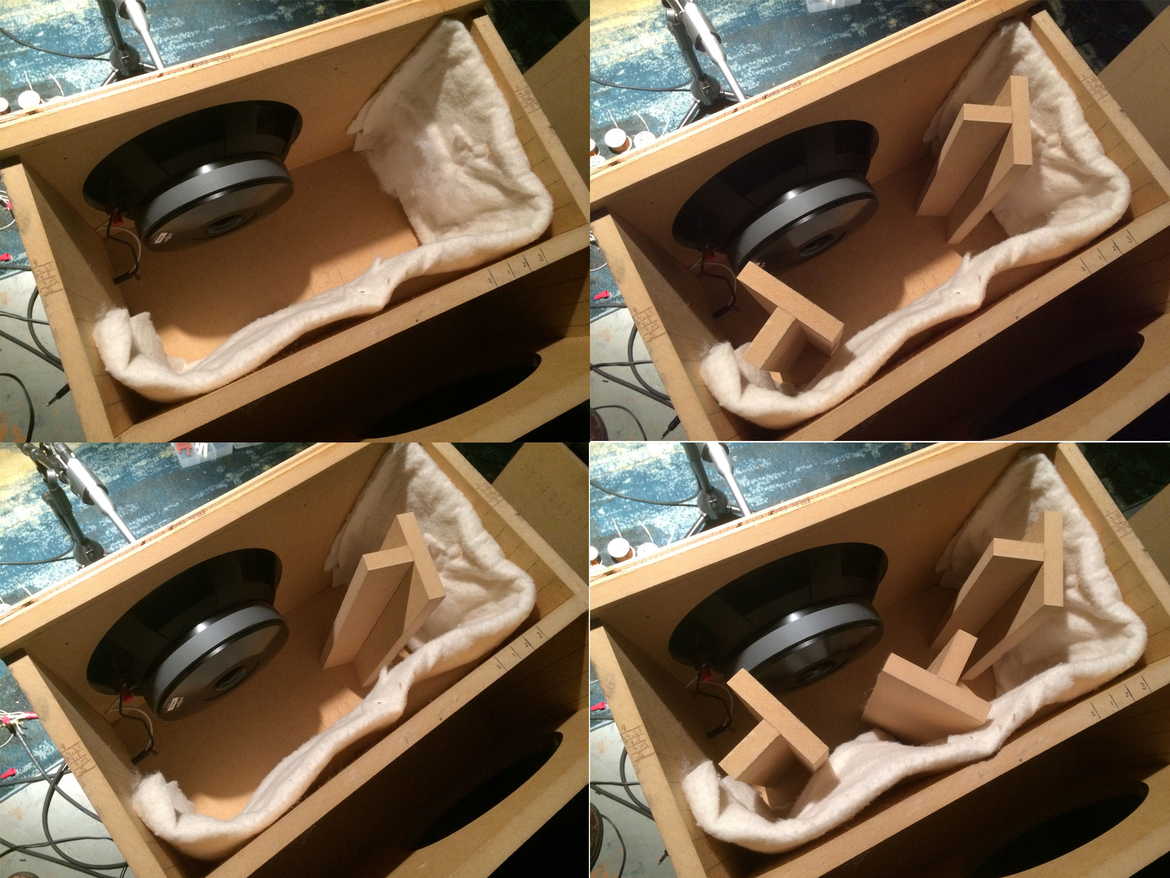

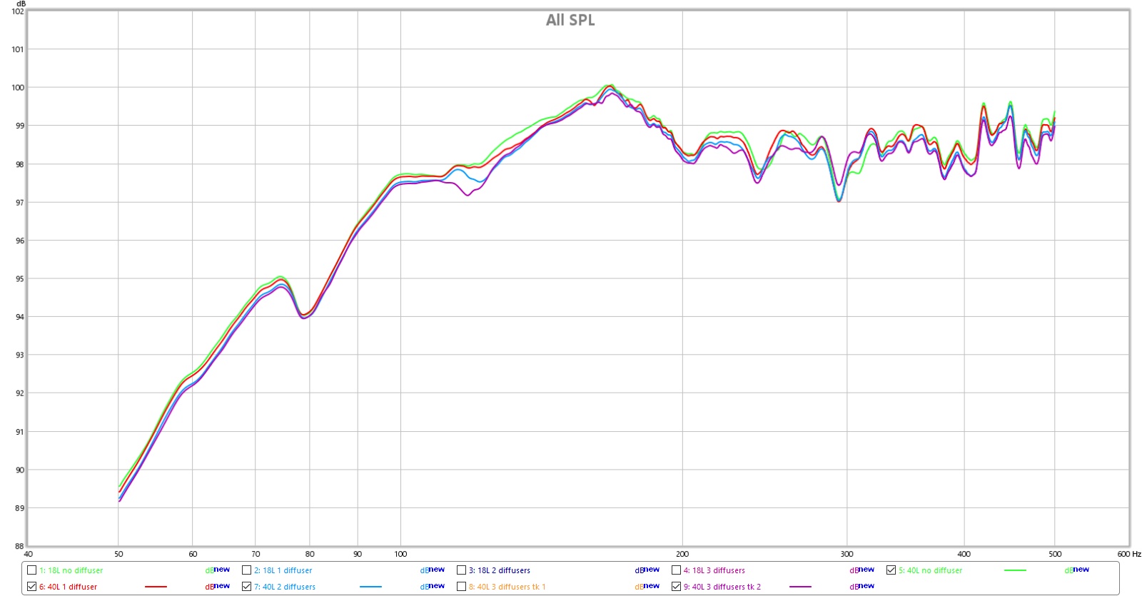

Side joke: don’t we think in waves? ... Any is still better than none right? The box that got me thinking about this is 18L. And the frequency doesn’t do what I want it to as much if I stuff it more than a little padding on the walls. So I’m thinking maybe diffusing is a good precaution just not a lot of room. Or perhaps at that size it’s not so important?

Cool stuff... developed for submarines. Thinking a little more on this. I want to improve as much as I can the + 200hz and diminish as much as I can below 100 in this box. The thought of the sound in the box leaking out thru the driver and walls makes sense that when I stuff it full the plus 100 goes down and sub 100 goes deeper. Adding the “fake larger cubic space” (Close mic’d). So I think my goal is to keep the curve but do what I can to make sure resonates and/or standing waves are as smooth as poss. Not necessarily deaden. That brings up another question. If I’m using a semi live box to eq. The curve am I creating a problem? I know I always... or is this how speakers are designed?

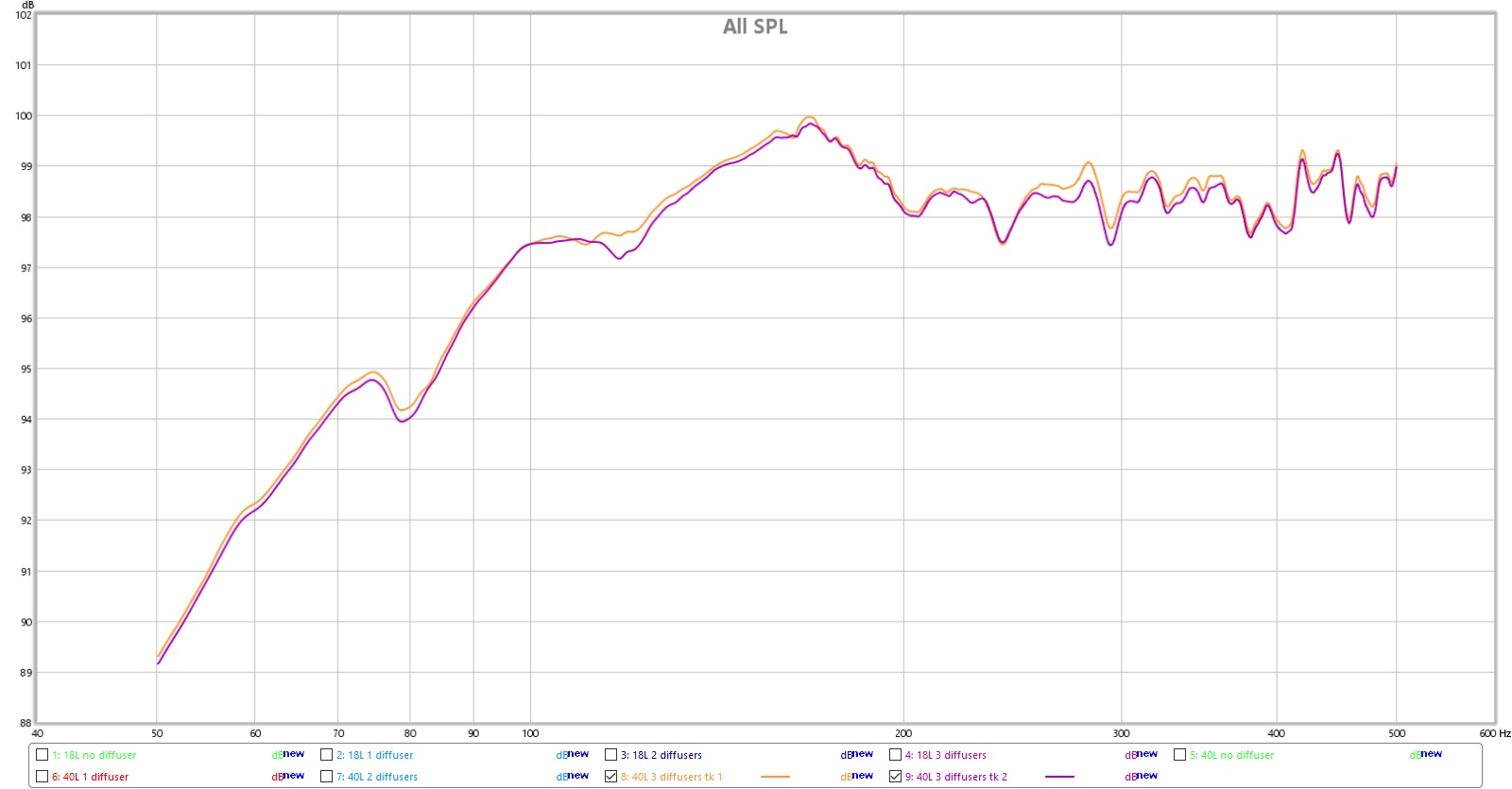

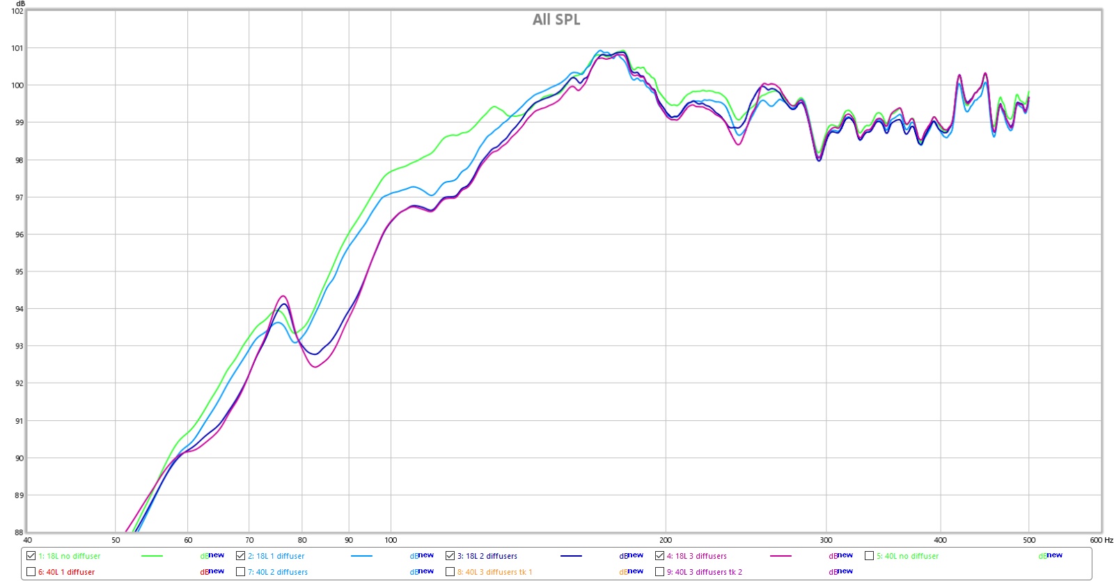

I did a little testing. Looks like the smaller the box the bigger the impact. The small box is 18L and the big is 40.3L The image with 2 curves are at 40.3L with 3 diffusers each measurement but in different locations.
- 100-400 hz in the box, more diffused the better?
