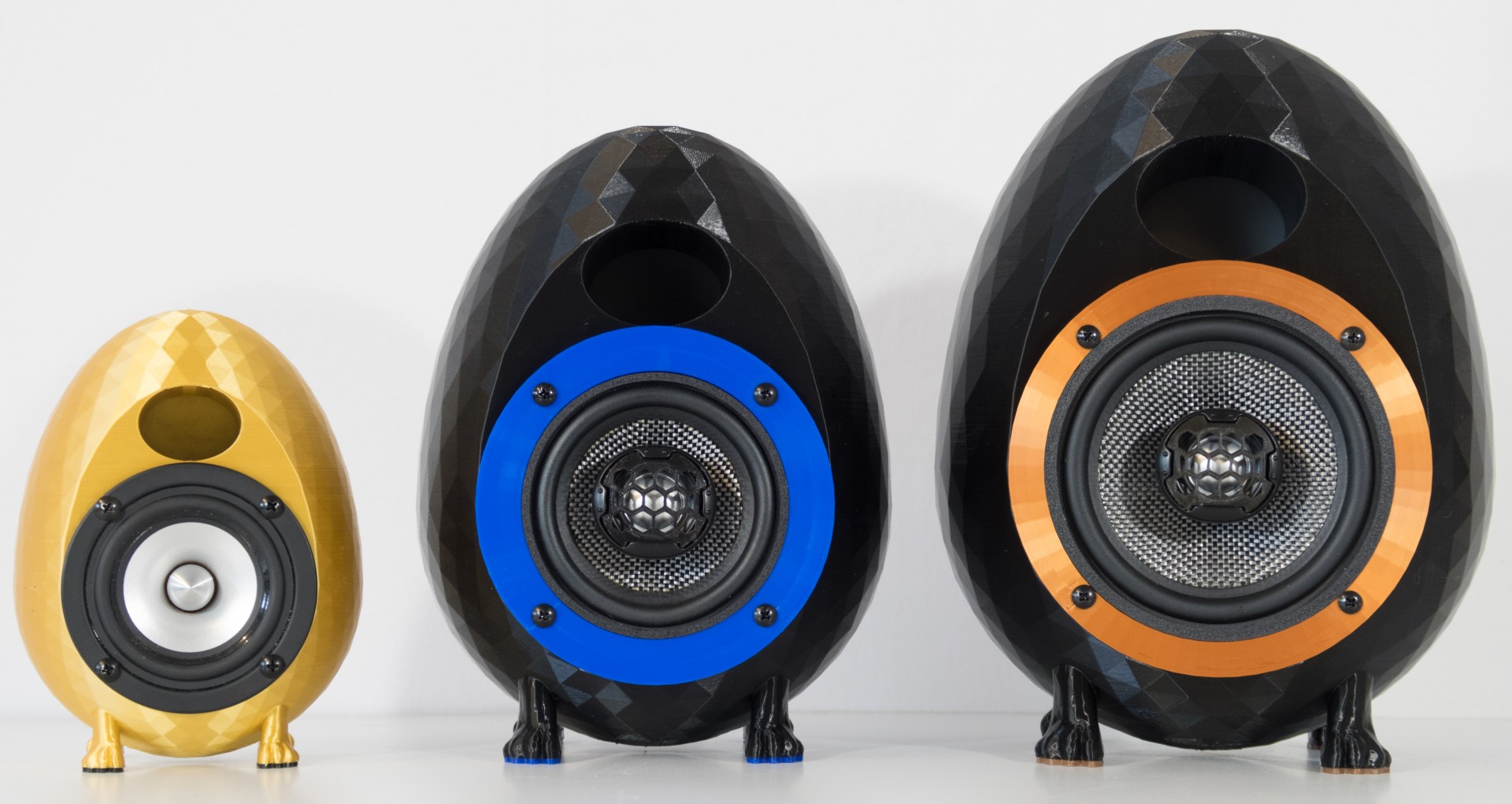

i made these the last 2 years and can say they sound better then ALL other wood cabinets i made (also hard to make an egg shape without CNC)
EDIT: Also on Make: Magazine
3D Printed Egg Speakers | Make:
Also gives you soooo many options, right now im doing a transparent version with 72 ws2812b leds inside, like this very early 3" version in the video (crappy phone with "noise" canceling), but much cool as all diodes goes all around on the inside

They take it to the next level when you want your room filled with light/color with the sound, amazing still how insane the 4" alone is in good cabinets, did plastic before 3D print many years ago in cabinets from B&O 2802 (OLD crt tv with ok sound from the factory vs other TV's back in the 90').
Never discredit plastic, no matter what material you use it is how it is used that counts, the 3D printed speakers gain something others don't with the dual Walls + infill, this gives the effect of keeping resonance away from the outside wall, still the best cabinets i have made to date with 25+ years of building pretty much every kind.
+ last great thing, the weight!!!, one thing is the sound, another is it coming from such light cabinets (4" is about 700-800g in plastic).
