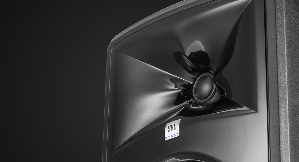

Here's what's going on, IMHO:
An OS waveguide looks like this. On the upside, it has very good polar response and it sounds great. On the downside, it requires a high crossover frequency. This is because the depth of the waveguide is so shallow. For instance, this waveguide is about 3" deep. That means that it will "load" the compression driver down to 1125Hz. (speed of sound / depth / 4)
1125Hz probably doesn't sound too bad, but keep in mind that we generally need the waveguide to "load" the compression driver to at least half an octave below the crossover point.
The JBL M2 has a crossover of 700Hz iirc, so we'd want the waveguide to "load" the compression driver down to about 500Hz, which necessitates a depth of about 6.75".
This means that if the JBL M2 uses an OS waveguide instead of an Image Control Waveguide, the M2's waveguide would need to be about 22.5" in diameter! (Because the OS waveguide is inherently a shallow waveguide.)
So the obvious solution, when engineers wanted a wide beamwidth and ALSO loading the compression driver, was a diffraction slot. These ElectroVoice horns are an example of that. The diffraction slot gives you the "loading" you need for a low crossover, and then the waveguide that follows the diffraction slot gives you the wide coverage you're looking for.
The downside of diffraction horns are:
3) they're still deep
2) the high compression can create distortion
1) the diffraction slot creates diffraction
You can see this phenomenon in the JBL designs from the 80s - they had very good polar response but nobody wants them because they're known to sound bad, subjectively.
So that brings us to the modern JBL waveguides. They're still diffraction horns. There's a diffraction slot in there, but the slot is arranged diagonally.
Putting the diffraction slot on the diagonal axis may reduce the issues with diffraction slots, but someone will need to do some actual measurements to confirm. The fundamental idea is the same: the beamwidth is wide, because the waveguide attached to the diffraction slot is wide. And the diffraction slot is still there. But the two shapes are "blended" together, in an attempt to reduce the diffraction introduced at the end of a conventional diffraction slot. In the Image Control Waveguide, the "end" of the diffraction slot is nebulous, because the "end" varies depending on angle.

Looked also at JBL's design for the 3 series like the 308.
I was wondering whether the WG was just made to look like the one in the M2 or whether it actualy gives some of the benefits you are describing, or whether you could get the same perfromance for a OC WG og the same size?
No doubt it looks cool, and looking at measurements it seems to deliver.
I guess introducing diffraction into the mix no matter what will not make it sound better, but can make it have better directionality properties in a smaller packet.
