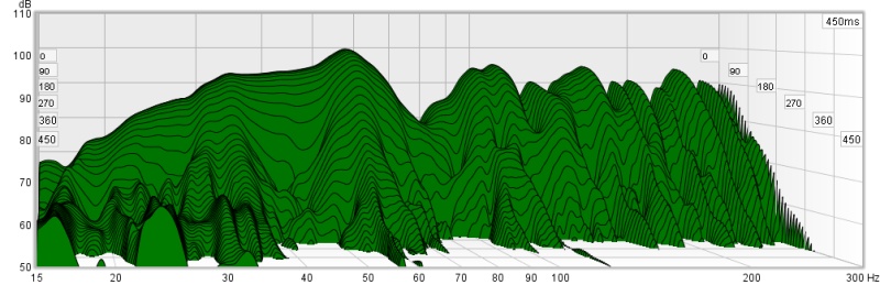

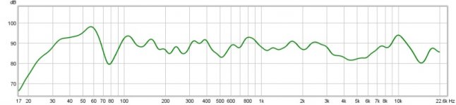

I'm not going to say that I measured properly, but I measured.
And I measured. And I shifted the speakers then measured again. And again.
My mic is properly calibrated from Cross Spectrum, but I don't have a boom mic so had to set it on a tripod on the couch. It was above the top of the rear cushions, exactly where my ear is when listening, but I realize it isn't ideal.
Anyway, the upper frequency results varied quite a bit depending on subtle tweaks. My guess is most of that is bad mic set up. The big bump at 60hz and trough at 80hz, however, were consistent. They are also quite audible, especially when playing music featuring double (stand-up) bass. Lots of resonance. I tried to test treat the nearby corner with couch cushions. It helped the 80hz trough, though not by much, and didn't touch the 60hz bump.
Any thoughts?

Certainly room issues. 8 ft ceiling?
dave
Yup.
8'2", actually, but...yeah.
The room is 22' x 10'. I listen across the short axis. My position is about 7 feet from the side wall.
I doubt that stacked couch cushions (6' high, 1' thick) are ideal for low-frequency dampening, but I would have thought that they'd help more than they did. The lack of significant impact suggests that it isn't the corner so much as the room in general.
I'm glad I didn't go for that MTM we first discussed, with two 12pw. They would have resonated my house to pieces.
I'm also glad that I had as many hours on the 12pw as I did, because I almost blew them out of the cabinets the first time I measured. WAY too much current. No nasty noises then, or now, so I may have gotten away with it. Whew!
