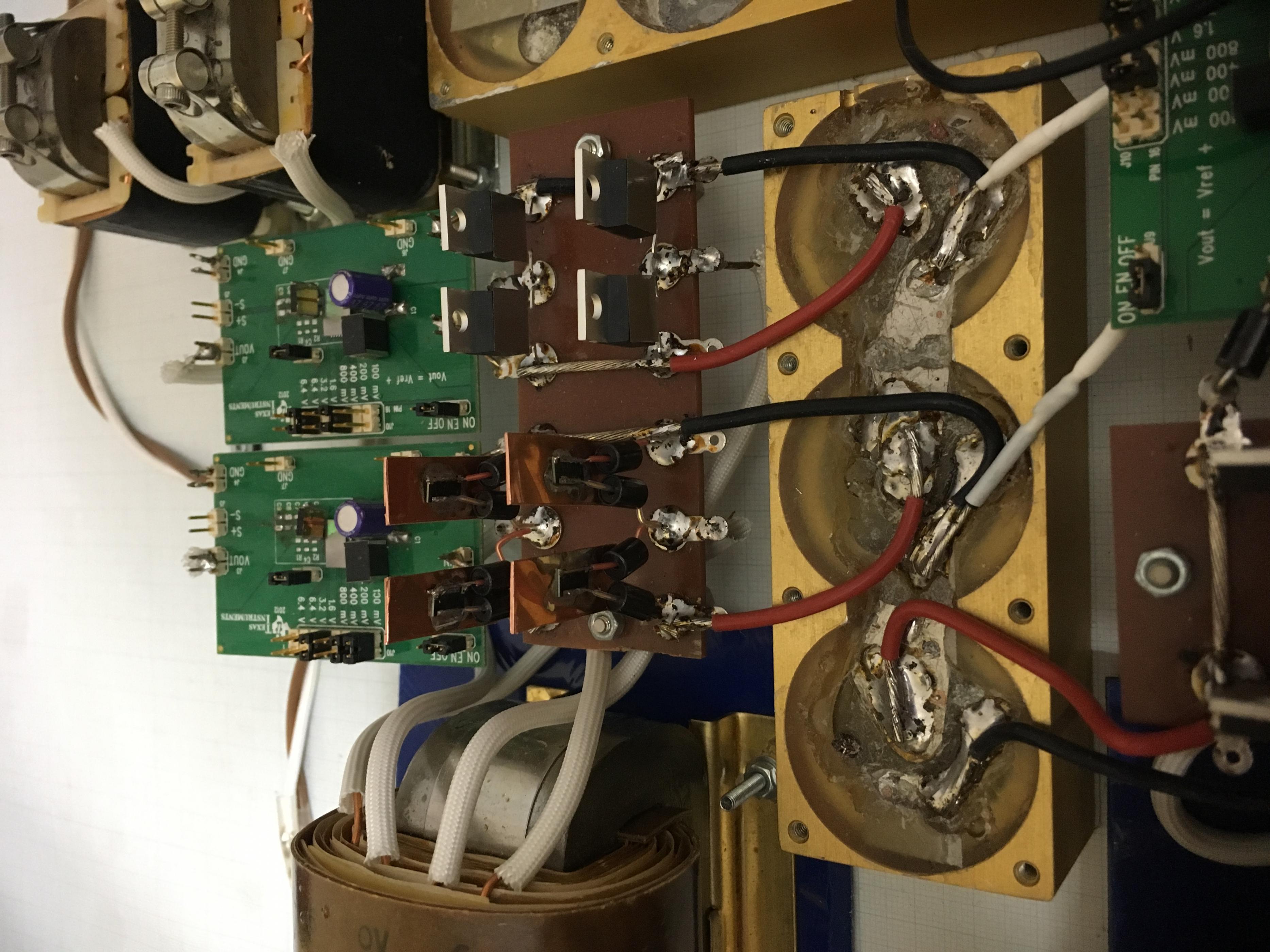

Bunpei immediately purchased GS61008T, which has a thermal pad on its top , and followed Kazuo's approach. Bunpei applied the rectifiers to PSU of full-wave rectification with both 4 diodes type and 2 diodes type. Those PSUs are used for Chiaki's SDTrans384 SD memory card transport, ES9038PRO Dual Mono DAC and NDK DuCULoN OCXO master clock generator.
Bunpei's impressions for the new GaN rectifiers were very similar to those given by Kazuo. Both of them felt something very new and remarkable in the improvement of resultant sound quality. "It's a kind of quantum leap!"

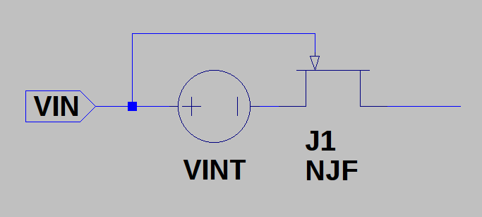

Going off the wall if you tie gate to source and then reverse bias the device what happens internally when it is conducting in the reverse mode?
Second Picture is a poor representation of what might be happening internally.
VINT is a voltage drop across the internal Source with the Gate tied to the package source. With Zero volts external the internal drop is negative with respect to the Gate and.... the device turns on.
The above might be rubbish but in terms of how it sounds...

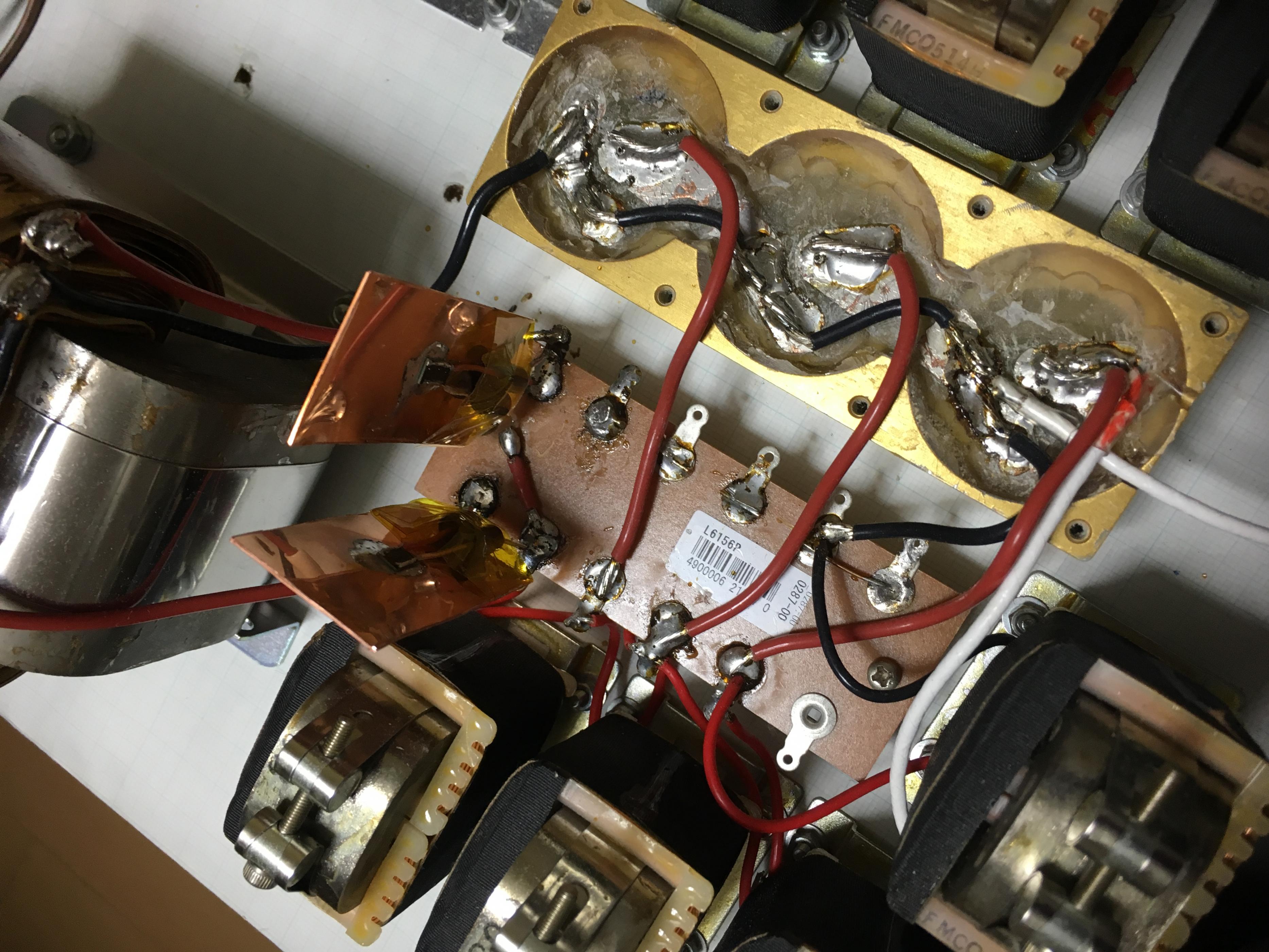

The second pictue shows four GaN Transistors are used for 4-diode rectifier (bridge) configuration in the left side part. The right side part shows a conventional SiC diode set with Infineon Gen6 products.

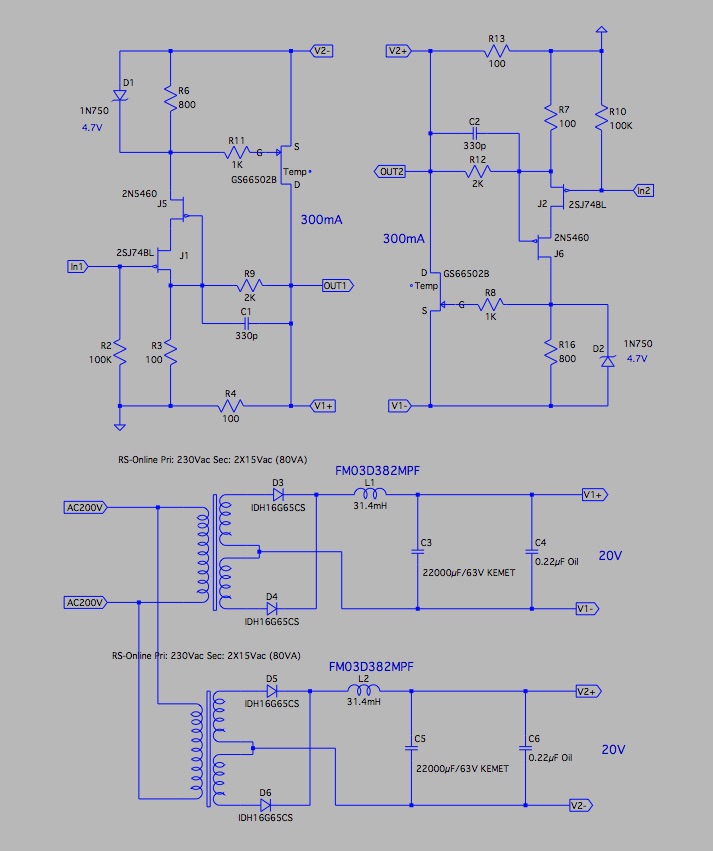

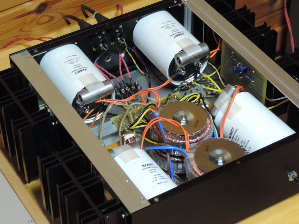

As Bunpei precisely reports, my first interest for GaN started from the study of Taylor Follower type Regulator. When I replaced MTP3055VL with GS66502B for
shunt on the regulator, I found great improvement. Then I decided to apply this GaN to Power amplifier particularly the Amazing Circlotron.
In reference to Amazing Circlotron I made one modification which is adding cascode to the first stage. (1st picture)

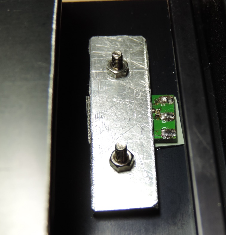

On 2nd picture shows you how to implement GaN on a heat sink, Gan is beneath a small aluminum panel.
Also, you can see the modified Amazing Circlotron which I made on 3rd picture.
The sound of this amp made excites me. I used to use some bipolar transistors, MOSFETs, and tubes for final stage until then, I guess GaN is best of all and have no need to choose other items anymore IMO.

First one is the green board of GaN is too small to satisfy maximum consumption of heat. Then I made the board made of aluminum substrate (4th picture).
The second one is to change rectifiers to GaNs which I use Infineon G5 SiC diodes now.
Until this late spring, I will report next modified amp with GaN.

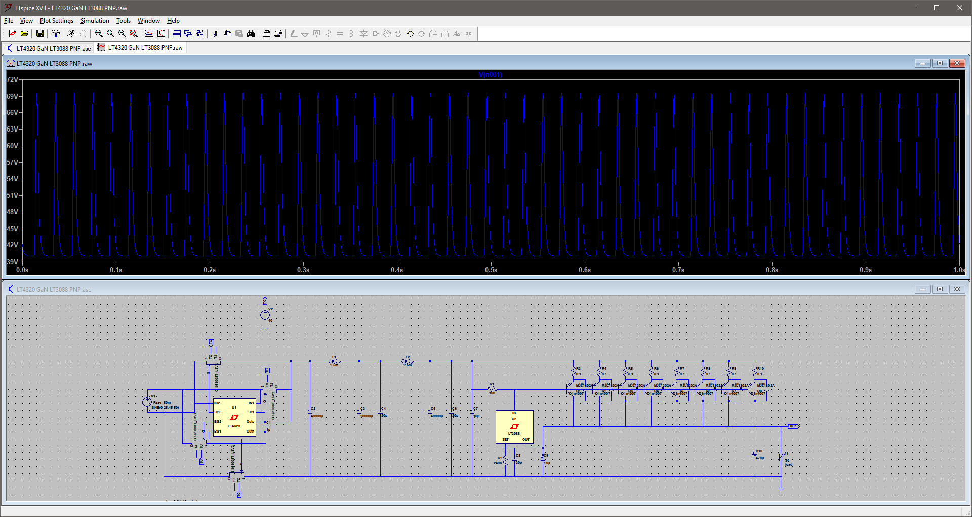

LT4320+GS61008T: Ideal Diode Bridge Approach
The GaN E mode transistor, GS61008T is a normally-OFF type.
Some of you may remember an "Ideal Diode Bridge" and a driver IC for that purpose.
A Japanese blogger of this page (in Japanese),
LT4320+GS61008T(GaN)_LTspice: アナログ回路のおもちゃ箱
kindly performed a LTspice simulation for a combination of LT4320 and GS61008T, presenting such a result that;
"LT4320 is supposed to be able to drive GS61008T."
I think we can expect a better efficiency by using this configuration.

Great one. I have done the same simulation in LTSpice before I see this article and should work fine, with much less heat generated against using GaN transistors as diode by binding G and S.
Ordered some GS61008T from Mouser and will test later.
