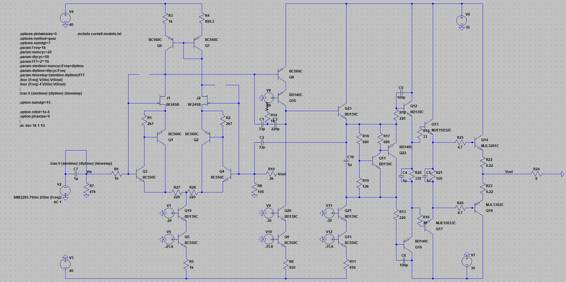

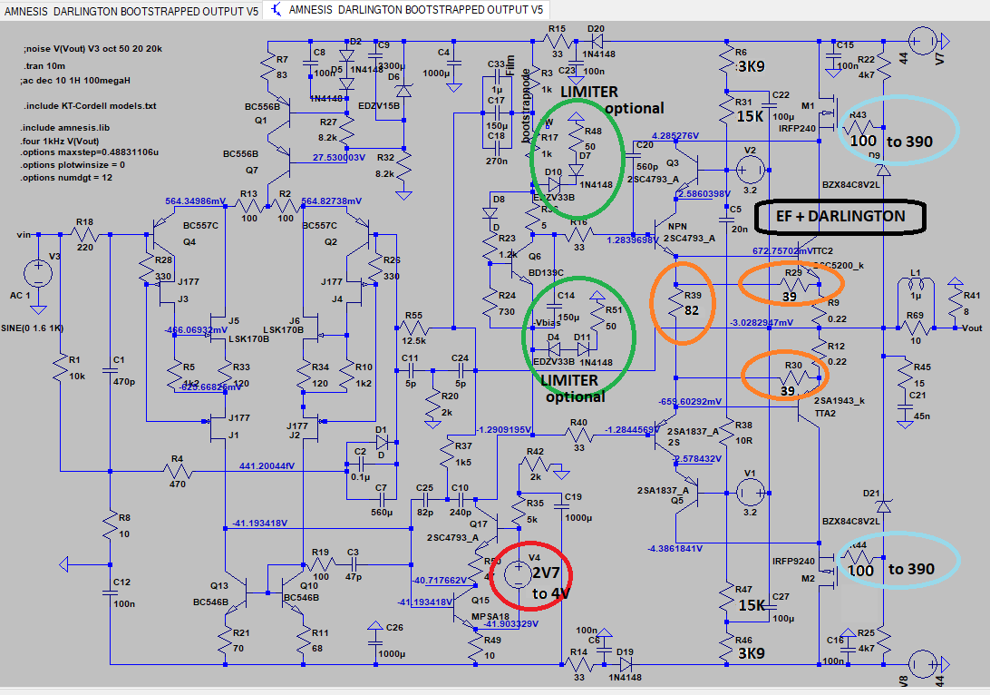

Edit: just at the Lions Gate of 2022 I found the best output configuration. Check out post
#806 (I attached the diagram down here) for the latest official Bootstrapped Darlington output configuration.
Edit: it also runs very well with VFETs as bootstrap element for the outputs.

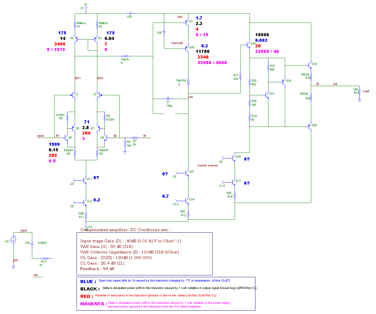

I am proposed to implement the mods that Peufeu studied for diminishing putative thermal memory distortion effects on solid state amplifiers, but adding my own experiments on the output section, which Peufeu did not (unless I am not aware of that) address. In fact, I began my research modifying the outputs (Cascode all thy outputs), that is why Peufeu's articles were so interesting to me. I took the liberty to re-post the proposed amp from Peufeu. (it may have a minor error on the cascoded CFP like my experiment proved)
I have no electronic background; only the experience and scarce knowledge I obtained here, so be patient.
The blameless amp is the prototype to modify and since I have a Blame ST from Destroyer X, the idea is modify it section by section as Peufeu proposed and evaluate if there is any improvement in sound to be achieved.

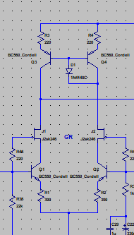

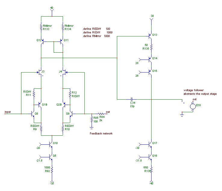

I already swapped differential amplifier BJTs (Q1 and Q2) for cascoded CFP (J103 P channel JFET cascodying BC556-BC546 Sziklai pair) and it worked. Current is 2,09mA by side, though one may have to trim mirror resistor R8 to achieve 0 offset.
The sound, and this confirms Peufeu's claims, became very smooth and relaxed, with soft highs and more prominent midrange and mid-bass (my test speakers are very bright sounding) very soothing experience...the bad news is that the other channel has a problem that I could not solve yet: -27V at drivers bases, without oscillation :( But, hey! That is the way we learn the most!
I let to the theorists the task of discriminating if this supposed sound improvement comes from increased linearity, from decreased thermal memory or from shared thermal task of units with different thermal behavior...
Time ago I had already tried a mod to the output section that I liked: I cascaded the output BJTs with other BJT power devices (D44H11/D45H11) in common-base. Not properly a cascode, since it is not a common emitter output (even if I CAScaded the COllector :D) apparently, but I perceived an improvement in transparency and dynamics. I have also modded another amp, the VSSA, with this trick and I also noticed a worthwhile improvement. My plan is putting, like on the input section, a cascoded CFP output later. You may notice that, absolute and eternal beginners like yours truly, are willing to try mods that reasonable people would never even think of... :D
Then, I will try the mods to the VAS circuit (cascoded-cascoded VAS) that Peufeu recommends.

Anyway, now I'm stuck with one of the amps. See, the first board accepted the mod luckily without problem: the VAS is asking for 5mA and I was able to set offset to mV unit level...and it sounds great.
The other board though, maybe because of a little error in the original cascoded CFP diagram (it must be 1K between second BJT (NPN) emitter's and CFP output node) the amp keeps behaving strangely, with high negative bias voltage for the drivers. The VAS apparently is asking 25mA to the passive CCS and that collapses the positive voltage available, or that is what I understand, even when I use single transistor VAS, but I am not sure where that current is going...I couldn't detect any damaged units nor oscillation. I replaced most active devices anyway. If I cannot make it work, I will try an active CCS. If everything fails, I will have to build a new board... :(

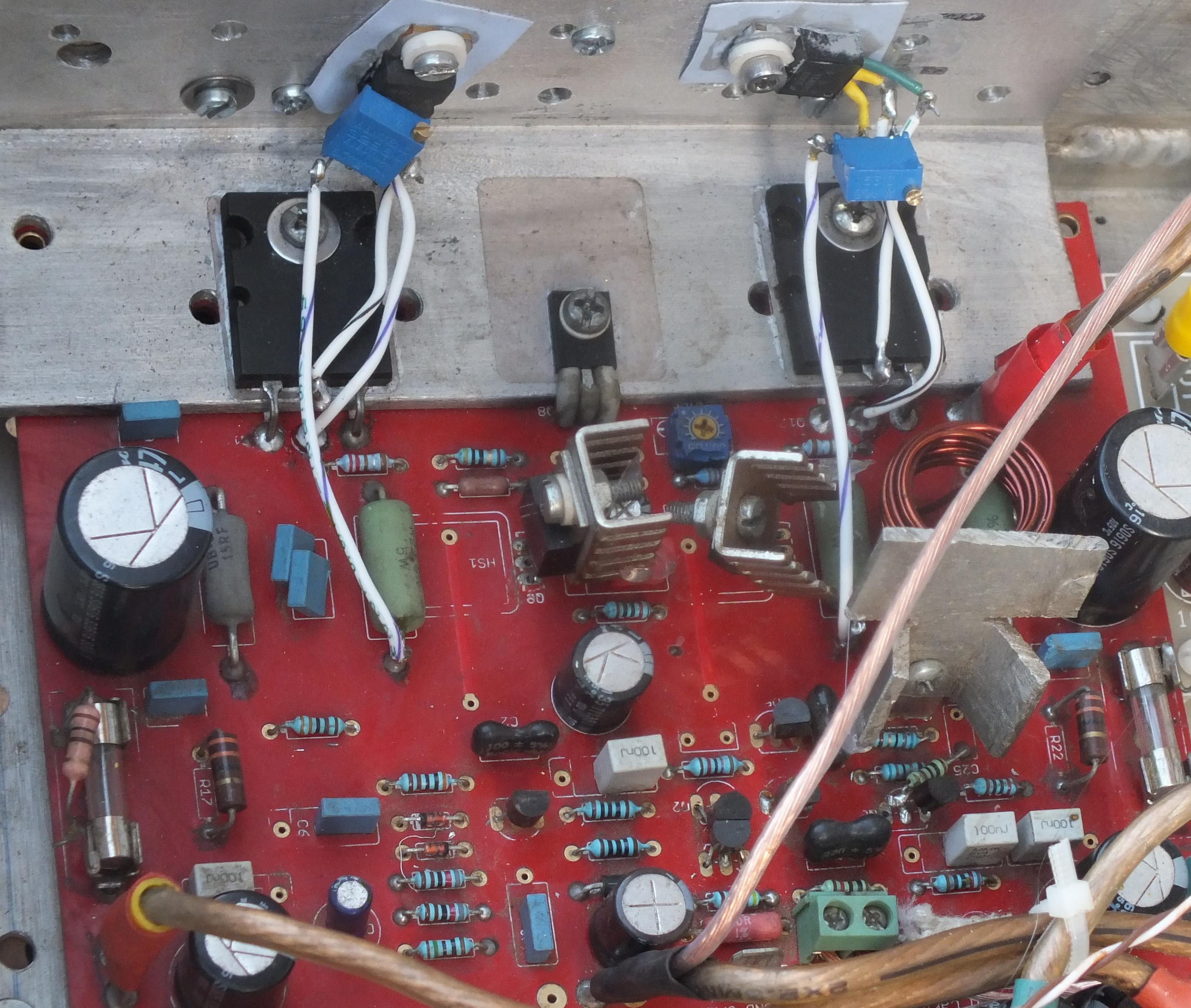

Finally, your favorite eternal beginner and humble narrator has succeeded. :cool:
It was hard. Like "awakening the Dragon"...
The faulty amp, believe it or not, had the 100V bootstrap cap damaged! Or so it appears...My cap tester kaput (kids, discharge caps before testing) so I cannot confirm leakage but replacing it for a good one made the amp work flawlessly...and I seem to remember Rod Elliot, perhaps (great site) mentioning something about that those caps never fail...or was it my imagination?
I had the chance of a short listening test in stereo until the other amp kaput!
I now always think that these catastrophic events are a blessing in disguise because we learn so much during the trouble-shooting. :D :redhot:
I replaced the corresponding bootstrap cap thinking that the was the fault and it ended being a PNP driver gone.
While I was there I couldn't help thinking that using a big cap in the signal chain must not be good for memory, right? So, apart thinking about running a version without the said cap, I started looking for information about current source plus bootstrap. I stumbled across a very interesting thread about CCS-bootstrap by Dadod, which I am now reading. Must be a worthwhile experiment. He also used the Blame as model.
Please bear in mind that I am not proceeding in a strict scientific way to evaluate my mods: I simply try them and decide, from memory (hehe) if I like it or not. I have not the time to build another pair of amps and do the ABA test for each mod, so you are warned.
So when trying to fix the amp, I decided to make the simple cascoded VAS mod and it worked. I think the cascoded VAS gives the more velvety midrange so now I have it in stereo. One VAS asks for 12,7mA and the other asks for 10,8mA. Offset is steady around 10mV. Voltages for the bases of the outputs are +/-550mV and amps run cool.

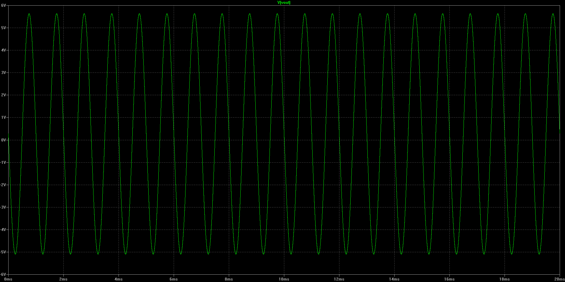

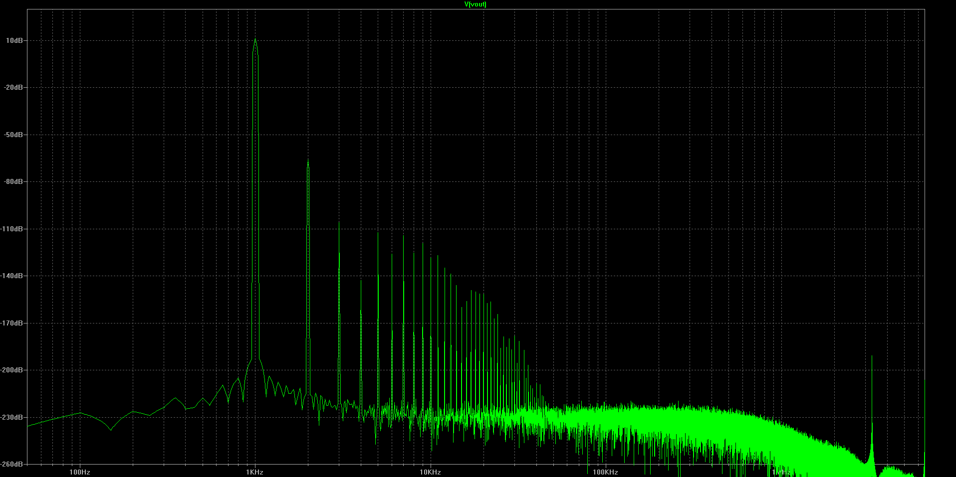

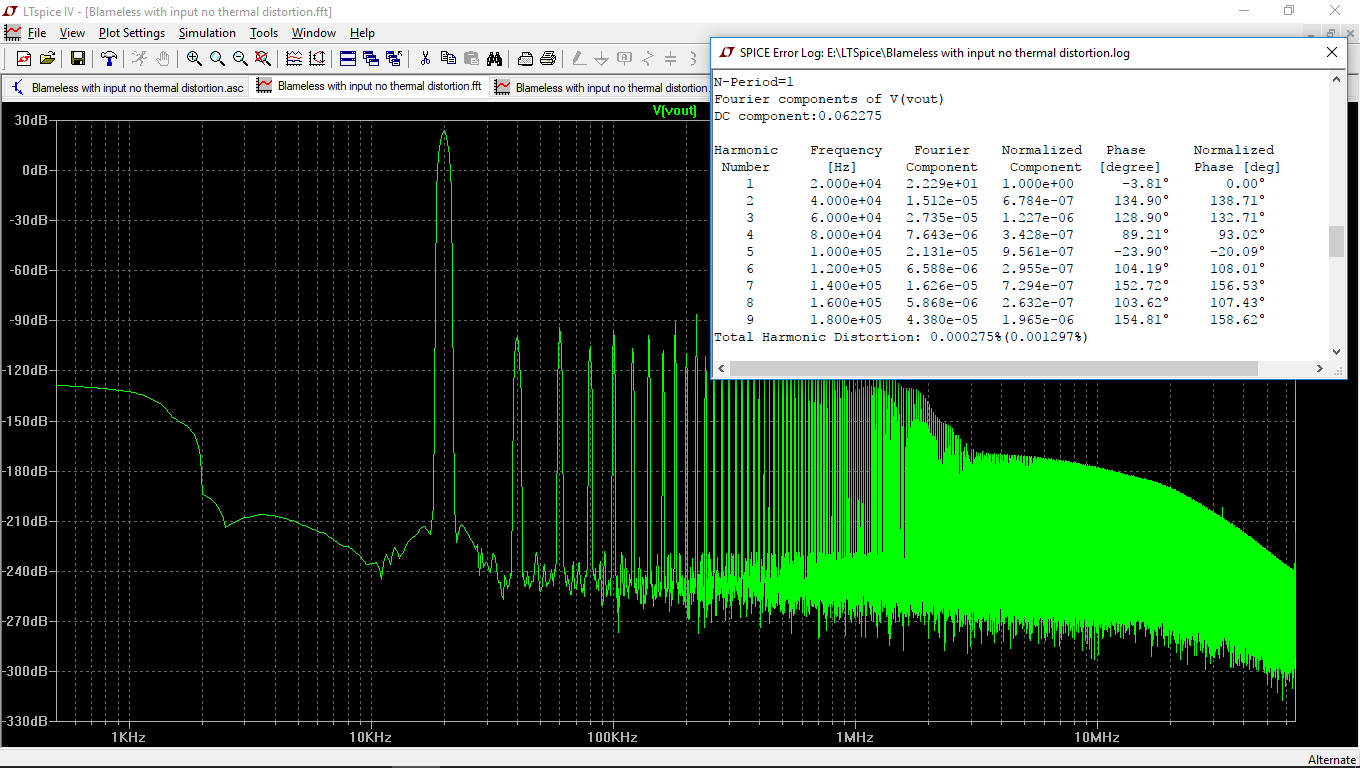

I use same input but simple (no CFP).
I get THD = 0.000275% at 31W/8Ohm, 20kHz.
If I uses CFP, THD20 rise but THD1 fall.

Bimo, are you sure you need that resistor to JFET gate?
Did you tried or just simulated cascoded-CFP?
I wish I knew how to use simulators...
Anyway, the mod is simple and transistors are cheap, so why don't try it and see/hear what does it bring?
You only need a pair of PNP and a pair of 1K resistors that go between emitter of the new PNP and source of JFET which is also the output node of Szicklai...or at least I wired that way to get even currents (2.09mA) between legs.
Another easy mod is cascodying the tail. ;) But later as now I will continue my listening tests.
M.

I just simulated it. I do not have time to make a prototype.
I sent my design to a friend, he will make a prototype. But it take a time.

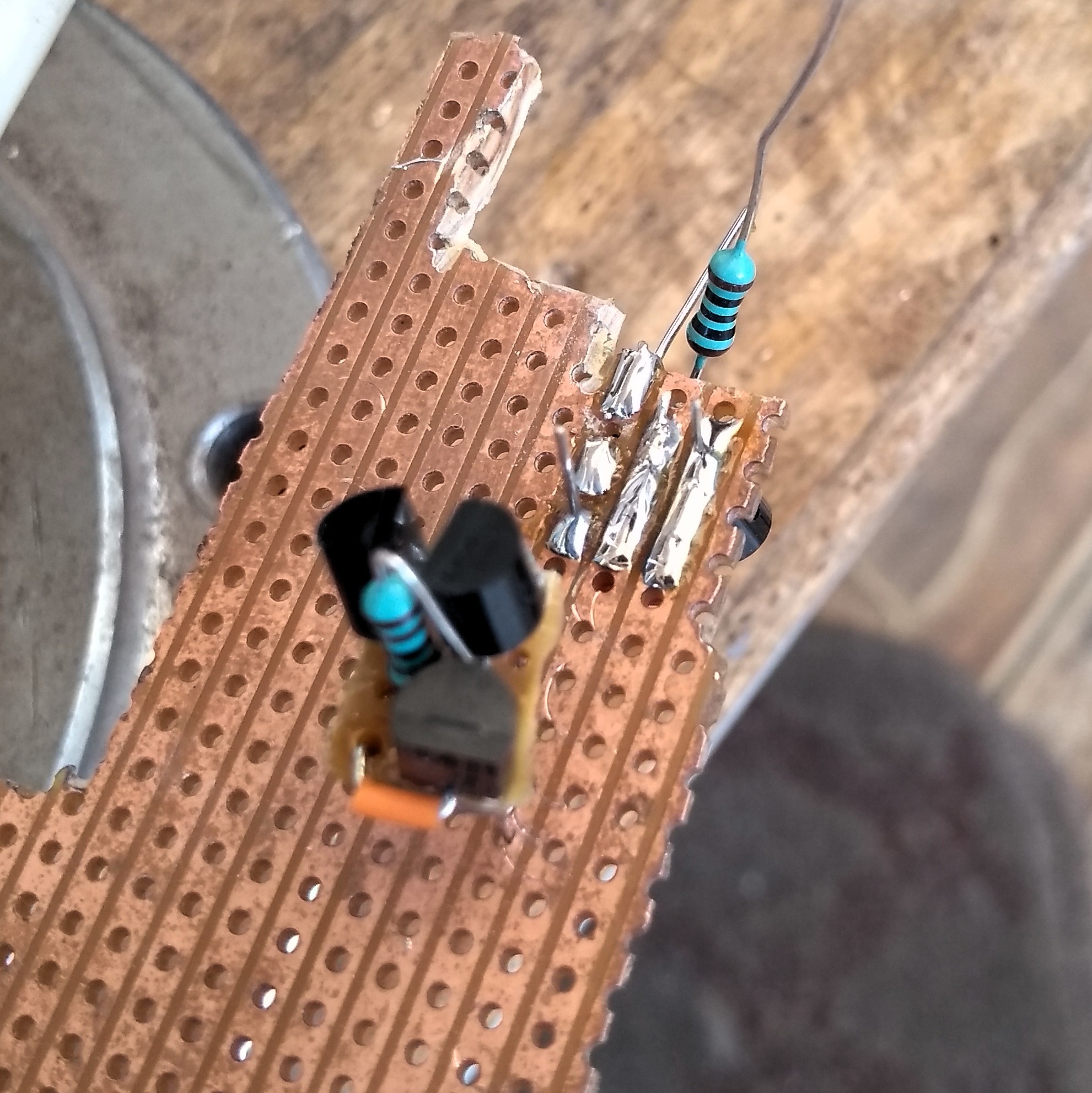

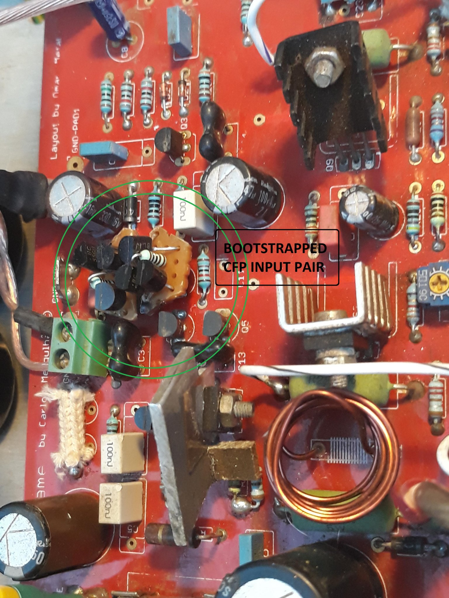

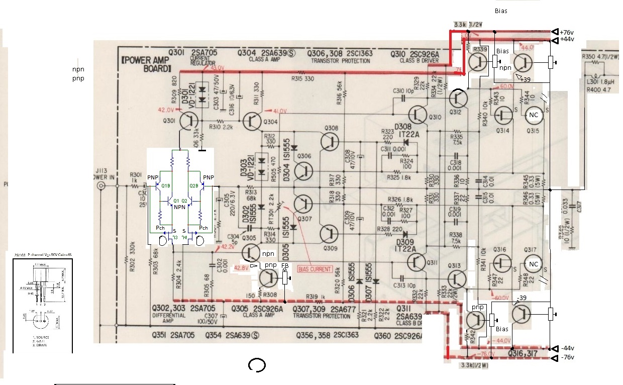

OK. I know have the input section of my Sony TA-5650 properly modified with Peufeu's Cascoded CFP trick. The effect was easily detected as being the same caused on the Blame. Less aggressive highs, more midrange presence (the bodies of the instruments are very pronounced), better delineation of melodic lines, in all, if I knew how to speak Latin, I would say the sound is now rotundum :D
Fortunately, the DC offset was low and I had not to mod the circuit: 10mV and 1,8mV.
It is now decided: I will swap all my differential pairs for the cascoded CFP unit. See attached picture of the units in preparation. I think I reached the limit of reduction. More than this, it would have to be SMD...
I am also studying mixed CFP (JFET + BJT) to replace JFET inputs... :cool:
With a little of effort, the units can be placed in existing space.
Guys. try it. At least for experimentation...remember, all mods must be evaluated not less than 48hrs before verdict. ;)
M.
PS: an "all cascoded-CFP" amp would be interesting...
PS2: I attached the diagram of the mod. The amp has now 100R degeneration on the emitters. The 1K CFP resistor is fitted on the emitter of the NPN BJT instead. This way it worked better.

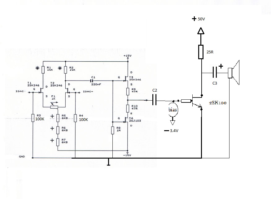

Continuing with the experiments, yesterday I successfully "improved" the differential amplifier input section of my single ended Tokin 2SK180 VFET amp :cool:
Since it has JFET diffamp, I decided to make a "cascoded-compound Sziklai" arrangement. For that I studied some academic articles but they were too much for my limited understanding so I made it the brute force with SK170 N JFET both as the cascodying element and as the "driver" of the Sziklai pair and a BC560 PNP as the "follower" of the same, with a 1K emitter resistance. It worked. And first listening tests are very rewarding. :cool:
Guys, this mod always improve attacks and detail retrieving. Pizziccatti e stacatti, plucking, smashing of the keyboard, or any ambient noise are greatly enhanced, which, summed to the extra wide soundstage, beyond speakers, makes the experience like a "live" event and you keep wandering -is that the recording or the neighbor??? :D
Photo of the small unit and diagram of the target amp.
