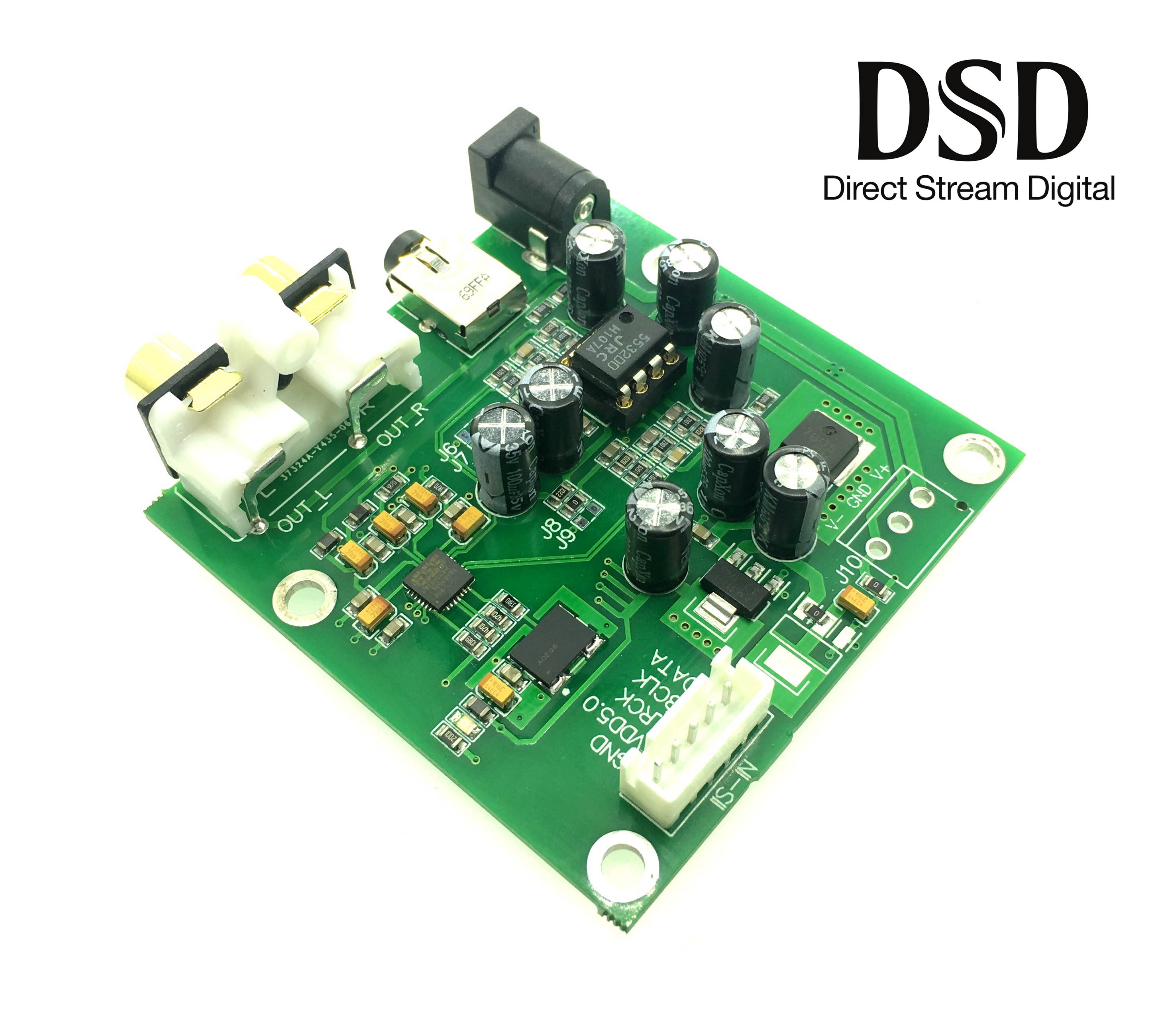

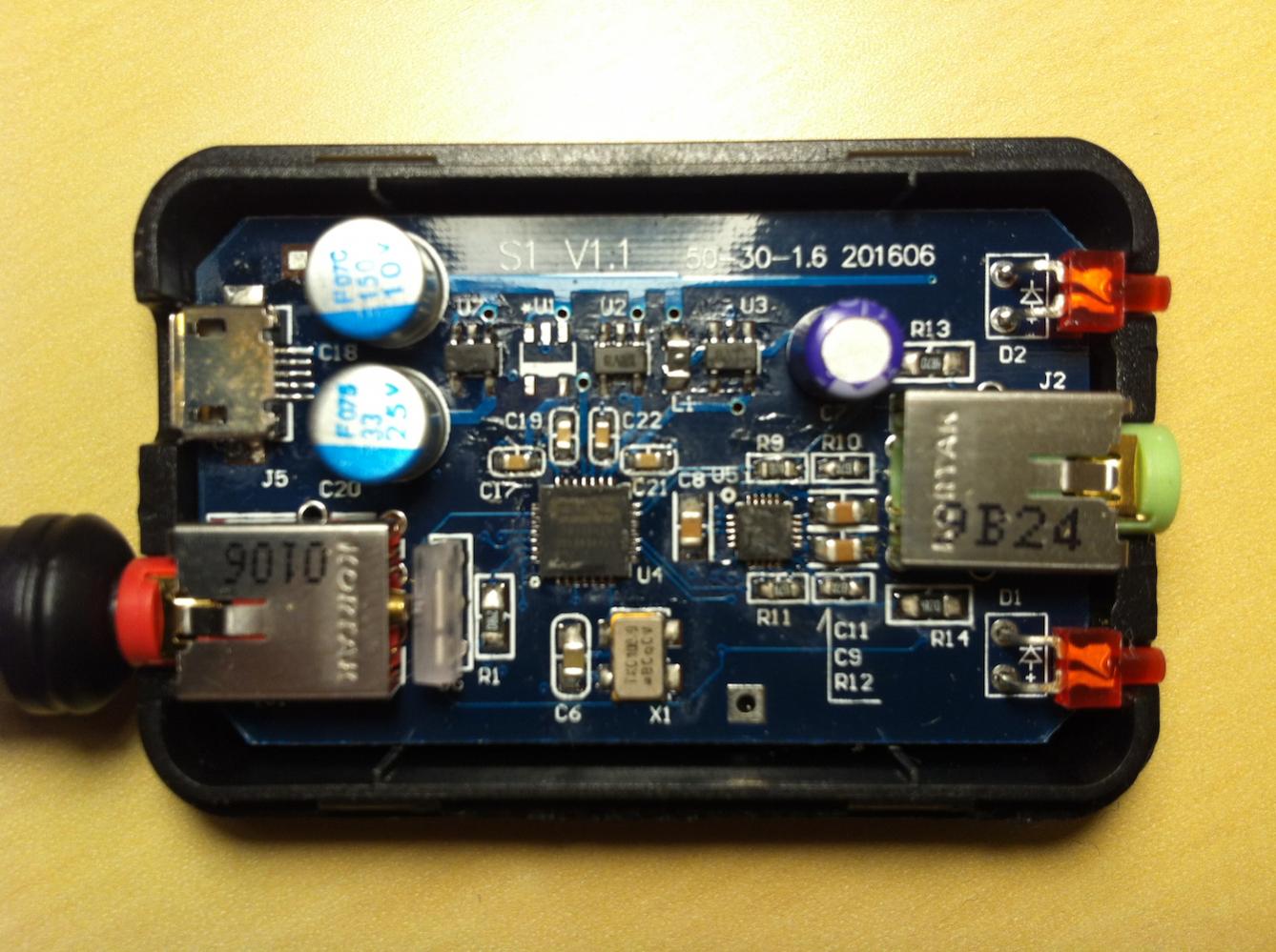

Bought one of these recently:
Hifime SPDIF Optical DAC (ES9018K2M)
I hooked it on a TPS7A4700 Power supply, the Dac is dead silent.
But compared to any other Dac or player I own the 9018DAC misses warmth, i.e presence in the lower mids.
The combination in this DAC with Sabre ES9018k2M and 9601 headphone/line out driver seems to be very common.
Any way to mod this DAC to get back some warmth?

No Ideas? Looks like there is not much to mod. As for the electrolytic apacitors,there is only 2 for the USB input and one between a
regulatorīs Output and the Sabre 9601 lineout/phone driver.
No data available if there is dedicted outputs for each prurpose.
If this highly integrated combo of DAC and preamp really sonnds as thin as it does against several dacs from several generations, Ess Technology did something essentially wrong...
BTW I am not using USB but a low noise power supply.
I would also like to know if the ES9018K2M has also current output (I doubt) to use/test it with a better output stage...?

Well, i tested this DAC with two low noise power supplies,
from Twistedpear (shunt regulated Placid) and from LDOVR.
Setting the source to pause and ramping my amp all way up, there is a hiss.
My Buffalo DAC as well as an old Philips CD-304 are quieter.
Also the datasheets indicate that the ES9018k2k/Sabre9061k should be quieter.
I assume the hiss comes from the voltage regulation and that the first regulatior after the usb input can be omitted.
The ES9018k2m runs on 3.3/1.8V.
But I find no info on which voltage the Sabre9601k runs...?

Yes, and this is why I would like to remove the voltage regulator at the USB input as I can provide clean power to the DAC and Line Out stage, the Sabre9061k.
Markw4 13th October 2018 01:24 AM
Why don't you? You could ring out the connections with a DVM and probably figure it out. If you blow it up, no big loss. It's more or less junk as is, IMHO.
Or, you could sign an NDA with ESS and get data sheets for the parts. Lot of trouble for not much potential gain starting from an ES9018 though, again, IMHO.
It may help to know that Sabre dacs only have one kind of output, it works for voltage mode or current mode depending on how it is loaded.
If interested in modding a Sabre dac knowing you will end up with something quite good, you would certainly be welcome over in the 'ES9038Q2M board' thread. Lot's of modding going on there. Having done some of it myself, there is not always a schematic or other desired information, but often one can still figure out quite a bit. Enough to make significant improvements. Actually, over there we do have a lot of information by this point, but a lot was done in the beginning with with no schematic and no datasheet.
phase 13th October 2018 01:51 AM
The clock needs its own supply also, or at least some ferrite beads in there somewhere to keep the noise at bay if shared with dvdd.
That board needs so much to be sibilant-free and still sound decent, would be easier to just make some simple upgrades, put it back together and find something more mod-worthy.
Keep that one for a backup or test unit.
