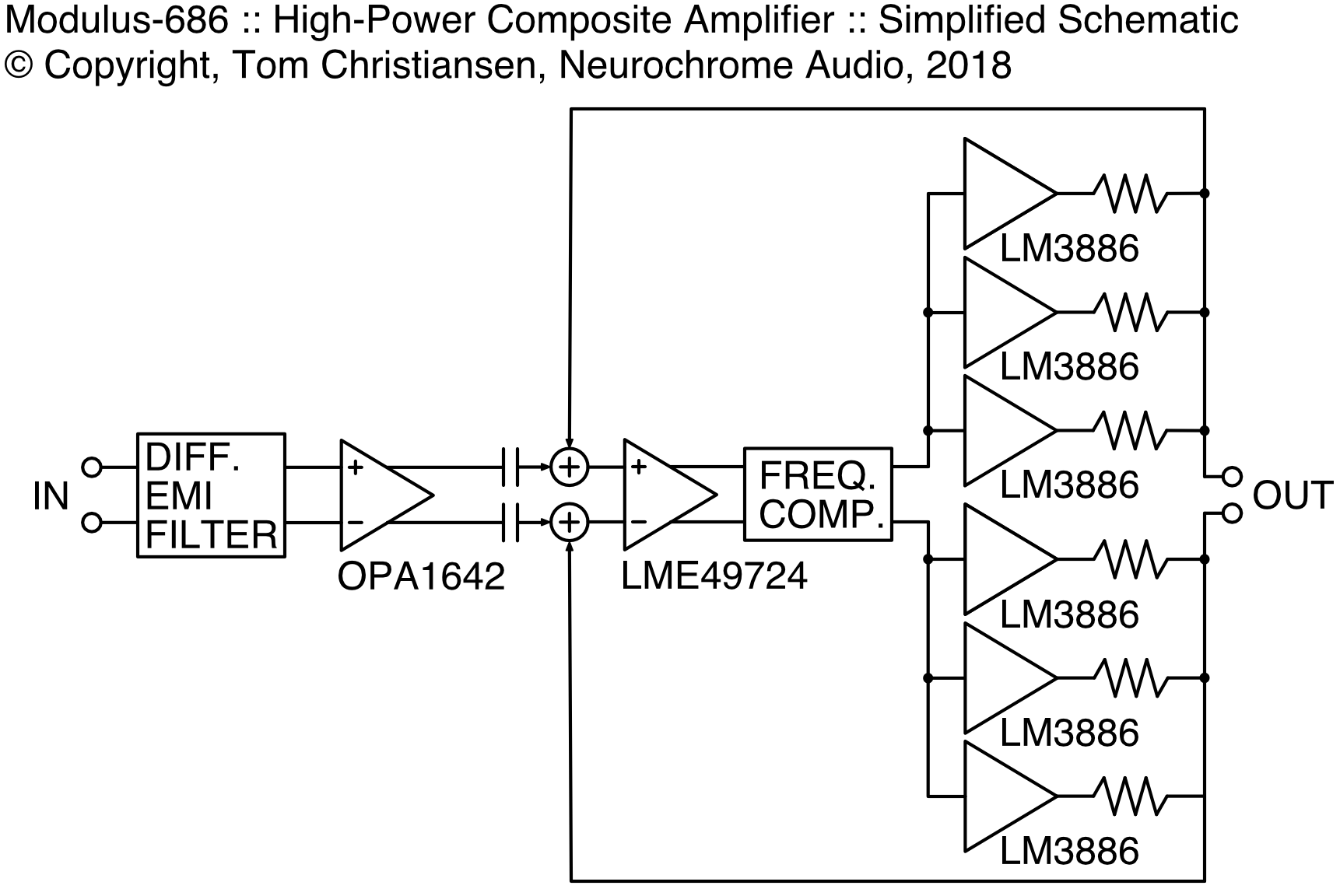

Modulus-686: 380W (4Ω); 220W (8Ω) Balanced Composite Power Amp with extremely low THD
The Modulus-686 is a balanced composite bridge/parallel amplifier. It uses six LM3886 amplifier ICs to provide nearly 400 W into 4 ohm loads at vanishingly low distortion. With a typical output current capability of 33 A, the Modulus-686 easily drives even the most challenging loads, including loads with impedance dips into the 2 ohm range.

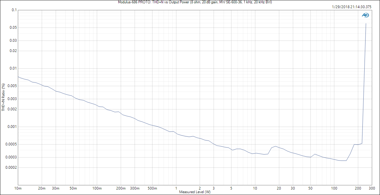

- Ultra-low 0.00026 % THD+N (140 W, 8 ohm, 1 kHz).

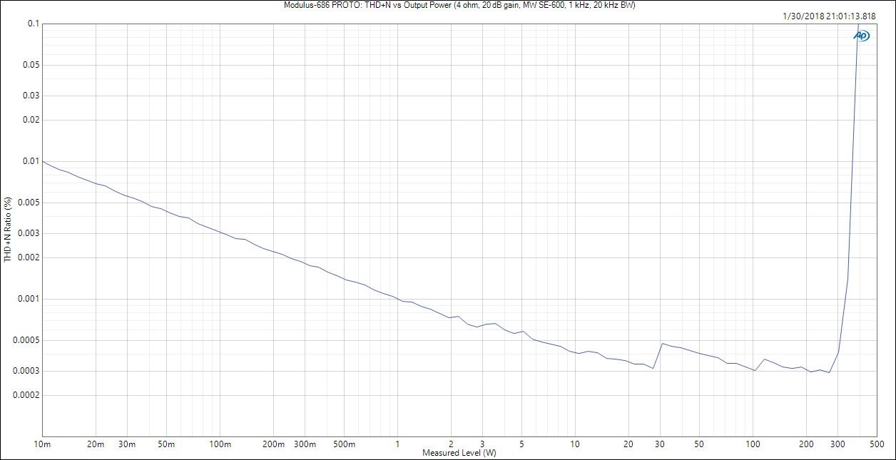

- Ultra-low 0.00029 % THD+N (260 W, 4 ohm, 1 kHz).

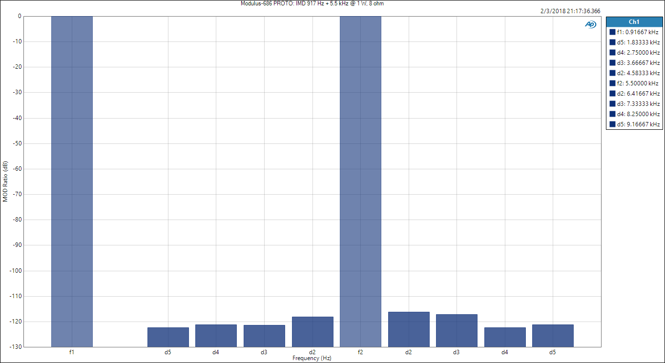

- 1 kHz + 5.5 kHz IMD <-110 dBc @ 1 W.

Modulus-686 PROTO_ THD+N vs Output Power (8 ohm, 20 dB gain, MW SE-600-36, 1 kHz, 20 kHz BW).png50.8 KB · Views: 8,851
Modulus-686 PROTO_ THD+N vs Output Power (4 ohm, 20 dB gain, MW SE-600-36, 1 kHz, 20 kHz BW).png50.9 KB · Views: 8,442
Modulus-686 PROTO_ IMD 917 Hz + 5.5 kHz @ 1 W, 8 ohm.png39.6 KB · Views: 8,342

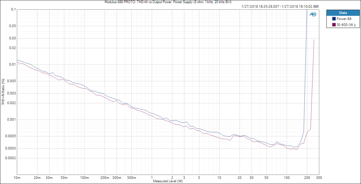

Modulus-686 PROTO_ THD+N vs Output Power, Power Supply (8 ohm, 1 kHz, 20 kHz BW).png53.9 KB · Views: 8,600

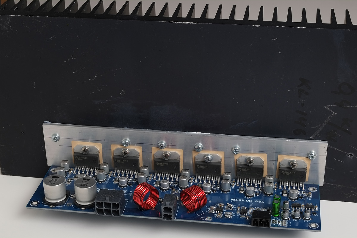

closer look seems to show only two caps, 6 chips, 2 inductors and 3 connectors are through hole. So it makes sense to just get the boards fully assembled. Just wondering though, lead free solder I suppose?Tom, what components are surface mounted? Cap? Resistors?

When reusing my Pwr86 supply, do I need bigger caps?
Nope. My measurement was done with the stock Power-86 and an Antek AN-5225 transformer.
You'll need a large heat sink for the MOD686. My test heat sink is 0.4 K/W and got quite toasty (60-65 ºC) during the torture test of the MOD686. You might be able to squeeze by with a 3U ModuShop/DIY Audio Store Dissipante series chassis. I'd feel more comfortable with a 4U. You can see their heat sink specs here: http://www.modu.it/CARATTERISICHE_TERMICHE_DISS.pdf
You are correct. Two inductors, two caps, three connectors, and six LM3886es are the thru-hole components. The board is ROHS compatible, so gold plated with lead-free solder.
You can wind the output inductor yourself. I'll give instructions for how to do that in the design doc. Or you can buy the inductor from me. I had a bunch custom wound. They were definitely not cheap, but man it sure is nice with a plug-n-play solution.
