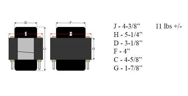

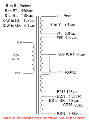

I have a vintage Hammond Power Transformer with a 450-0-bt-450. I think I measured 50 something on the bias tap. A 5v pair and 6.3v pair. I don't know the current rating, but it's big enough to anchor an aircraft carrier, so I should be ok.

Well, depend on what you want to spend on output tubes and iron. But one suggestion would be EL34 PP, nice tubes that can do much with the about 630 volts that the DC after rectificaton with SS diodes would give. Have not looked up the figures, but this would get you a lot more than 50 watts, with an OPT of about 5-6 kohms P-P.

Hammond hasn't changed their parts since the 1950s. Try to look it up. Weigh it and find one of the same heft. Knowing the current will set some outer limits what is practical. But if it really came off an aircraft carrier, it may be for a kiloWatt radio ham rig.
Several tubes will stand >600V on plates. Very very few are rated for near that much on screens. Since screen current is very variable we can not take a large drop in a dumb resistor. True, even back in the 1970s it was possible to rig a TV transistor and 300V Zener string (selected 1N914) as a solid G2 supply.

That concept and the OP's 450-0-450 doesn't "jive" with Hammond's product chart. The 278X and 279X come close. Neither of those items will produce the current needed to support a stereoblock using EL34s or 6L6GCs, when cap. I/P filtration is employed. A possible stereoblock using a 278X would employ PPP 6Π14Π-EB (6p14p-ev), AKA EL84M, "finals" and a SS rectified choke I/P filter B+ PSU. Being able to access the full VA capability of the power trafo contributes mightily to the cause. Voltage multiply the 5 VAC winding to derive the bias (C-) supply.

If you can weigh the transformer and also measure dc resistance of each winding, we should be able to better guess current ratings based on other transformers.
