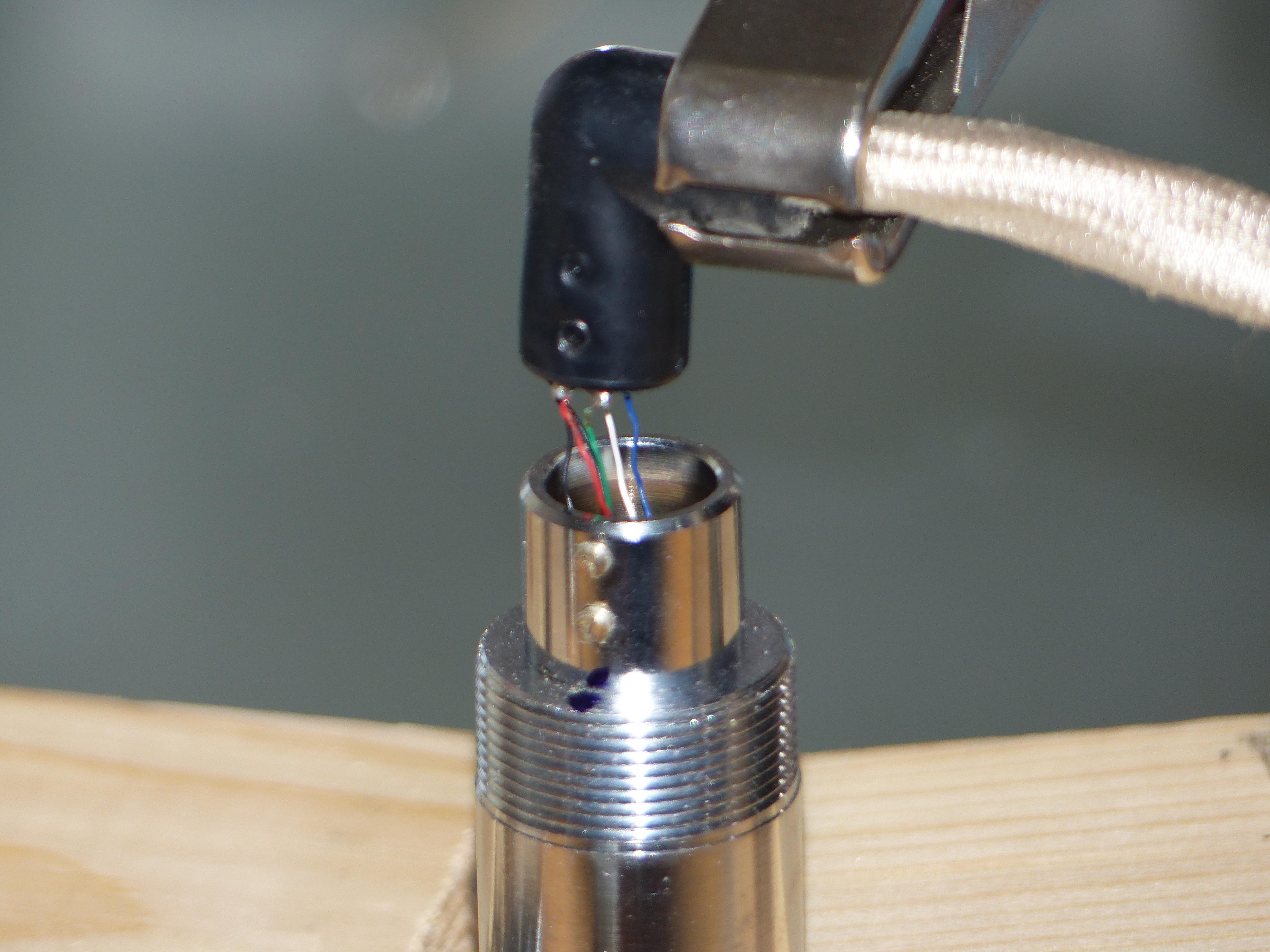

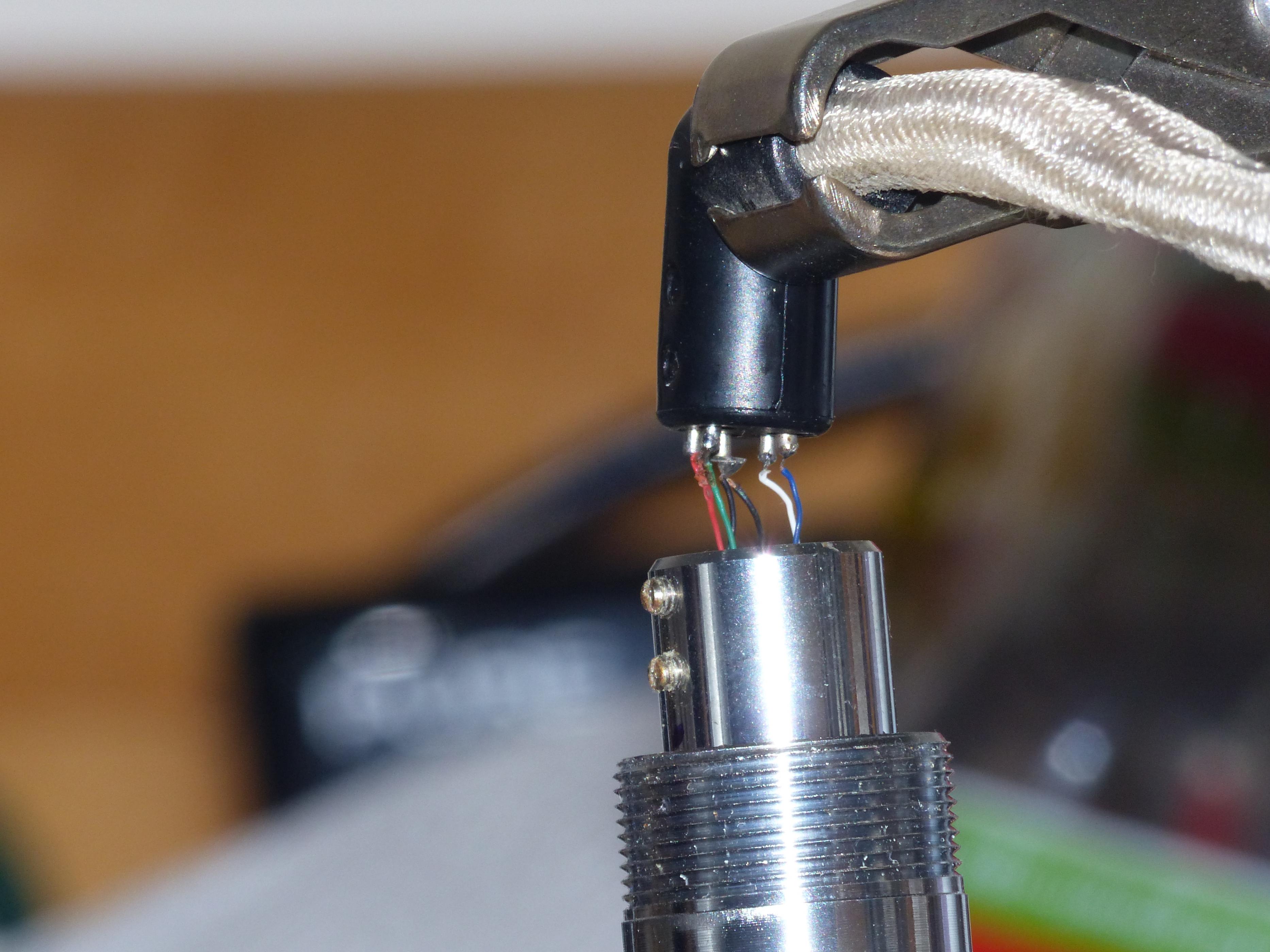

For disconnection and reconnection of the wiring, which appears to be one hardest things to complete, I thought I could use a threaded rod mounted vertically on the fixture with a large crocodile clip to hold the angled connector in between two nuts and washers which can be turned and carefully raised to reveal the wiring without putting any strain on the fragile wires.

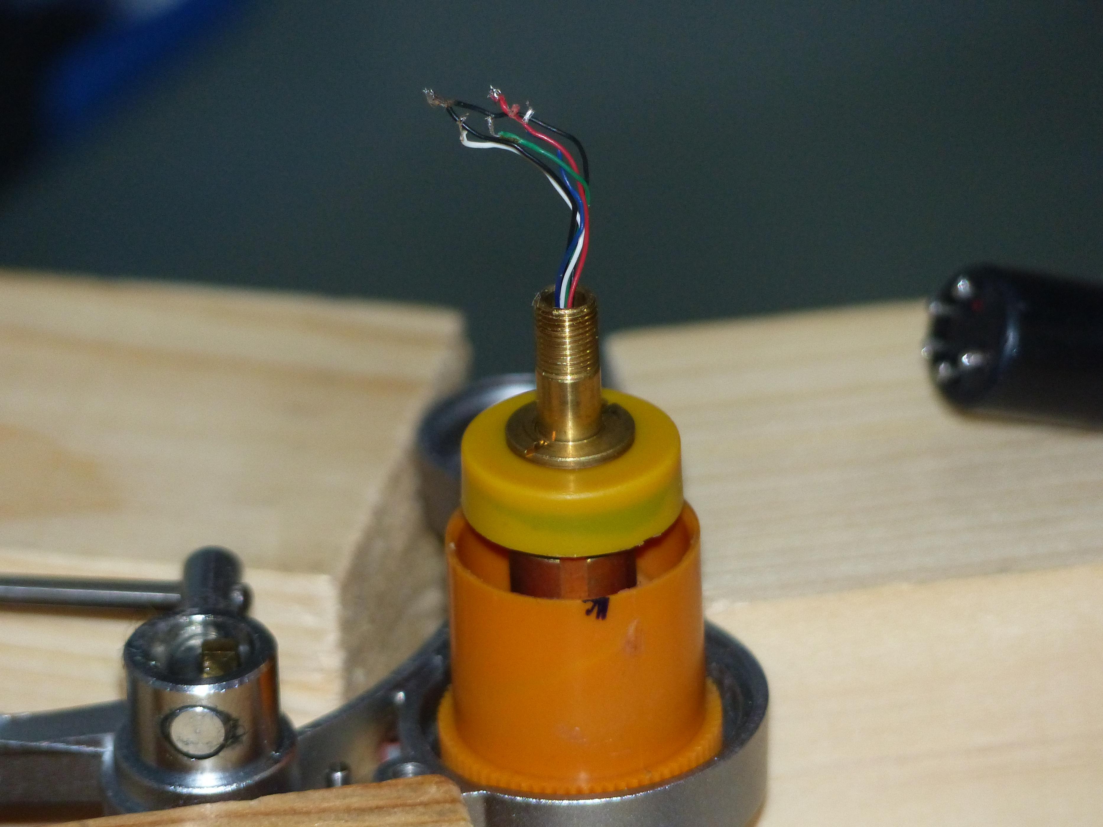

Well, Made a start on the Rega Arm, Came apart quite easily, probably the most fiddly and delicate things to do is unsolder the wires from the connector assembly, and a couple of things I did notice that differed from the "How to" over on the Vinylengine site is that mine has a Thrust Washer on the top of the main bearing, and the other thing is, the how says that the Two Black wires, one is connected to the solder tab, and the other is commoned with the blue wire, In my case Both Black Wires go to the solder tab.
The solder tab is a bit of a mystery, as I unsoldered the Two Black wires, the solder tab came away, and was stuck to the end of the soldering iron, so I'm not sure if it's just held in place with a wing and a prayer, or actually soldered to the centre pin of the connector, The hole in the tab is to small to fit over the pin of the connector for a proper solder connection, so it may have been just tacked on, but either way, not a good way of doing things.

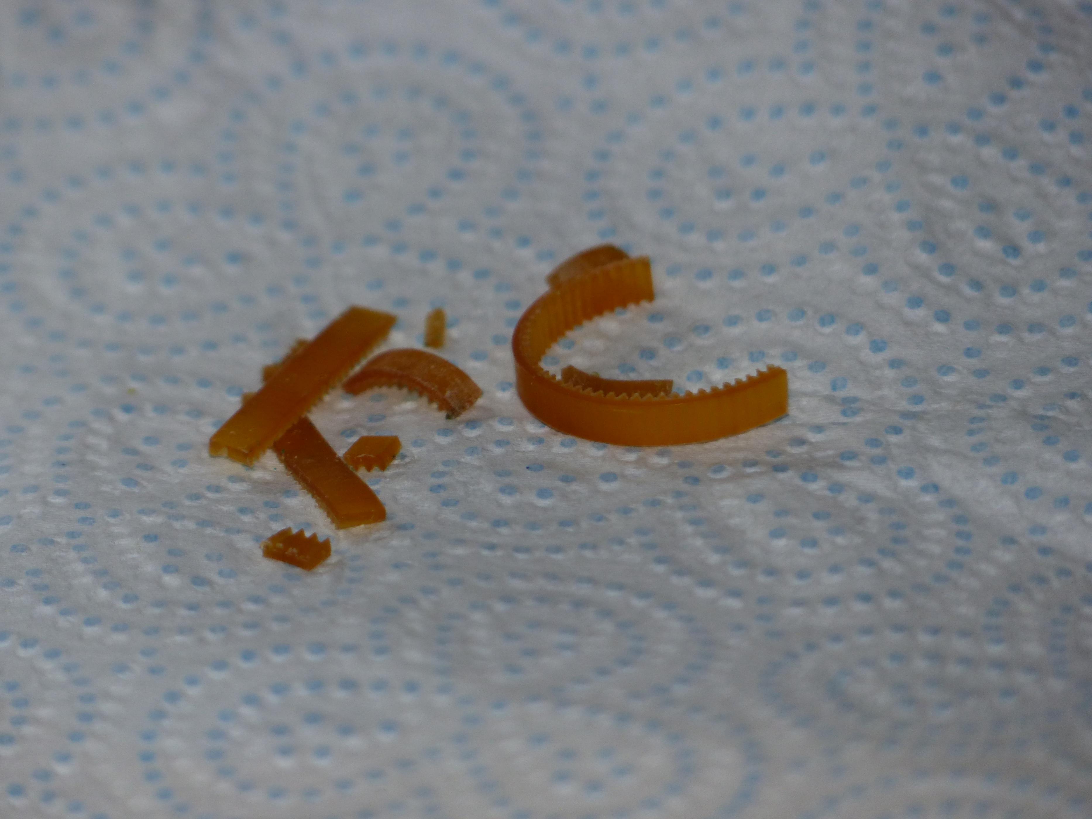

Well worth it in the end! And the worst part was my anti skate belt wasn't broken! I still replaced it though with this:

I started taking photos at the start, but when it came to trying to hold the new belt in, keep the A/S Dial set at zero, whilst trying to hold everything else in place, it was the last thing on my mind, and I only realised I had forgotten when the main housing was back in place.

Here are a few photos I did take, showing the Jig I knocked up to cradle the arm, the red and Green wires had already had some insulation damage to them even before I let lose on them
