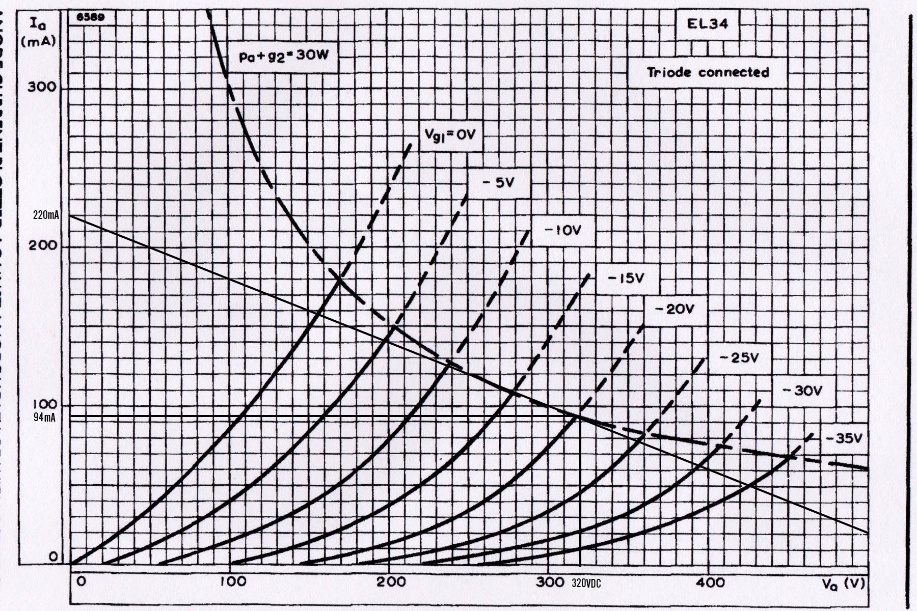

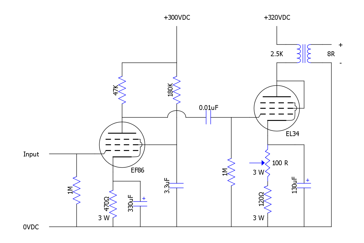

After dabbling with EL84s (both pentode and triode), I finally found a promising output stage using a triode strapped EL34, fed from an EF86 driver stage. Here's a tentative first go at a circuit:
I'm estimating 4.1W per channel, with 2.63% 2nd harmonic distortion. Feel free to laugh if my figures are way off, although when you're quite done I'd appreciate it if you could tell me where I've gone wrong.
Assuming it's not a complete non-starter, there are a couple of questions I'd appreciate some advice on, namely:
- Will the driver stage be powerful enough to drive the output?
- Will I need a seperate pre-amp to feed the driver?
I'm currently mostly listening to vinyl, through an old Project Phono Box MM, who's output is a suggested 500mV @1kHz.
I can show my working, if that'd help, but I won't ask you to check my errors just yet. Any more info you'd like to see I'll do my best to provide.

The EL34 is biased at 20V/94mA. If anything, the EF86 is way too sensitive to drive the EL34, especially wired as a pentode. Based on your phono preamp having 500mV of output (kinda low, but adequate), something like a 12AT7, 5965, 6DJ8, or 5670 will provide adequate but not over the top gain.
A 220 ohm cathode bias resistor should be just fine for what you're doing. A 5W part is probably adequate, but a 10W resistor will provide lots of thermal margin. I don't think it would hurt to go to a 470uF bypass cap on the output stage.
I like the suggestions to triode strap the EF86 if you find it too noisy or too sensitive as is. That's an easy change, so I say build it as you drew it out and then tweak it to hear the difference first hand.

Thanks for the advice. I was worried the EF86 wouldn't be powerful enough, turns out I'd gone too far the other way! Oh well, back to the drawing board. Would you suggest using the EF86 as a triode (as Ketje ably illustrates below), or opting for something different?
What about the 12AT7 (or ECC81, in Brit speak)? I think I've a few of those, although they might be ECC82's. Would you prefer the 12AT7 to the triode strapped EF86?
Re the output cathode bias, if memory srves I was aiming for a 1Hz cut off frequency with the 130uF cap. Assuming I've got my calculations correct (which I may well have not), changing up to a 470uF is presumably going to raise that frequency? Is designing for 1Hz overkill in this situation? I'm learning most of what I know from Morgan Jones 'Designing Valve Amplifiers'. He certainly recomends a 1Hz cut off in small signal stages, does that concept not transfer to the output stage?
Matt.

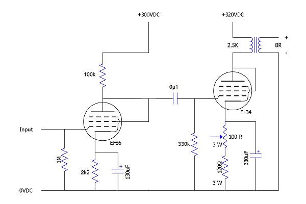

Try someting like this.
Mona
Thank you, I'll give that some serious consideraion. One question - what effect will the change of value in the grid stopper resistor from 1M to 330K have?
Is it there to increase the gain or alter the input impedence?
Just one more thing (doing my best Columbo impression), is 0u1 the same as 0.1uF? I don't think I've seeen it written that way before.
Matt.

Mullard specifies 500k as a max. , with 330k we are on the safe side.
Is like 2,2kΩ writen as 2k2.
Mona
It's not a stopper, but a path to ground for the grid to get it on zero voltage.Thank you, I'll give that some serious consideraion. One question - what effect will the change of value in the grid stopper resistor from 1M to 330K have?
Yes same thing. 100nF or 0,1µF or 0µ1Just one more thing (doing my best Columbo impression), is 0u1 the same as 0.1uF? I don't think I've seeen it written that way before.

Thanks. I think I meant to say grid leak, but thanks for the explanation. Although it seems obvious now, I hadn't realised it was performing that function. I thought it just served as a path to ground for stray electrons which found themselves attracted to the grid, on thier way to the anode.

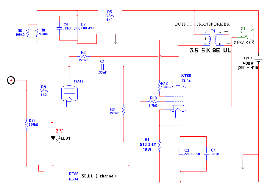

Post #12 here is for an easy and good sounding build.
Good schematic for SE EL34/KT88 amp | Audiokarma Home Audio Stereo Discussion Forums

Thanks for the link, but having gone to the trouble of designing my own circuit, I'm at least going to give it the honour of a fair trial.
