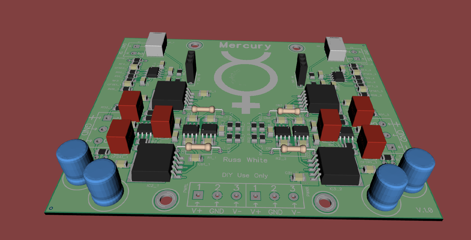

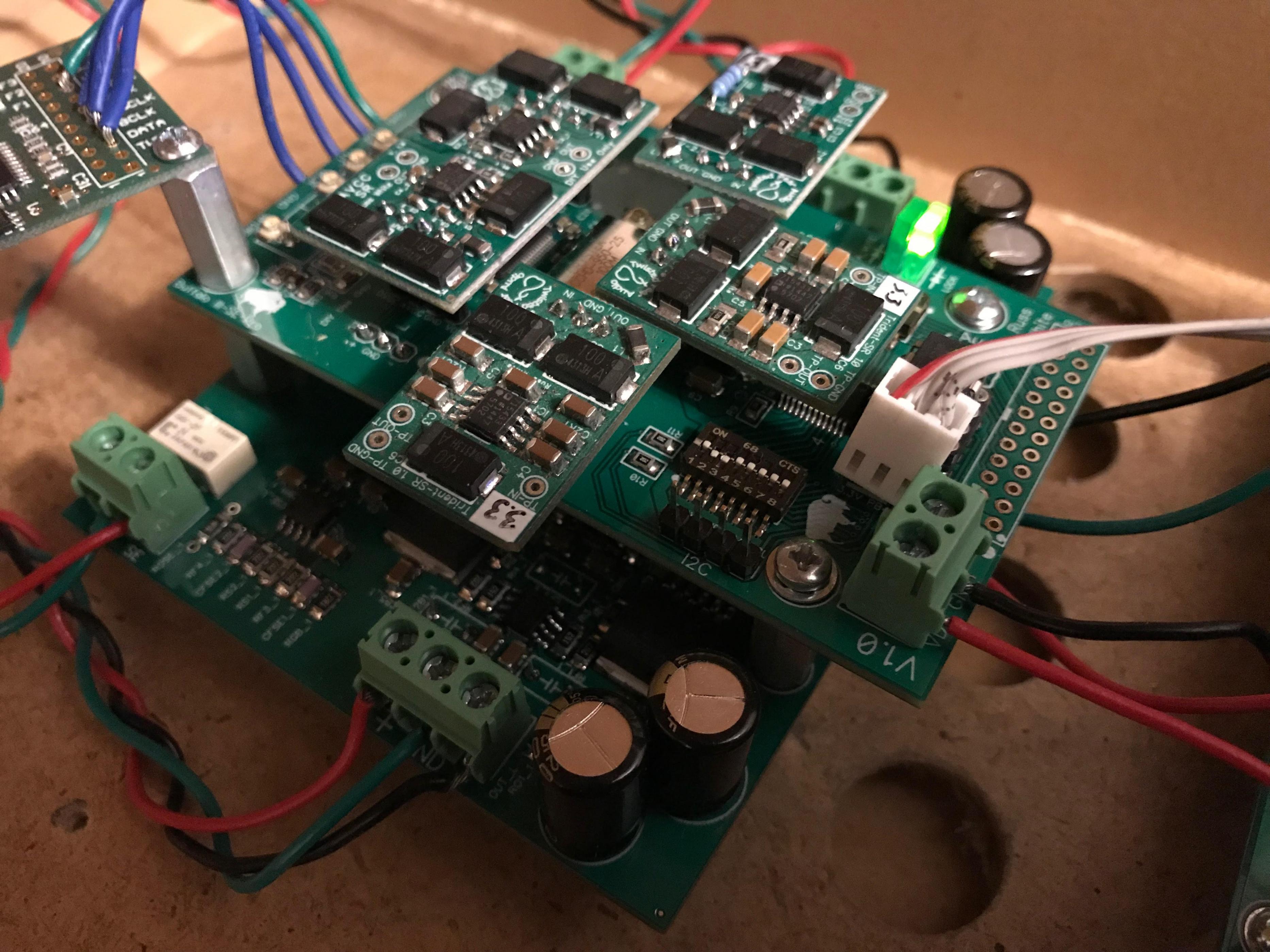

Until Brian or I have a chance post better pictures - here is a render of the 1.0 PCB - along with a shot of it playing in the test rig with a ES9038. :)

Soon :) The 1.0 boards have a (smack my head) small error - one disconnected GND pad at the right side balanced output (if you look closely you can see it in the render) - so we are contemplating just waiting for corrected boards (1.1) to arrive or going ahead with current boards for early adopters. It's easy enough to connect that pad to ground via a jumper. :)
Thoughts? I know many of you would not be put off by such a small error - but some will - so I am open to the idea of open sales for 1.0 with the errata - everyone else will just need to wait a week or two for 1.1 boards to arrive (which will only be different in that one way)

There’s actually very little left to solder. Just headers, terminal blocks, the gain resistors and some capacitors. Basically just the through hole parts.
I am going to be very transparent about this design, This is DIY audio, I am being very intentionally open.

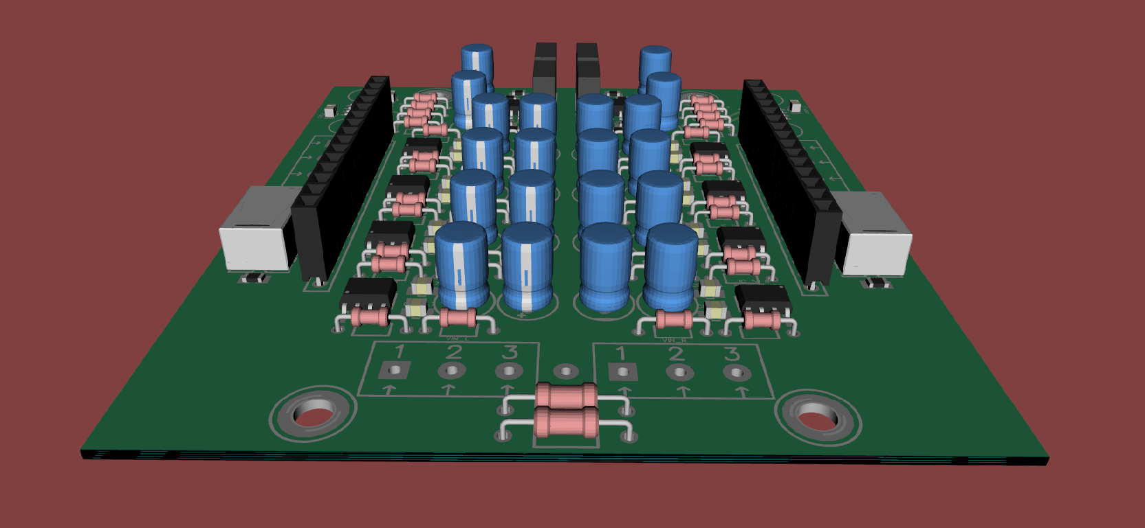

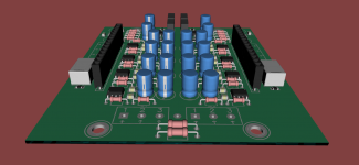

I understand this is probably a bit premature, but does this earlier image show the I/V stage that you refer to as "huge" and "expensive" and a harbinger of the 8-channel version to come?
Thanks!
Andrey
No, that was a very early design idea - it is similar - and actually that one in the picture looks like it is for stereo use
Cheers!
Russ

LOL... that's an easy fix.
