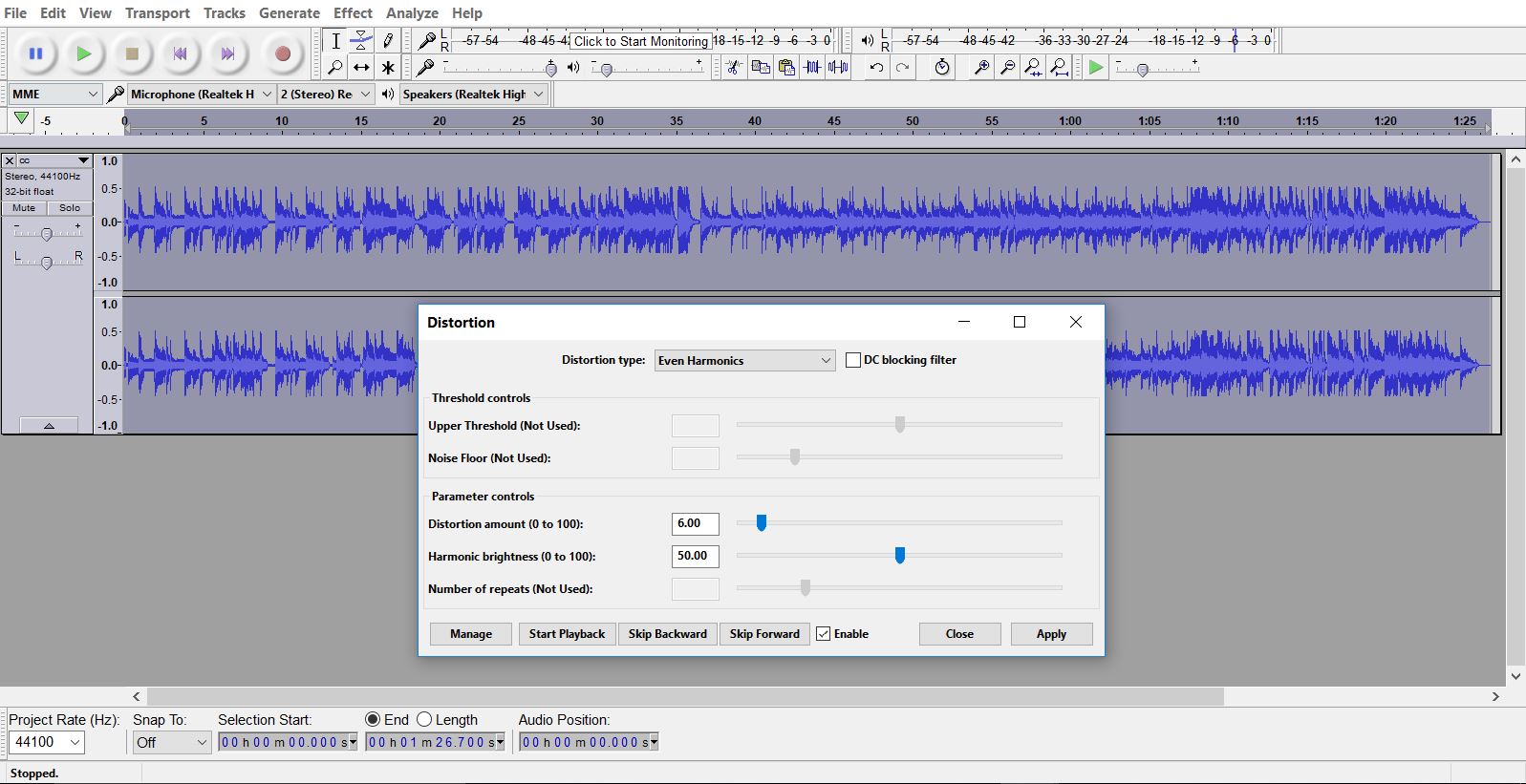

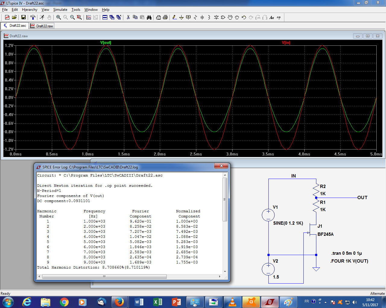

You can play around with this in Audacity. Try 3 or 6db for a start, save your file under another name and then compare using an ABX comparator such as Foobar.
For a real circuit I would go with a JFET as in post #5.
You can even try that for real by simulating it in LTSpice (make a stereo pair) and applying a .wav file to the sim and then capturing the output.
I tried in audacity, i couldn't find that specific "distortion" plugin, but i tried "diode processor" using half wave settings. To my ears, at low levels the distortion is not that bad, it's kind of bearable. At higher levels it just sounds distorted, and at full wave settings it is just unbearable.
I alse tried "harmonic generator" with similar results. Odd order harmonics just sound harsh and evil, even order harmonics are more bearable (especially low order, the higher you go in order, the worse it gets) but still sound distorted/bad.
