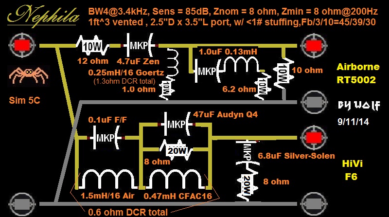

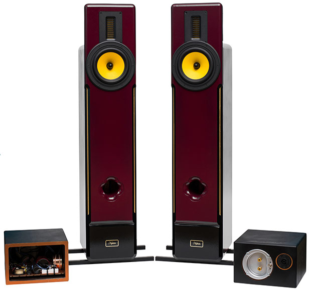

I used the 5002 in my Nephila project. It was great, dynamic, but only good down to about 3.4kHz.

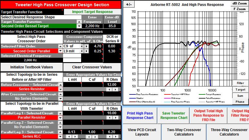

Well, it all depends how they are implemented, but I'm sure you know that already. I found an .frd file for them, and yes they have to be "tamed" to get anything resembling a flat response due to their very "peaky" nature, so in effect down-tuning the sensitivity via the crossover can get them to seemingly behave differently, so it seems.

I did have to notch the peak in the response, but there is enough sensitivity to do so.
The boosting of the lower treble for this driver would best be done by a waveguide if you are inclined to go that route. Hawthorne Audio used a Beyma TPL-150 this way and it seemed to work for them.

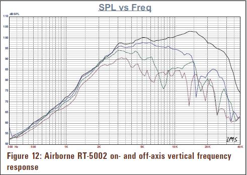

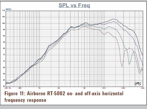

I don't know if using multiples will do much to extend the low end, as the inherent FR will still reside. Due to the vertical dispersion, I doubt you'll get much comb filtering to reduce the top end in that manner either. They also don't couple like non-planar types to increase level in the lower treble.

Try this again...
This ought to help you out,
Wolf

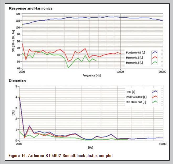

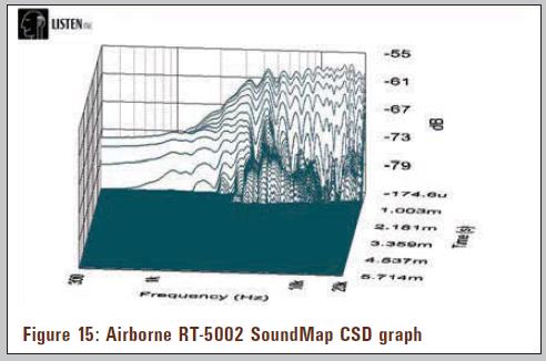

Thanks, I think I had ran into those pictures previously doing a google image search. If only a suitable off-the-shelf horn for the RT-5002's existed. We have a 3D printer at work, but I'd have to learn the programming language to set it all up. I guess this is a good a time as any, lol.
