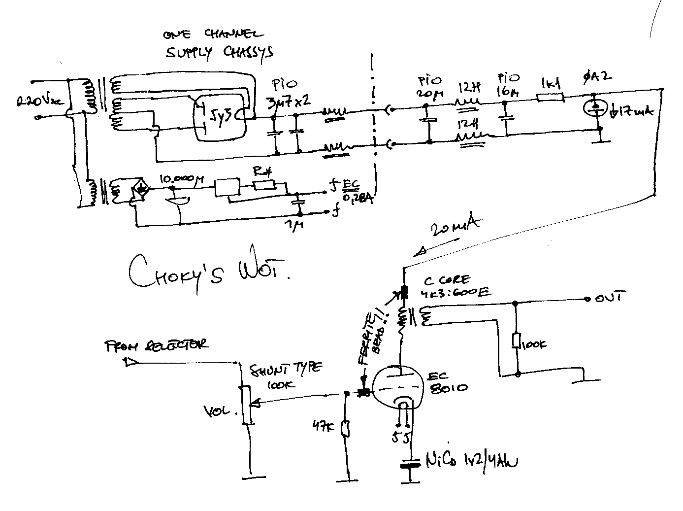

Result of first tests , hardly optimal ( using two halves of 6SN7 in parallel and loaded with ancient xformer from vertical section amplifier of ancient B-W tube TV set) , I was blown with ‘till then unknown dimension of sound – everything was so alive ….

Anyway , what was main quality of (then) newly explored territory for Mighty ZM …. I couldn’t easy describe what that was , and only after few years I came with explanation how I understood it – what I was hearing ( and I hear that even after all these years) is result of important phenomena – Signal Energy Preservation.
Simple – with resistive loading – efficiency of stage is always low , while with inductive loading it is way higher …… energy of signal isn’t dissipated along the chain (as with resistor) , it is being transformed in ratio of intrinsic values (voltage , current , thus impedance).
Remember that I’m not formally educated in electronics , so I’m pretty much free to invent new postulates whenever I want .

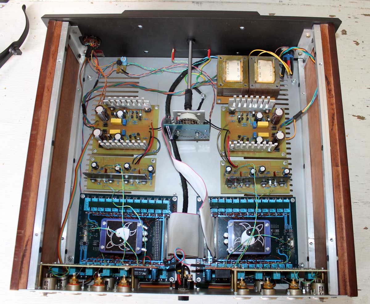

After successful realization of concept , I knew that few shortcomings of Iron Pre aren’t in necessity for Preputium made of parts , or Iron choice …… it is in fact of still having resistive attenuator …. and always tempting fact that somehow is possible to dispense scarce Toshibas for something you really can buy in nest Tobacco Store.

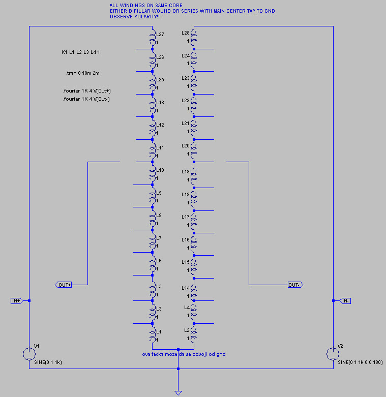

So ,as a result of my day(night)dreaming, it came to prototyping of Iron Pumpkin , both SE and Bal iteration . Last one simply without suffix, while former obviously having SE as part of name.
Due to intrinsic nature of balanced xformer ( fed ballanced , outputting signal also ballanced ) with necessary involvement of GND on either or both sides , it’s also having virtues of SUSY , as Papa patented it years ago. (Old Bull/Devil , always tongue in cheeks ).
So , conclusion – to my ears – inductive attenuator is best sounding of all alternatives , and I really succeeded in dream of achieving (settable) gain with same device and , last but not least , natural conversion of SE to Bal , or other way around , in case of Iron Pumpkin (Bal) .

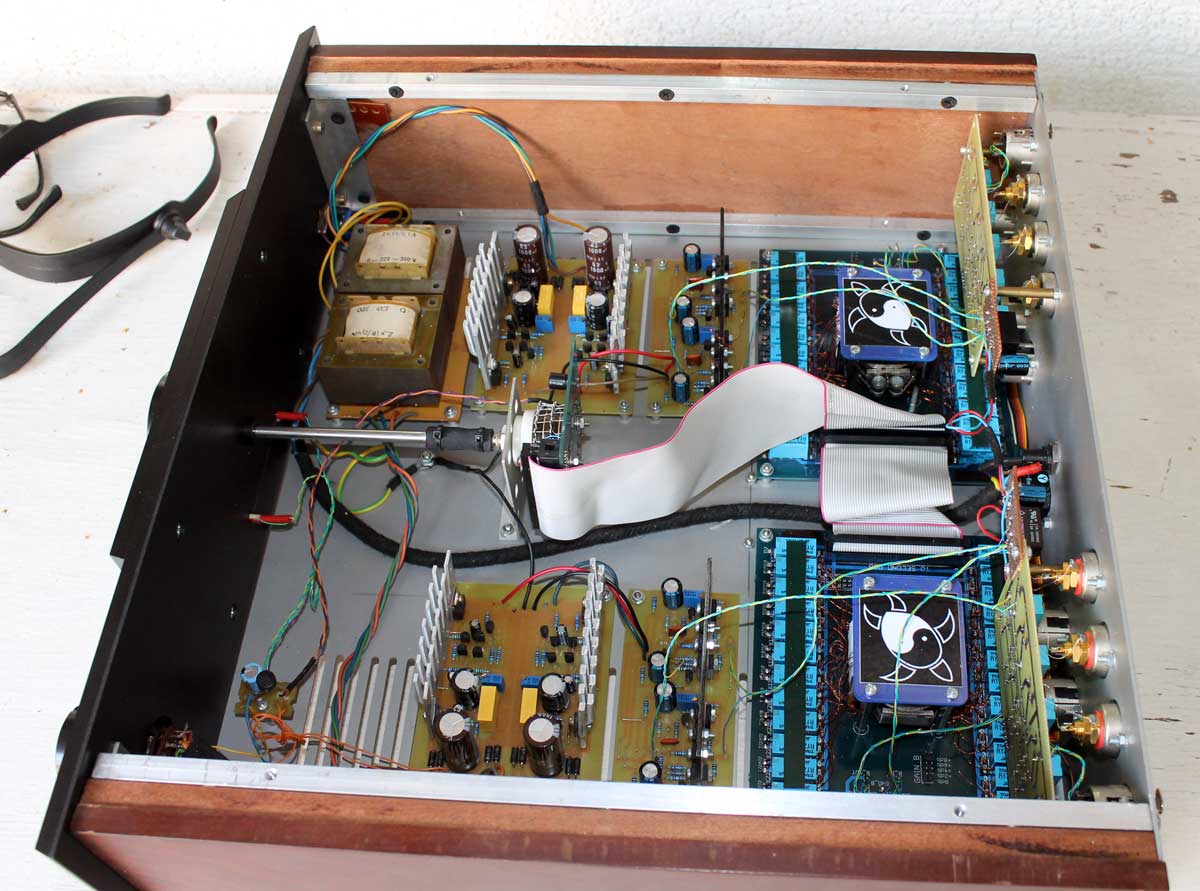

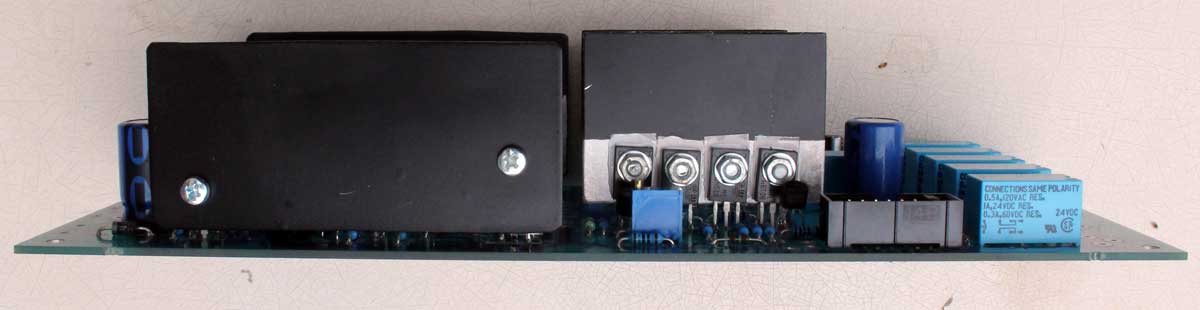

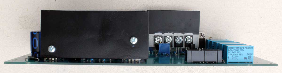

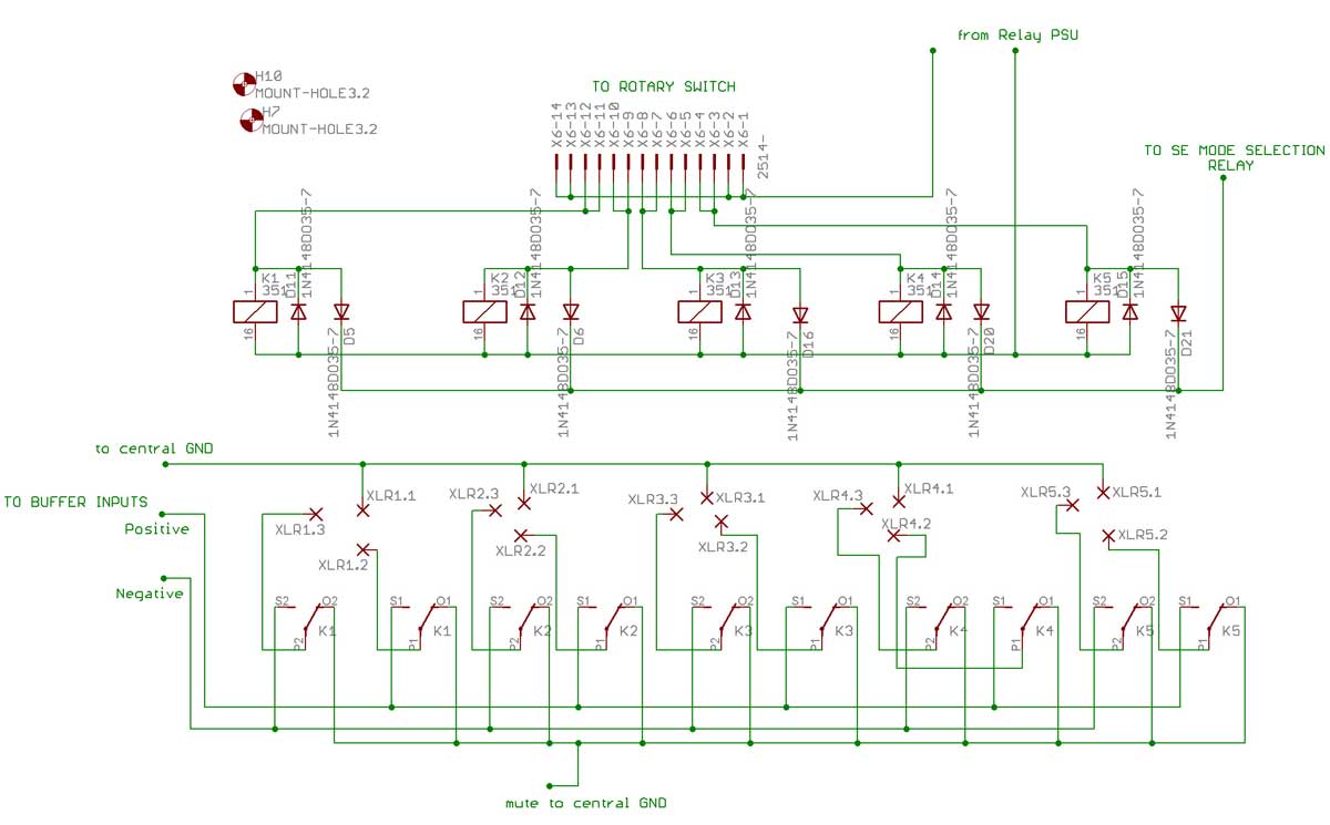

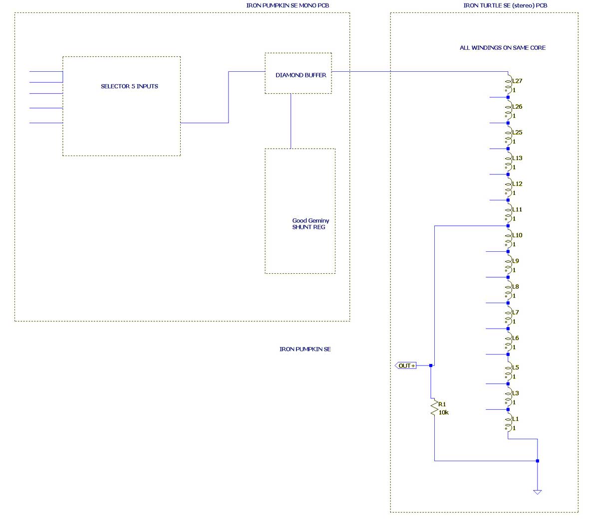

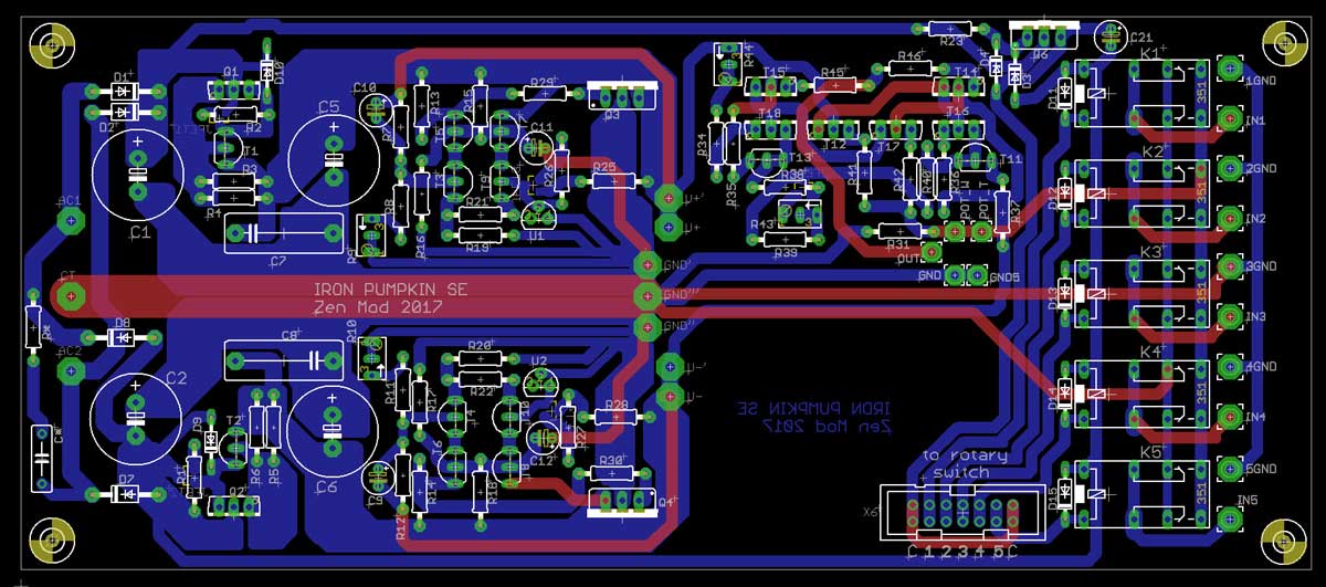

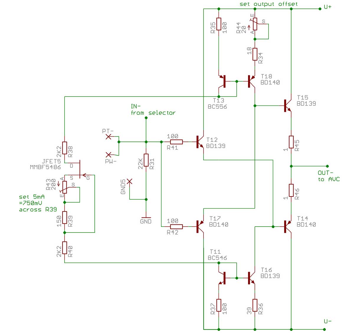

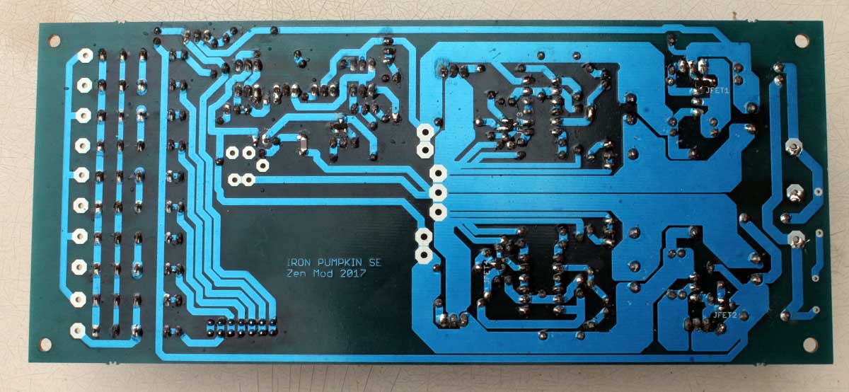

Time for few block schematics ; first Iron Pumpkin SE ( chinch, RCA , whatever)
What’s shown are basic blocks – input selector , single buffer ( single phase , yup) fed with Good Gemini shunt reg , then AVC , with selectable input tap ; when fed to top – possible gain is odb , with chooice of tapping in to -2 to -8 db , respectively , so possible gain from 2 to 8db.

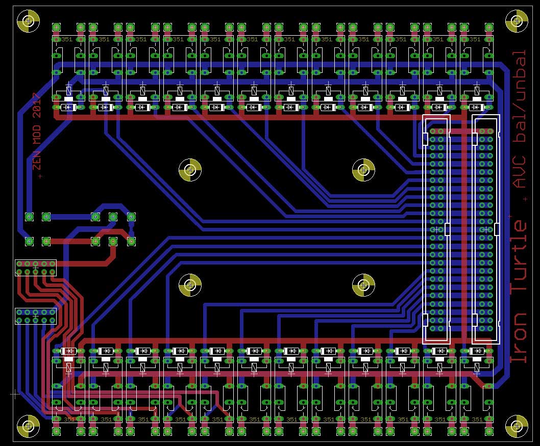

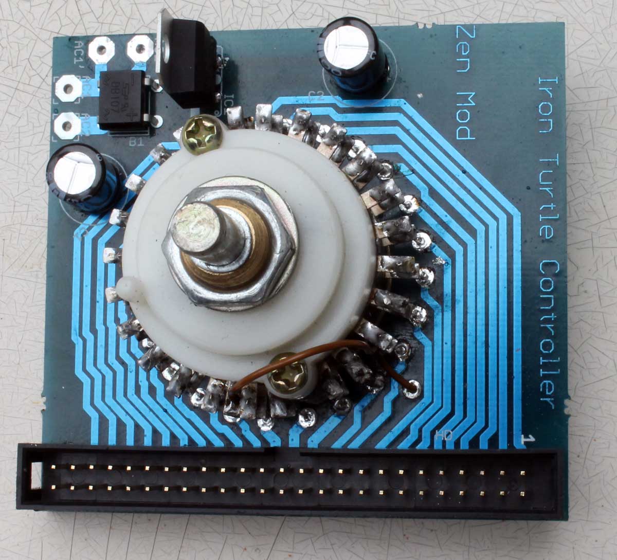

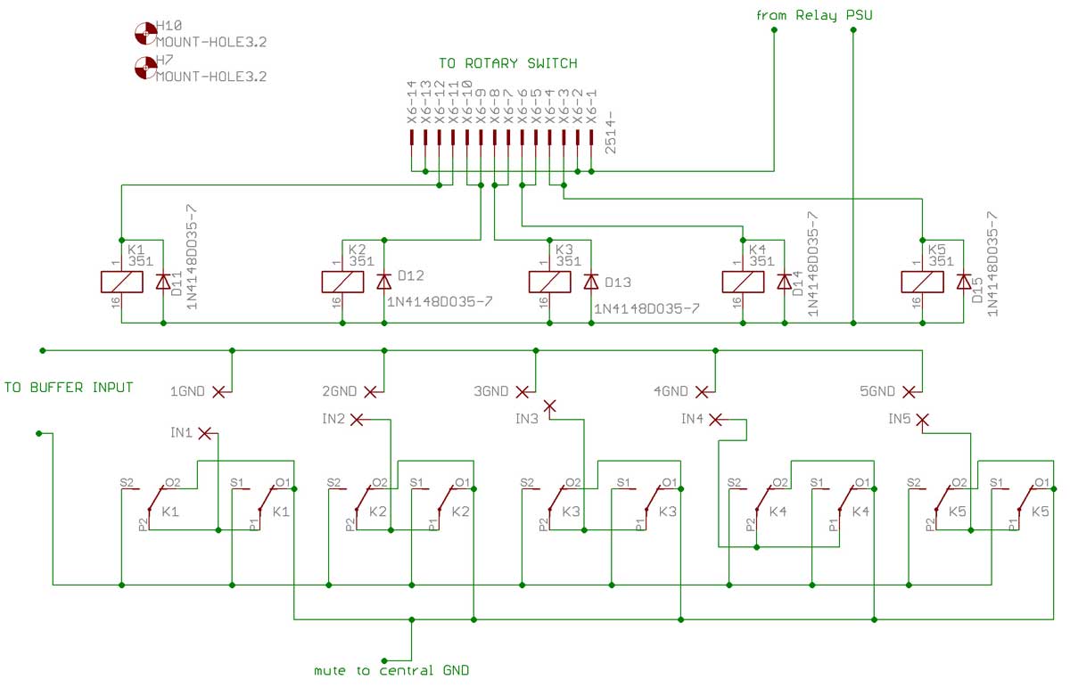

Selector – simple 5-position rotary switch operating with 5 Takamisawa relays ; they’re good for industrial and medical instruments , so ….

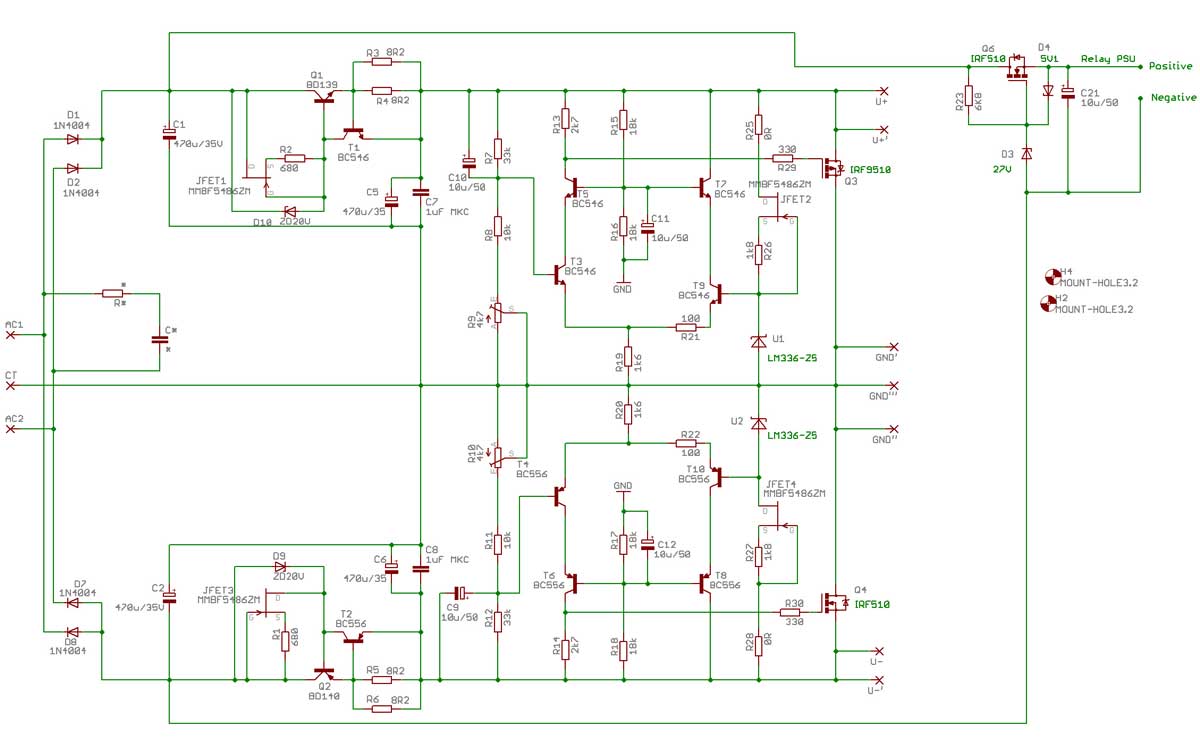

Good Gemini – simplified but also hot-rodded iteration of well known Shunty.

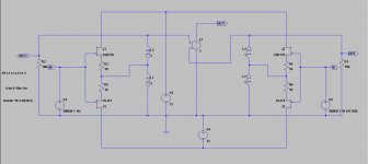

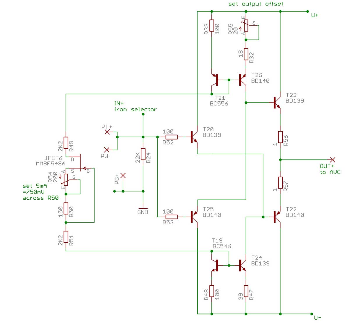

Buffer – current mirror biased Diamond Buffer …… nothing new , but painstakingly to achieve same THD spectra as with Toshibas , luckily with even beter behavior under heavier loads.

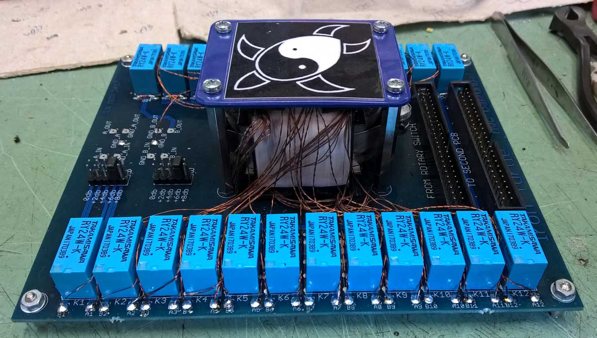

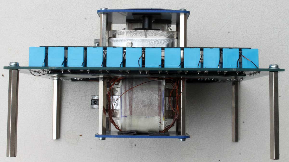

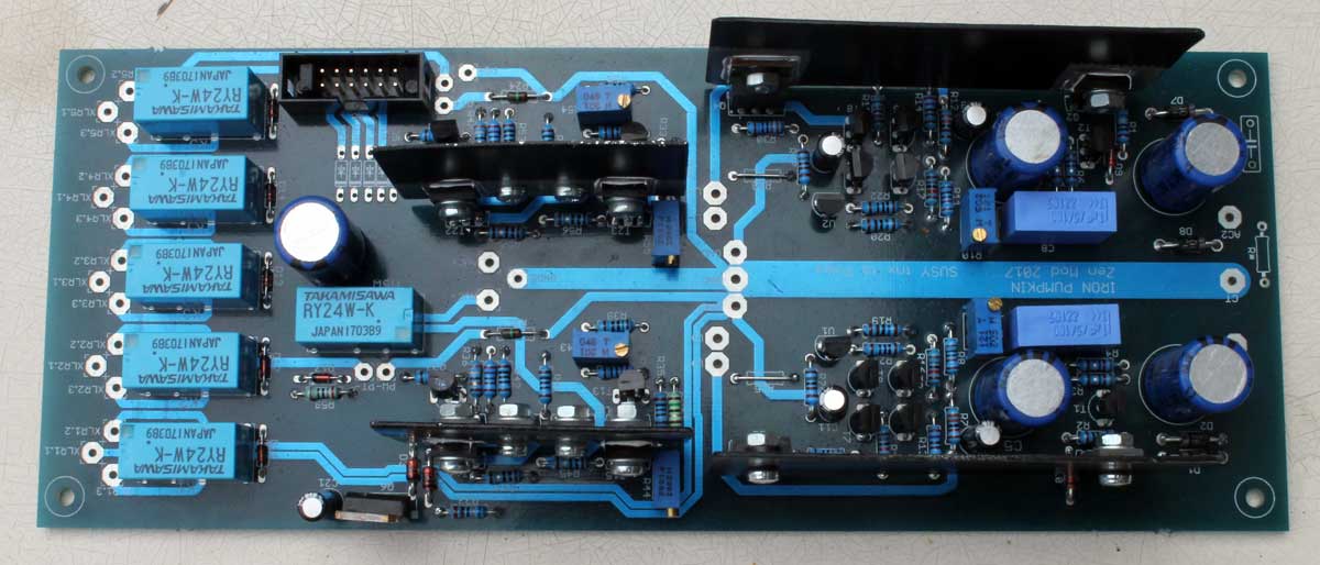

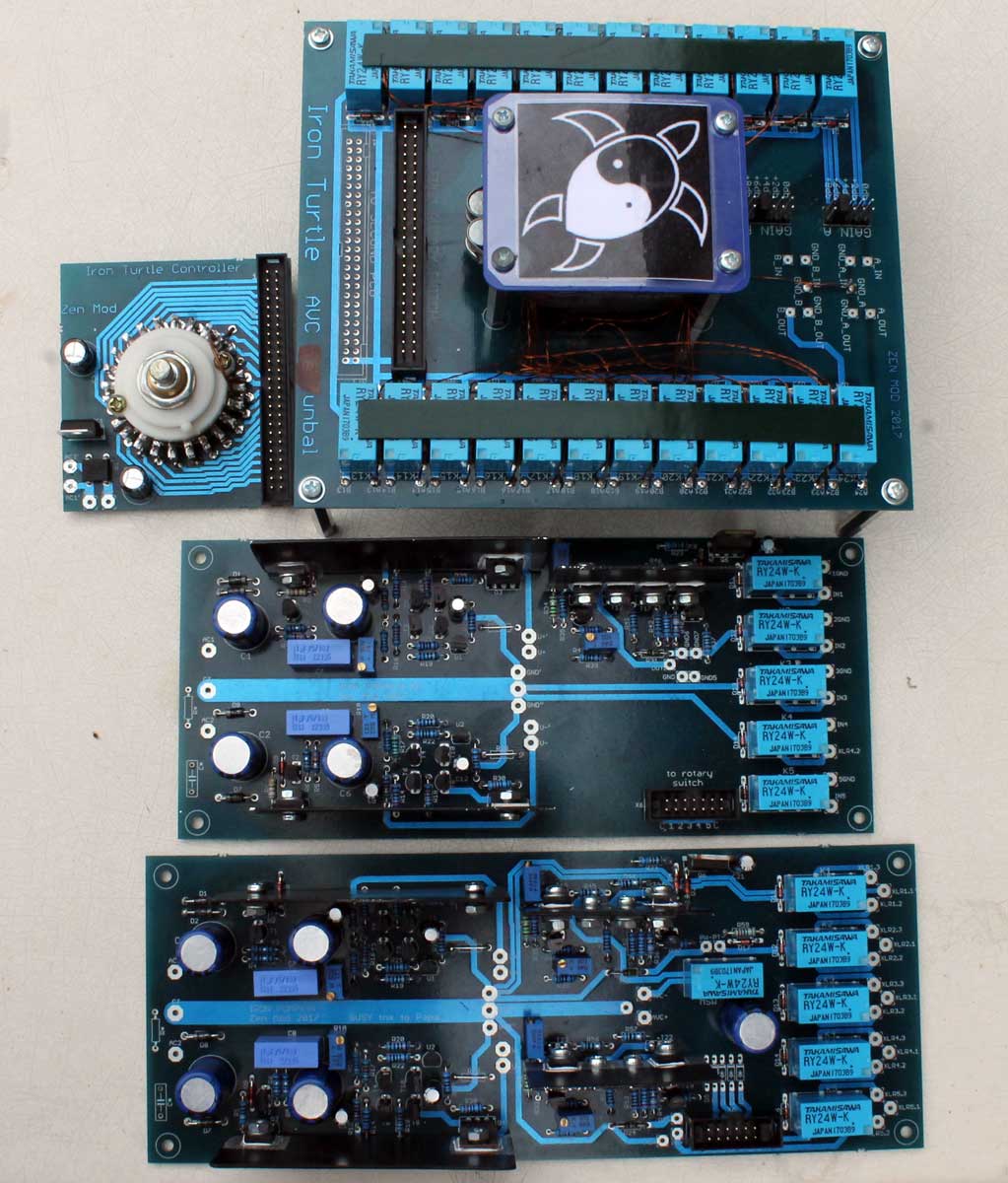

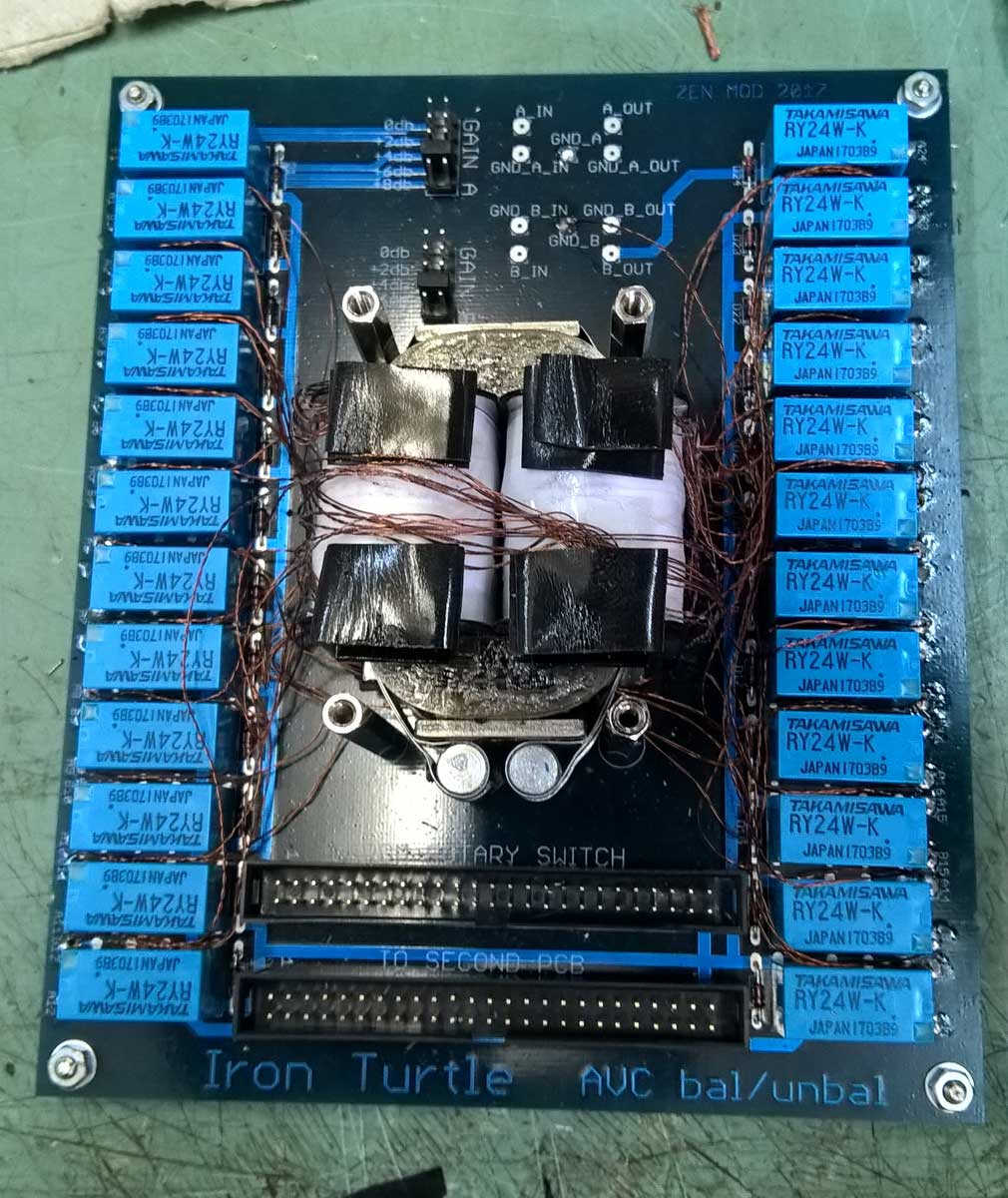

AVC – called Iron Turtle SE ,based on Hitachi Metglas (AMCC008) cores. Coil – 10H/100Rdc jobbie , as (always!!) compromise between needed Good Inductivity and several Bad Factors (known as Bad Capacitances , Bad Inductivity etc. …. in fact , using AVC instead of TVC is Bad Inductivity non existent ); insulation between layers is Teflon based , bobbins are/will be custom ones , everything PVC coated after assembly.
Disclaimer – as for difference to almost all AVCs on market , these aren't intended to be Swiss Knife universal jobbies , they are constructed to be driven with buffer or , at least , pretty potent signal source apparatus.
Two AVC Irons on one Iron Turtle pcb , so that’s enough for stereo.
Switching again through Takamisawa relays ; flat cable going from Turtle pcb to front plate mounted 24 position Chinese Switch .
Chinese Switch – even if made by carefully chosen group of Chinese Virgins , only during full moon nights , each one is gladly disassembled then greased with graphite grease then assembled again , by Mighty ZM himself.

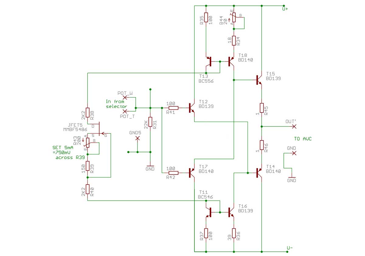

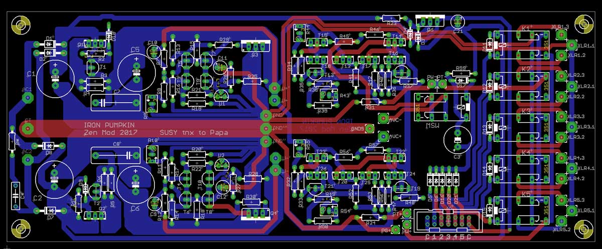

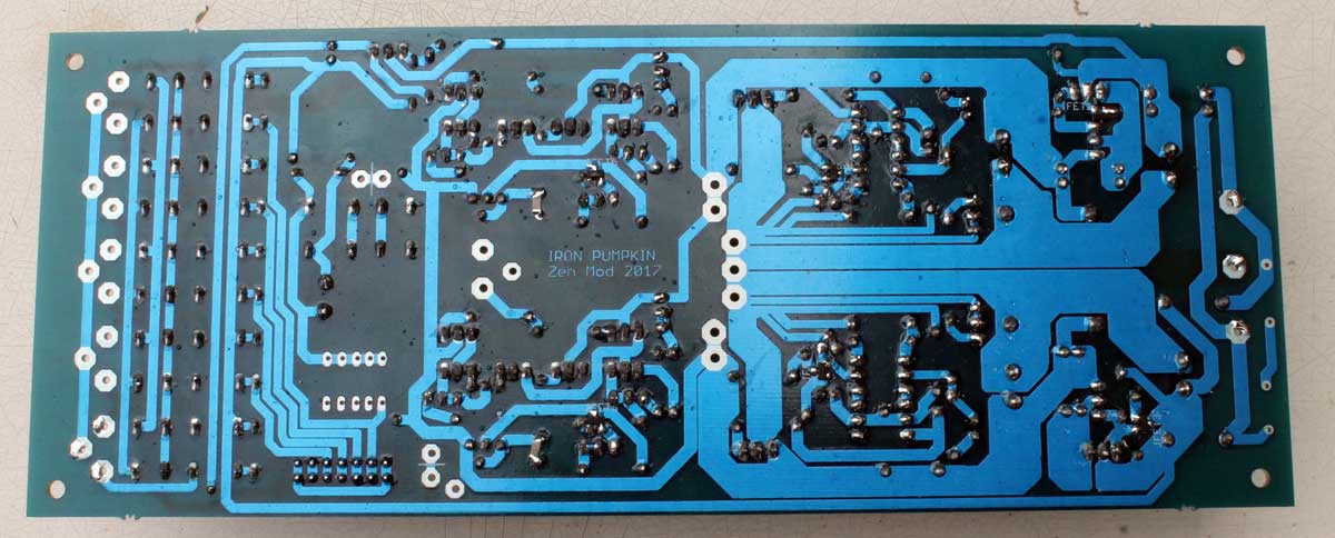

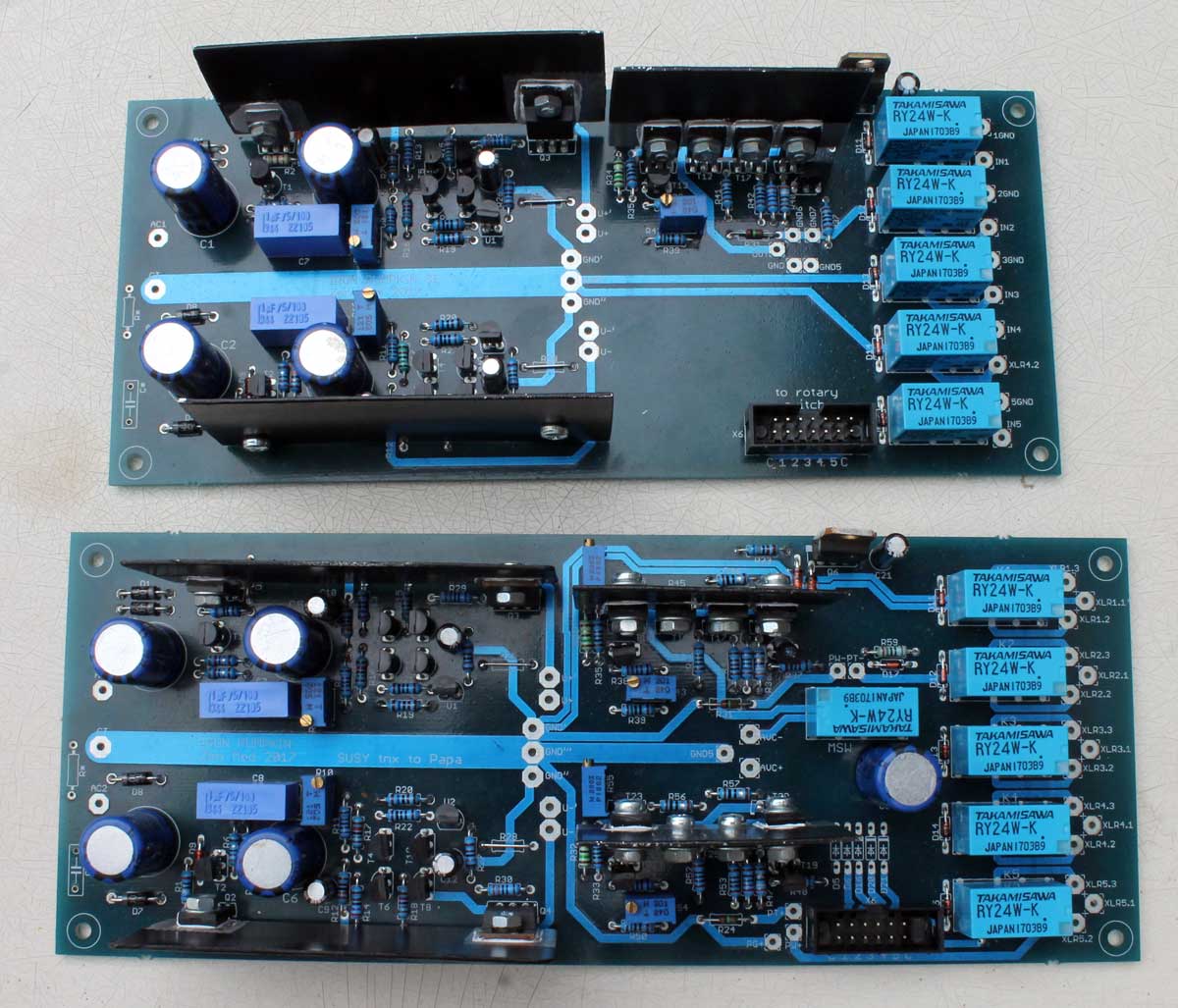

few pics

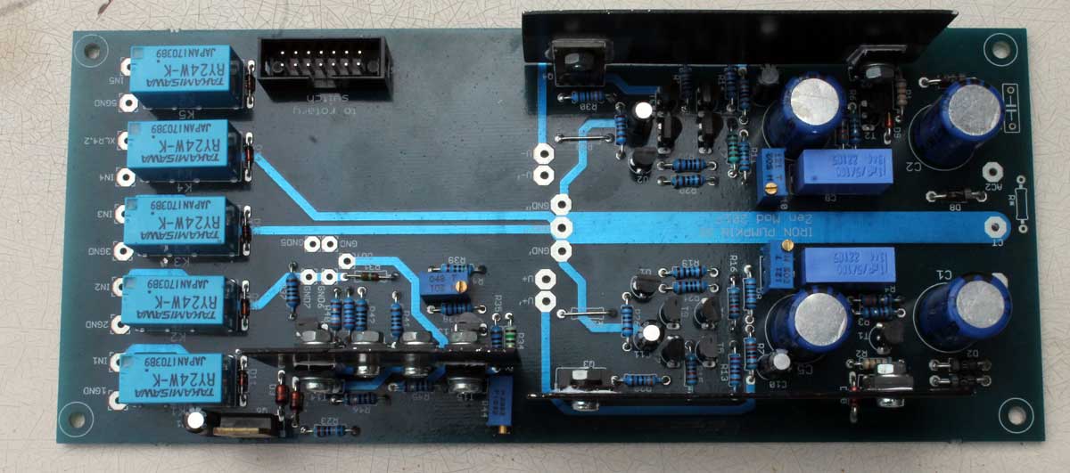

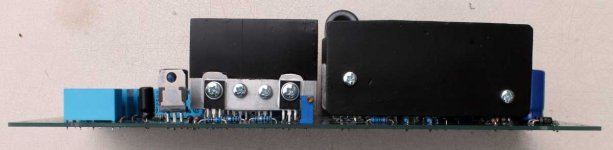

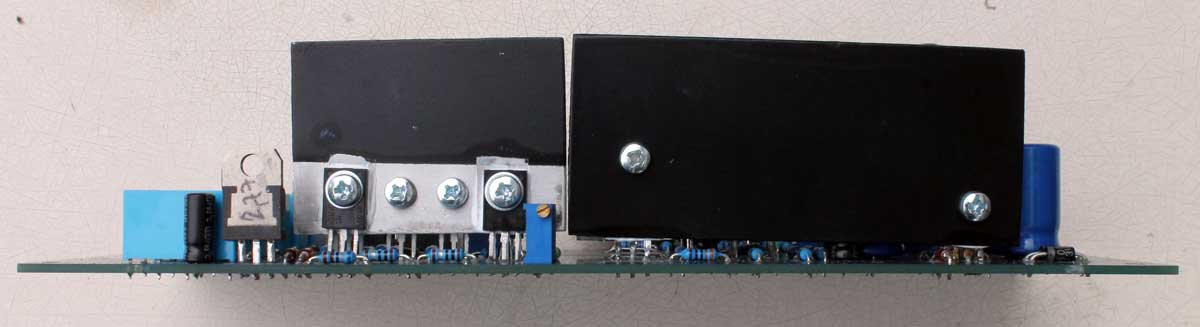

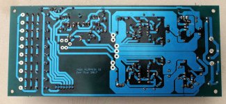

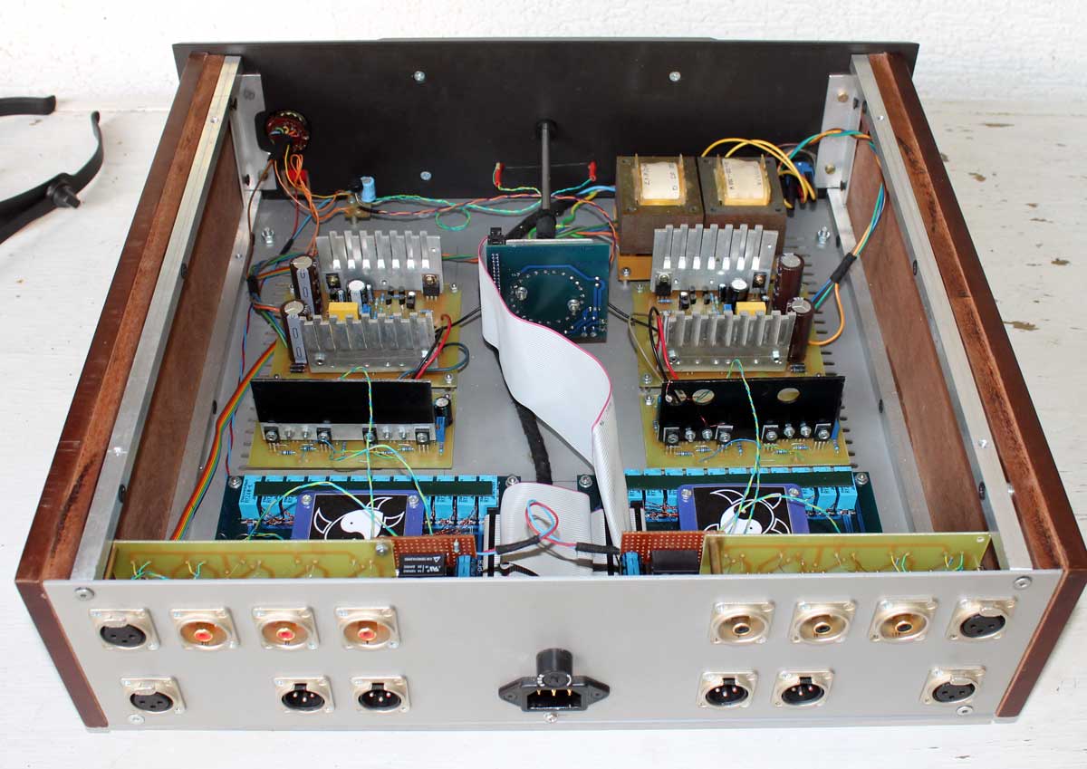

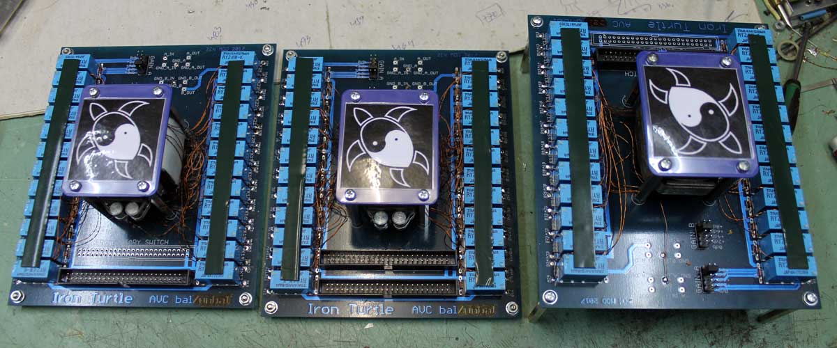

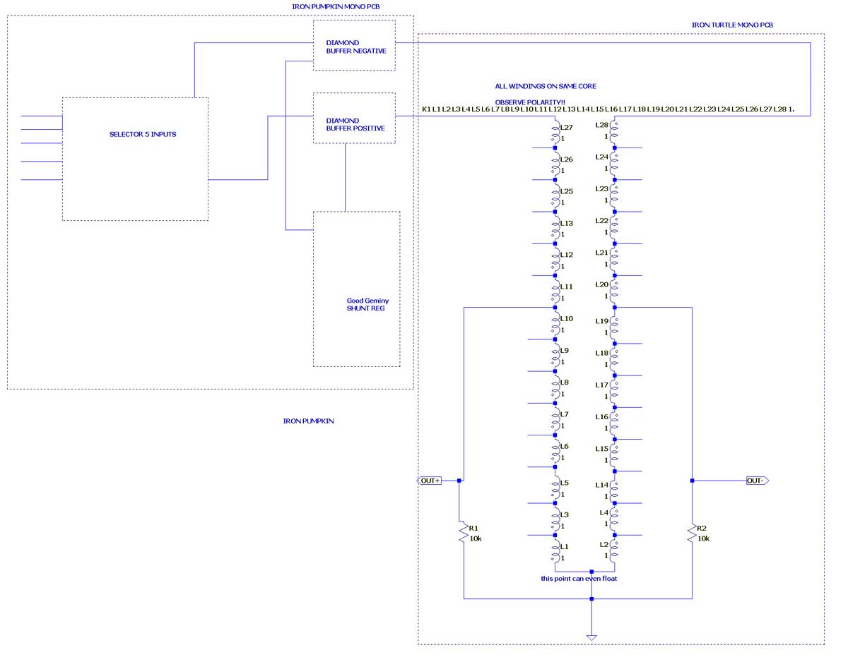

Now , on to Iron Pumpkin (Bal) ; block schematic similar , except few facts :
-two buffers per channel
-AVC/autoformer connected in differential manner ; again – there is intrinsic SUSY -error correction , whatever you choose to call it . Facts about construction written for SE, applies here also .
-One AVC Iron on one pcb , so two pcbs for stereo ; Newest iteration of I. Turtle pcbs optimized for stacking , so footprint stays the same as for SE.

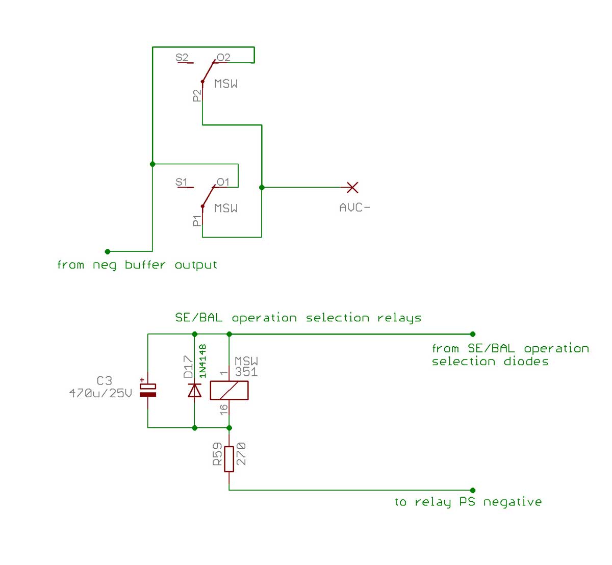

-There is option for using any of 5 inputs as SE ; put RCA instead of XLR , mount 1N4148 diode in adequate position for energizing one additional relay and that’s it . Trick is to energize additional relay , to break connection between negative side buffer ( now being without signal ) and negative side of AVC; that way buffer’s output is not acting as virtual zero to negative VAC winding , thus not choking it. AVC is now fed solely through positive side winding , producing ( naturally) output on both sides/phases . So – you can use SE inputs from none to 4 …….. in case that you want all 5 of them being SE inputs , having Bal output …….. then either use SE amp , so choose Iron Pumpkin SE instead , or use Iron Pumpkin with your Bal input amp , but skimp on neg. buffer elements .

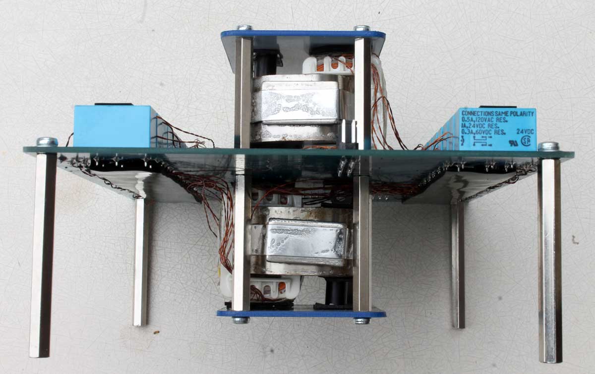

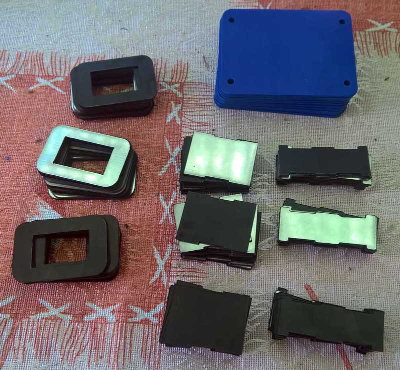

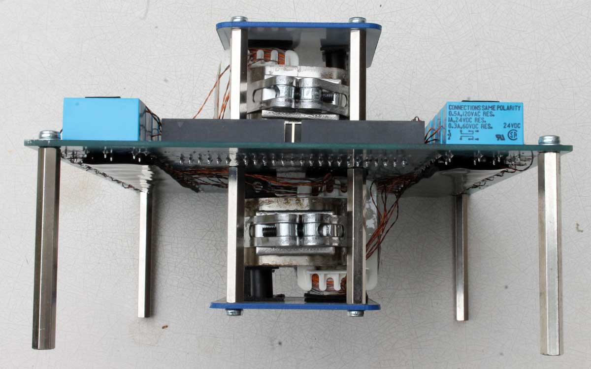

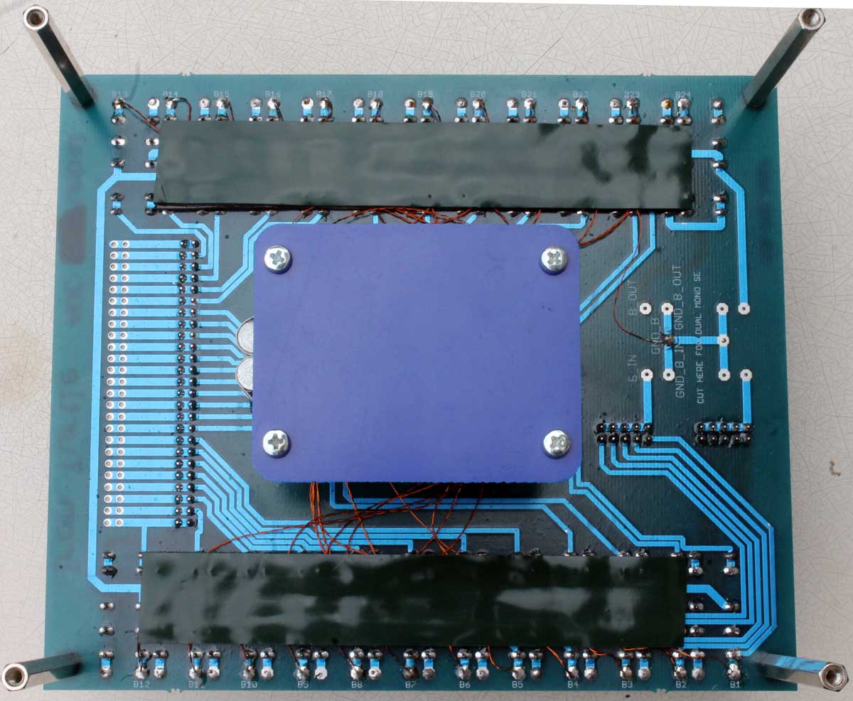

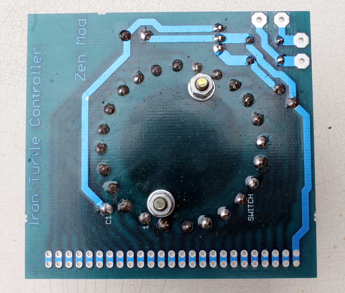

Iron Turtle details .......
if you see two Irons (pcb sandwiched in between) that's stereo pack Iron Turtle SE ;
if you see one Iron on pcb , that's mono (Balanced) Iron Turtle

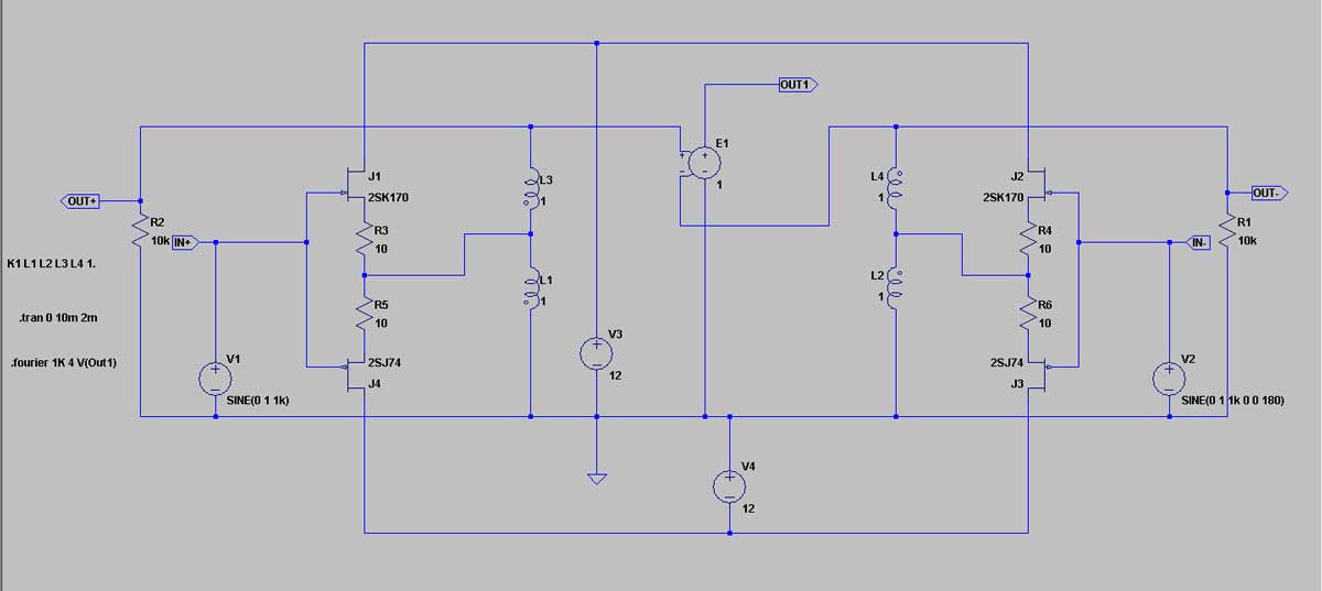

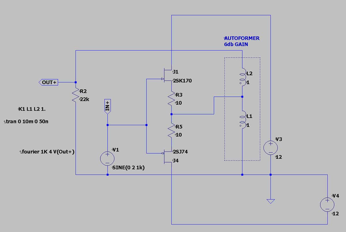

so , schm are here
both Pumpkins ( meaning - what's on electronic pcbs ) are completely compatible to be used as (still MIA) Iron Pre , not yet visible in DiyA Store
so , selector - pot - buffer - autoformer ( be it everything SE or Bal) is good and certainly cheaper way , even if definitely few notches down.
schematics are proven , so there is one (little more complicated ) possible substitution for Toshiba/LS approach.
feel free to try it , on protoboard or PtP , your choice
how it sounds ?
well - foot-tapping , music is there ..... no thoughts about spectrum dividing , music is simply there
and - I'm not responsible for that ( even if Genius) ..... that's simply nature of Good Iron
....... remember M2, F6 , Ultrasimple BAF Sony amp ?

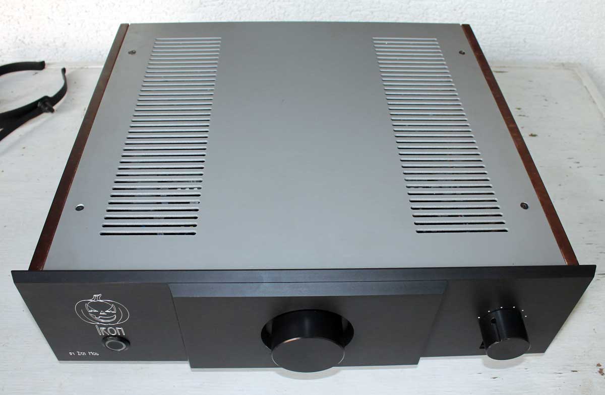

Store got Iron Pre (selector - pot - buffer - Jensen autoformer ) , both iterations - SE and Balanced
you can see details in What's wrong with the kiss,boy ? thread ....... for all details regarding time frame and availability, 6L6 is man to ask
regarding Iron Pumpkin(s) - all details are here ... if somebody is willing to make own pcbs and use whatever AVC available , that's OK with me ;
if not , everything is already available from me , as more than elaborate packages .... elaborate meaning - everything critical and tedious to obtain will be packed together
that includes AVCs , those shipped as fully assembled (on pcb) and tested units .
not cheap , but cheaper than anything on market
details to follow , not here , but in trading thread
here we are to learn and share

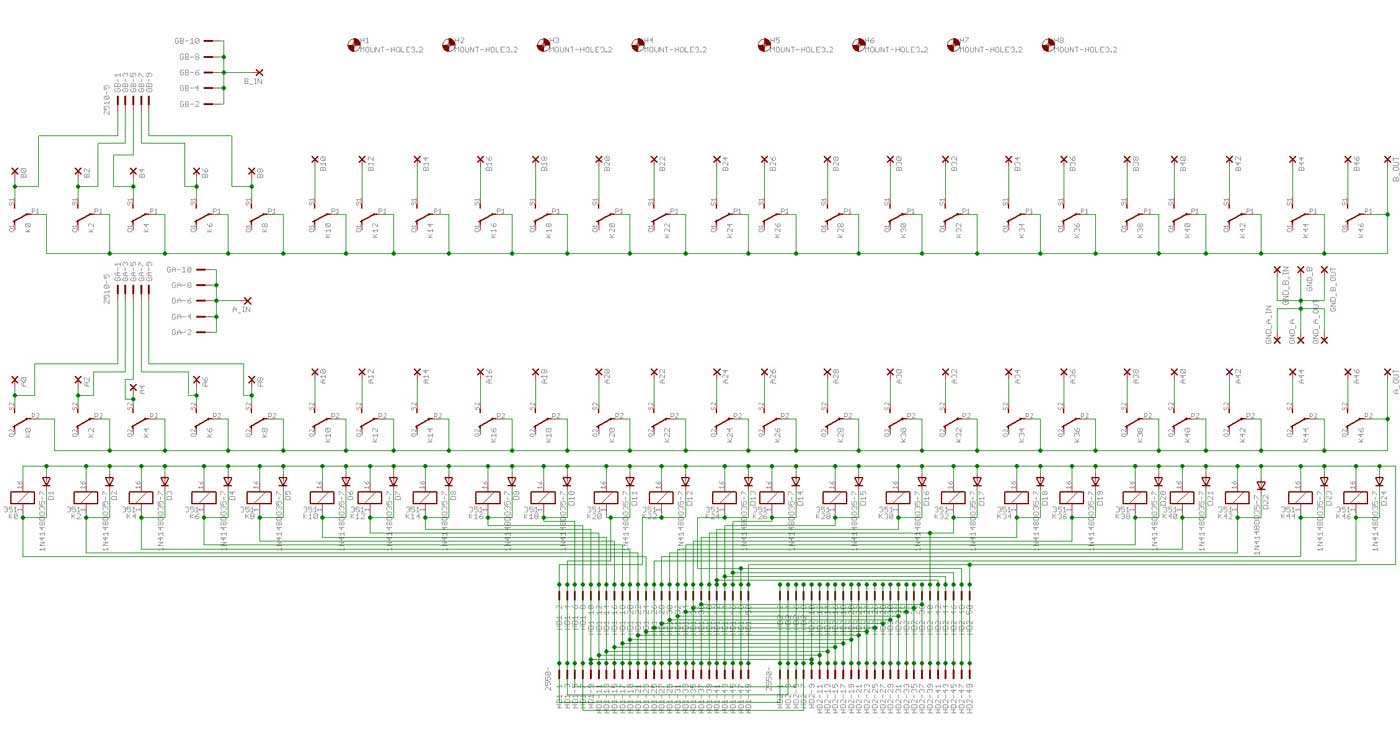

I forgot to write that down - Turtle is having 24+1 taps , where 24 being for 2db increments from -46 to 0db ,and +1 being lowest tap ,obviously for GND
frankly - I was content even with Intact's Audio 15 position/3db increment 200$ jobbies, for my needs , not being nit-picky for extra-fine steps ;
however , what I wanted -when starting from scratch- is not just finer increments and more steps,but also solution with really decent (superior?) switching , so I chose this sort of relays ....... too much Elna and Grayhill and whatever pro switches passed through my hands , needing cleaning after few years of daily usage.
smaller Takamisawa cousins are used even in input switching of MC/MM signal , in gadgets of some reputable production
I chose bigger ones , as better for task , even with price of slightly larger pcb
Hi zenmod! Looks great. And those $200 AVC's look interesting too!
With regards to the diamond buffer, what is the benefit of the current mirror over a CCS of some kind? And how did you tune it to a similar distortion structure as the jfet complementary buffer?
