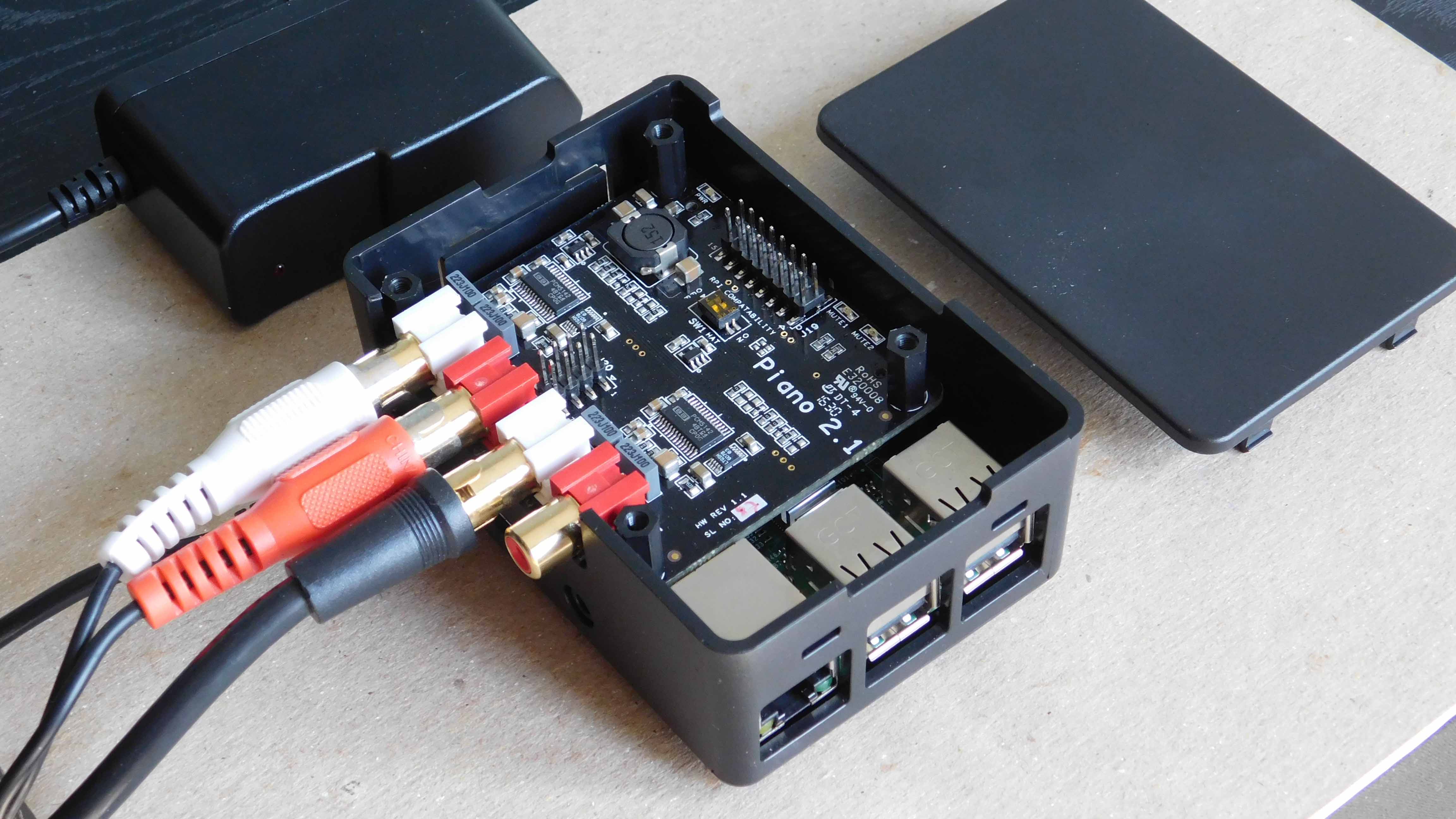

The RPI3B was loaded with Volumio2 (V2.2) , a couple of heatsinks were added, the Allo Piano2.1 DAC was installed and it's all powered by a standard 5VDC supply. The case is from Buyapi and has knockouts for the RCA jacks.
The Piano2.1 needs a couple a switches set for RPI compatibility. Easy enough.
Volumio has drivers for the Piano and the web intf has menus to select the Piano DAC and its various modes. Volumio also has many playback options and sampling features. I like it.
Out of the box, I tried configurations as both as a 2.0 Stereo and a 2.1 Stereo plus Subwoofer to see what it sounded like. Its quiet and it sounds good to me.
Everything seems to work.

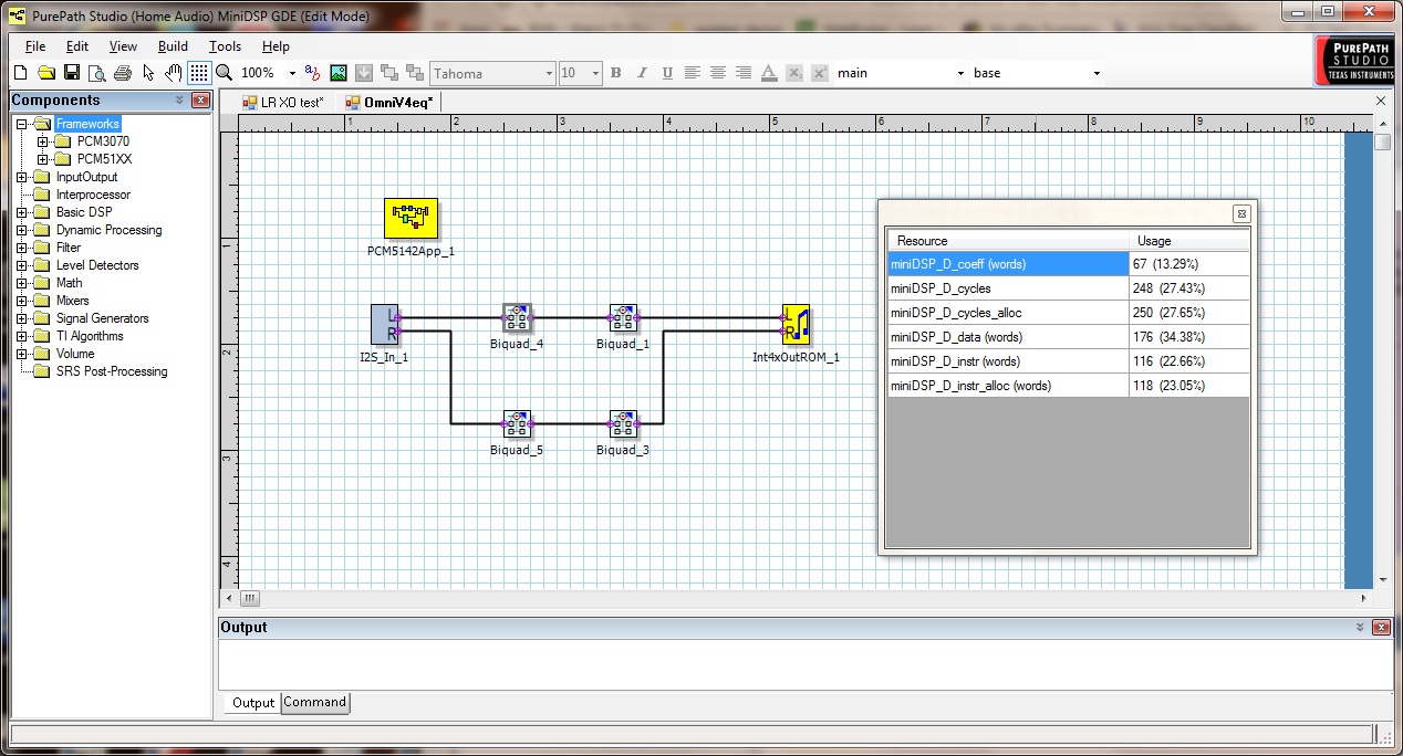

The TI PCM5142 DACs have a small DSP embedded in them. I wanted to use them for either XO or EQ to offload the RPI.
Programming the DSPs requires TI PurePath S/W. I have a free license but they are slow in handing them out :). It is an excellent design suite.
Volumio is able to upload the DSP bin files to the DACs. There are a number of DSP files already. So to make my life easy, I'll create my own program and swap it with an existing file so I can use Volumio's menus to load it.

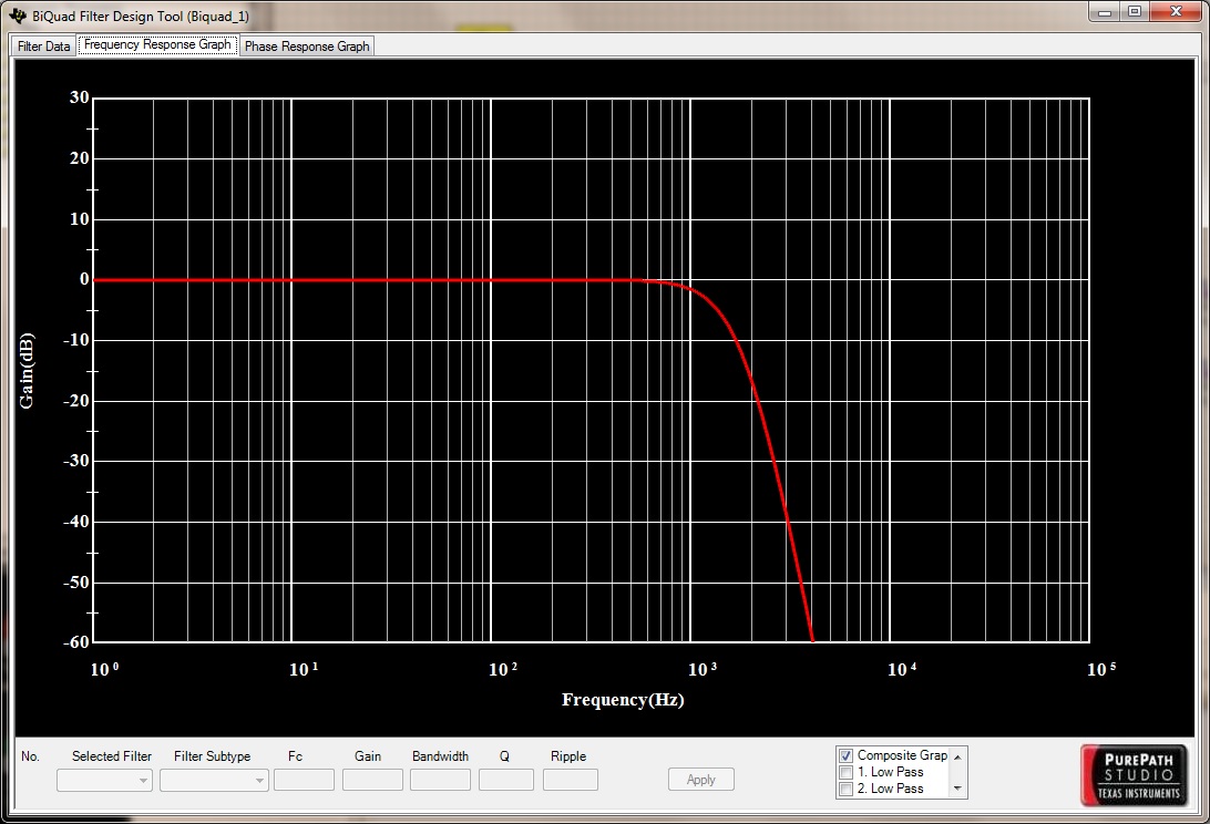

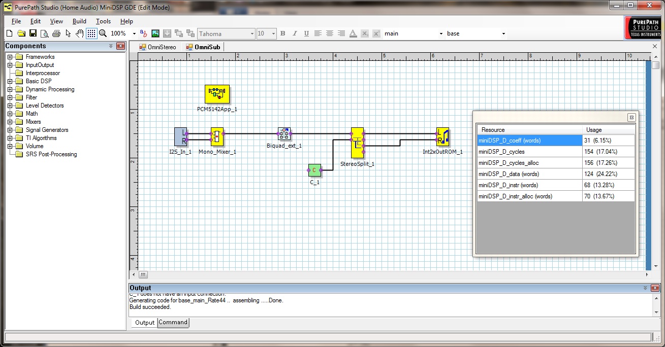

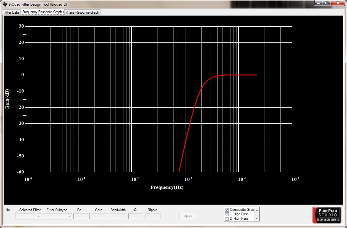

First test : I created a mono signal from the stereo, then low passed everything to the left speaker, and high passed everything to the right speaker. This was an easy way to confirm the process. The process I used was from Allo's website, only I used a Java program to "process" the TI cfg file to the required Allo bin file. This test also looks like an XO as the filters used are 8th order Butterworth.
It works properly, and only used about 25% of the DSP resources.

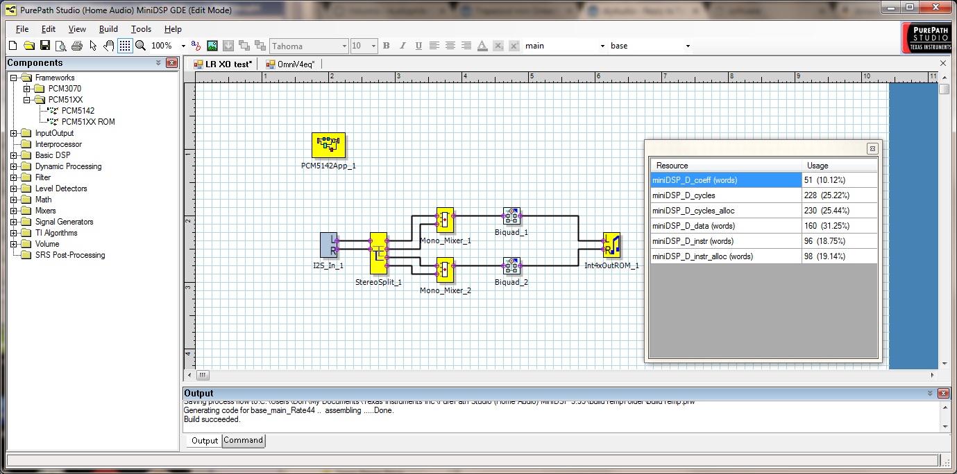

Using the DSP in the DACs - Test2
In this test, we have stereo with speaker EQ and sub support.

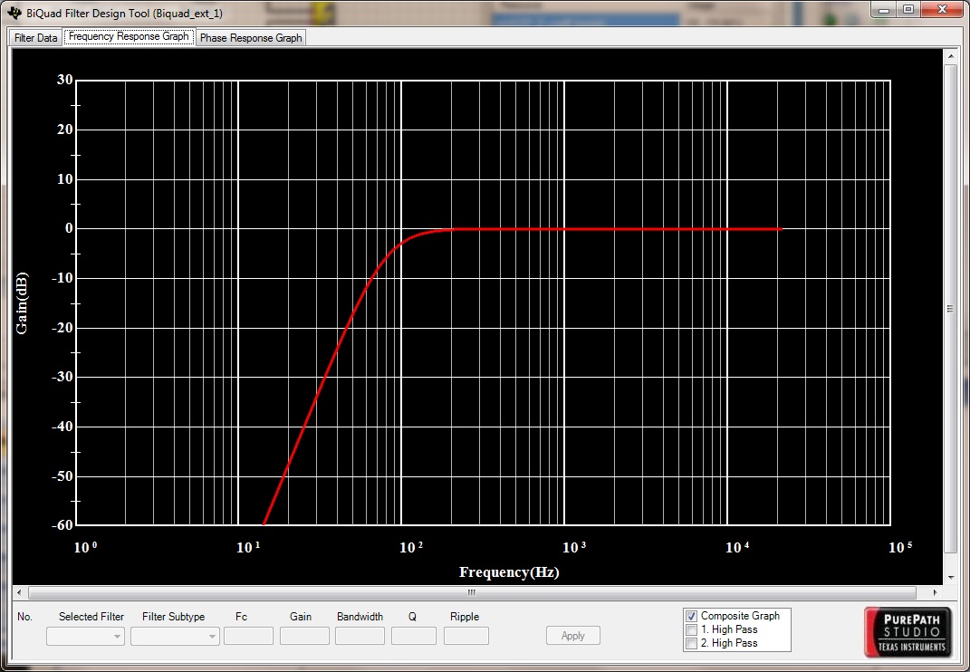

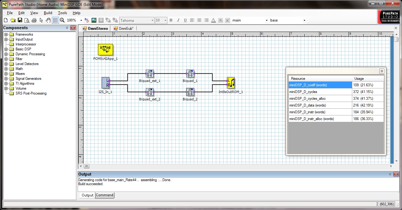

Both channels are high passed at 80Hz using BW4. The speaker EQ uses 4 Biquad EQ blocks per channel. This was a quick test and ended up being too coarse an EQ. This is a similar DSP load to the previous test. It sounded OK but needs refinement.

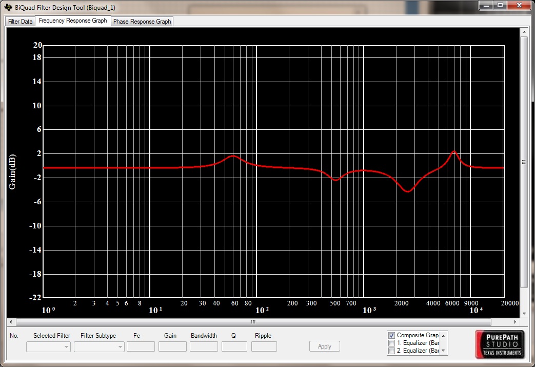

I spent a bit more time to actually finesse the filters this time.
The subwoofer channels (DAC#1) use a mixed RL low passed at 80Hz (BW4) and sent to both outputs. The difference this time is the use of extended precision in the coeffs. One of the problems with setting low cutoff frequencies in a digital IIR (biquad) is that the coefficients get close to unity (ie. 0.99999965) and preserving significance is a problem.

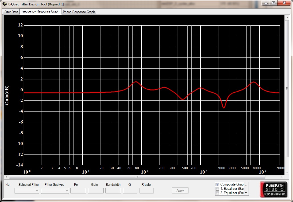

The stereo channel (DAC#0) is high passed at 80Hz (BW4) and has additional speaker EQ. The EQ curve was initially generated earlier by REW and then manually repeated here using 6 biquads. The speakers have an internal passive LR4 but the driver responses are not FR flat. This EQ curve helps that. The DSP load is at 42% utilization now.
Overall it sounds good. This means I can do active XO and speaker EQ in the DAC's DSP.
