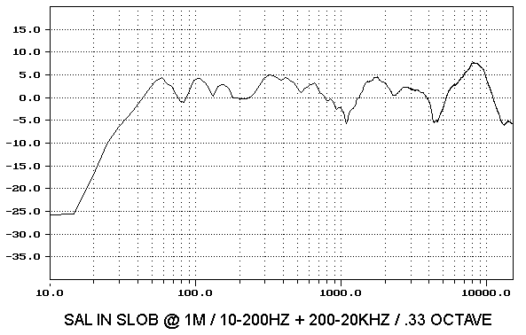

Attached is my MLSSA measurement of the most recent SAL drivers in
my SLOBs. Crossover is at 160 Hz (1 pole for the SAL), and I have applied
some baffle step of -4dB @ 2.5 Khz.
Response curve is about as good as you get with a FR driver. They are a
little less efficient than most of the top rank FR's, but for that you get more
bottom end in a sealed box, so they combine some of the virtues of the
SEAS Exotic bottom with some of the air of a Lowther / Feastrex / Voxative.
Excellent articulation and spatial presentation. They do well in either a box
or OB, and I think that they are an excellent value.
I have a DIY active OB crossover with EQ for it, and plan to offer it as a
kit in the store.

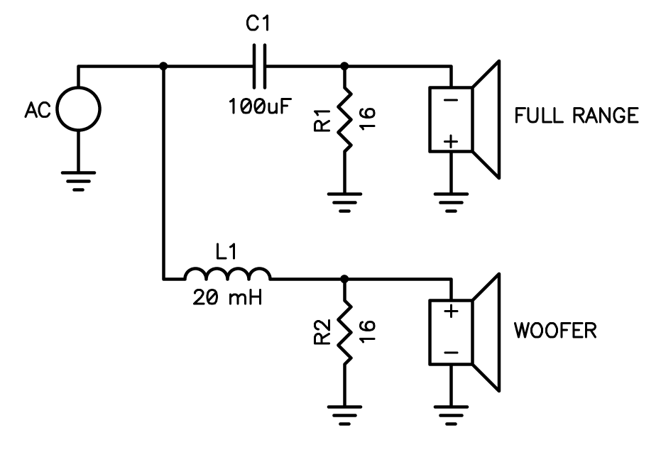

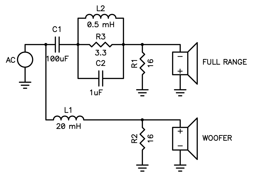

Going through my files I found a pair of passive crossover
networks I worked up in March 2016 for the SALs in the OB
with the Eminence 15's.
The pc artwork for the active filters is about done, and a
partial kit will be available through the store.
