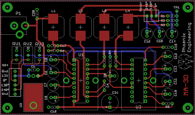

This is a shared DIY project for non-commercial use.
The MA-3D is a 3 channel class D amp suitable for driving a BLWR172S-24-2000 or BLWS231S-24-2000 BLDC motor from Anaheim Automation. The amp is custom designed to work with only these 2 motors; any other motor connected to the output of the amp can permanently damage the amp. The BLWR series has a 4mm shaft and no mounting flange. The BLWS series has a ¼” shaft and a mounting flange that matches up with a Hurst 59 series motor. There are aluminum sleeves available from the RC boat market that will convert 4mm shafts to 3/16" props that will allow the BLWR series motor to work with 3/16" center bore pulleys ie VPI 600 RPM pulleys.
This is not a universal motor controller, it will only work with the 2 motors listed above. If you decide to use a different motor, you are on your own--do not ask me how to make it work for you.
The MA-3D is an amplifier section only and requires the SG-4 sinewave generator to provide the drive signals for each phase. The MA-3D board can also supply the SG-4 with the 12VDC signal needed to power it, so only one wall adapter is needed. The 15V 1A wall adapater included in the BOM powers both the SG4 and the MA-3D. The SG-4 must have firmware version 1.03 or later to work with these motors. V1.01 and 1.02 had a lower frequency limit of 40Hz for 33 RPM and 60Hz for 45 RPM. V1.03 reduces the lower frequency limit to 1.00Hz.
The PCB uses all thru-hole components for easy assembly (with the exception of the 4 inductors which are SMT), but some soldering skills are still required.
The project consists of a bare PCB, a parts "kit" available as a shared cart from Mouser electronics and the on-line documentation you see here.
The PCB is available from OshPark PCB fabricators at the following link: [url]https://www.oshpark.com/shared_projects/mYxj6roI[/URL]
The PCB is created in multiples of 3 for a cost of ~$54 or $18/board.
The parts kit can be ordered from Mouser Electronics: [url]http://www.mouser.com/tools/projectcartsharing.aspx[/URL]
Enter the Access ID code: 90C2DDF260. The parts kit to build 1 PCB costs $55.68.
The following documentation is available below to aid in construction of the project:
MA-3D Schematic.pdf
MA-3D Parts Locator.pdf
MA-3D Assembly Instructions.pdf
MA-3D BOM.pdf (Generic bill of materials with part references)
MA-3D.zip (Gerber X274 files if you want to use your own PCB fabricator)
MA-3D PCB.pdf (X-Ray view of the PCB w/traces, pads and silk screen)

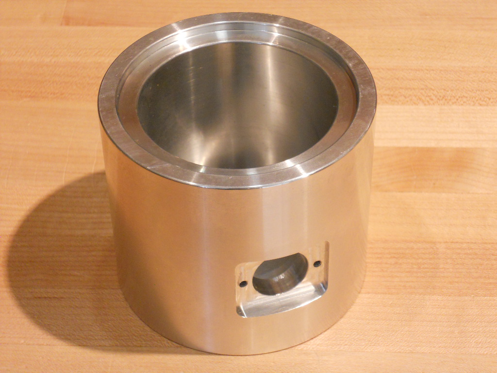

I'm also curious to know what sort of motor pod people are planning to use. I could talk to a local machinist but I wonder if there are off the shelf stand-alone motor pods that would fit the AA motors.
Thanks,
---Gary
Thanks,
---Gary
The BLWS series is essentially a drop in replacement form factor for the Hurst 59 series motors (what VPI uses in most of their tables), but the flange is thicker material so you would need longer mounting screws.
The BLWR series is smaller diameter but longer length then the Hurst motors. It is too tall to fit in the SAMA housing of a VPI. It also has a 4mm shaft and there are aluminum sleeves available from the RC boat market that convert 4mm shafts to 3/16" props that can be used to fit a VPI 600 RPM pulley.
Attached is a CAD drawing for a aluminum enclosure I had made at a local machine shop. They charged me ~$60. The case is cut from a solid aluminum billet 4" diameter on a CNC lathe.
The 1/2" NPT opening on the bottom is so the void can be filled with lead (or steel) shot when the motor is installed. There are 1/2" flush plugs available from McMaster Carr and others. The openings on the motor must be covered if you use small diameter shot pellets.
The connection to the motor is done with a 3 pin miniature mic connector. The socket and connector are available on line at https://vetco.net/products/3-pin-miniature-microphone-connector-male-female-pair.
