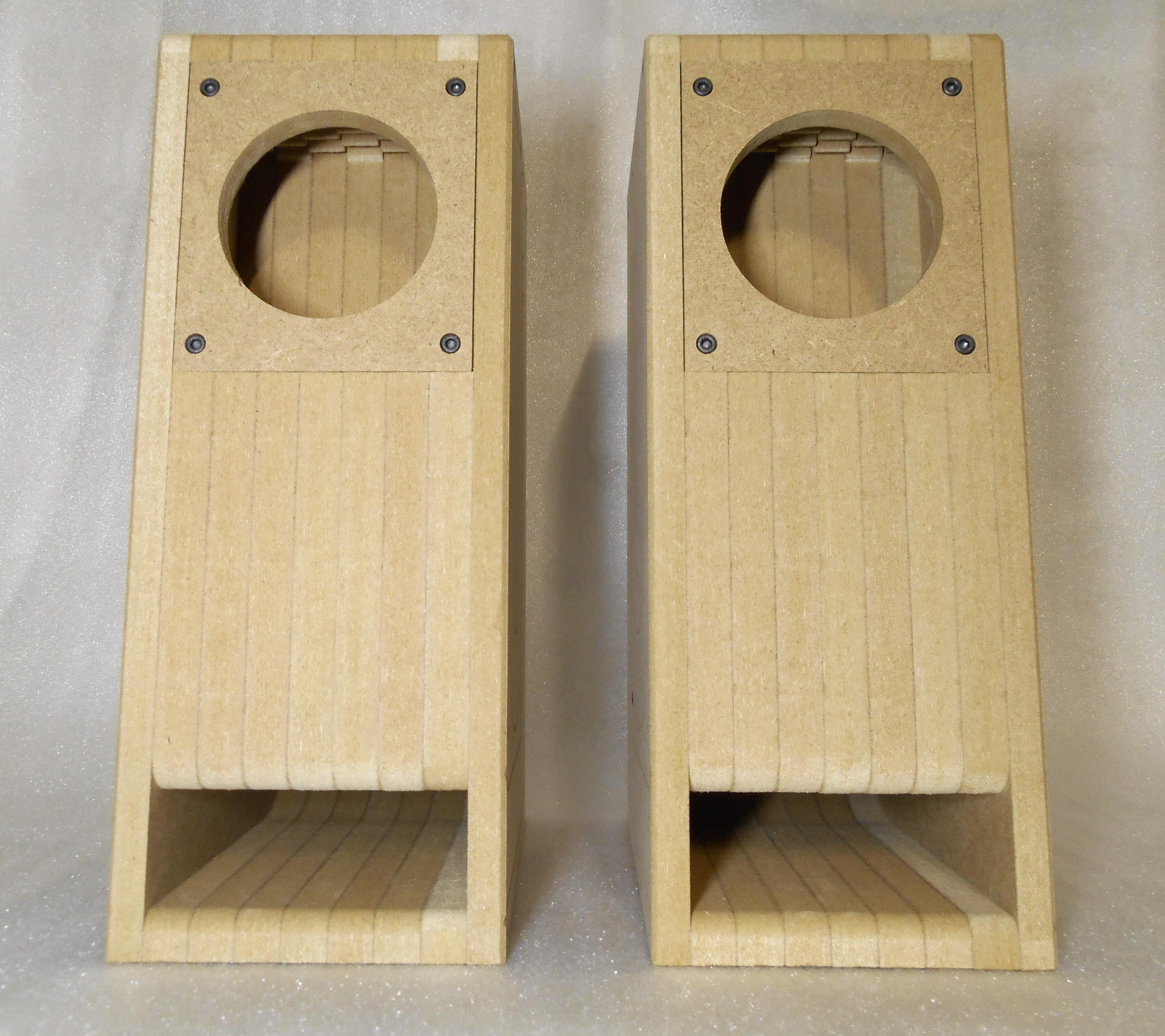

Transmission Line Speaker Build using Alpair 7.3 speakers, first build.
Wow, very nice. I'd really be curious about how they sound. I have a pair of 7.3 in the FH cabinet, but my build wasn't so great so I'm thinking of something else for them.
So, did you create a router template for the cutout and do the layers individually?
Hi Zacster, these were made on a CNC router by a gentleman in France called Christian Pop, yes each part was cut and then layered. All i had to do was glue and clamp them.
Ill post the results of the frequency response and testing i got from REW with my mini dsp mic.
But presently they sound wonderful and surprisingly the bass is clean and present!
Was this designed for the A7.3 driver or was it borrowed from the commercial one for a Fostex I have seen somewhere on a Japanese website?
Hi xrk971

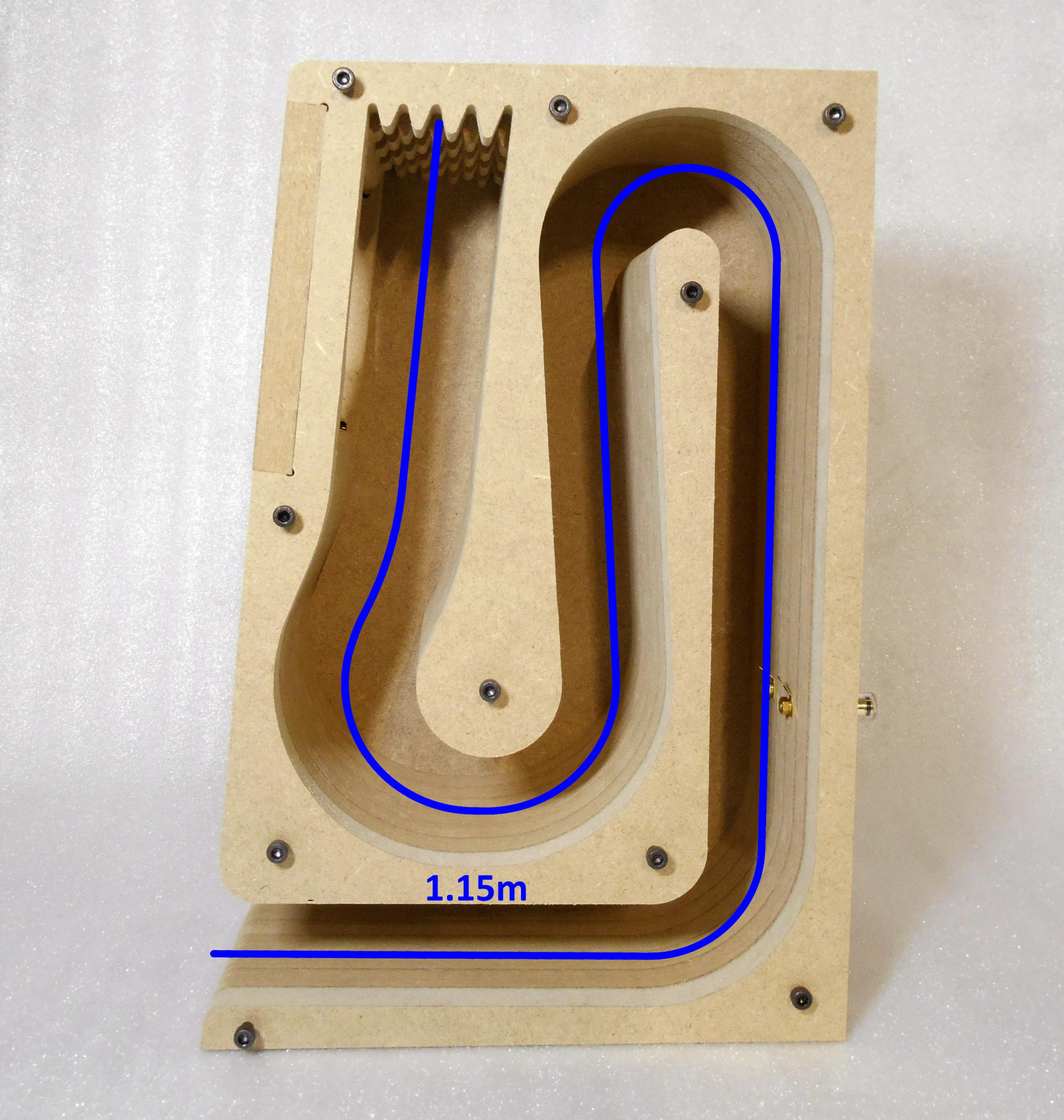

These were designed around using the Alpair 7.3, Parameters were Qts 0.4-0.6 and Fs between 70 - 80hz.
I've always wanted to try this type of design as i have built a few normal bass reflex boxes. I also wanted them to be efficient as i am using a valve amplifier with only 3.5w of power.
Not only that with the use of CNC routers makes this type of build possible and easier to construct. I was very impressed by the build, obviously it needed some work but that's the fun of it.

I'd recommend simulating this in Hornresp, just as an exercise. The peaks and dips in the measurement are all there, but slightly different shapes and sizes to those simulated.
In theory, bottom end tuning will come out in the region of 50Hz, but it doesn't look like the cabinet is helping much at all down at the bottom end.
Try measuring the driver close-in (don't let the cone hit the mic!), and then the port exit seperately. You might find it interesting.
It looks like that cabinet has been a lot of work, but I'm afraid the inherent design isn't fantastic. Smooth curves in a horn path are great for passing the midrange through, but in this case, we want the opposite: just the bass. Sharp internal angles help to form an acoustic low-pass filter that stops the midrange getting through the port and interfering above 100Hz or so, which is certainly what's happening here.
If it was mine, I'd probably convert it to a ported box, keeping the L-shaped port behind the driver, and then putting holes in that until you're happy with the tuning frequency. Longer port = lower tuning.
