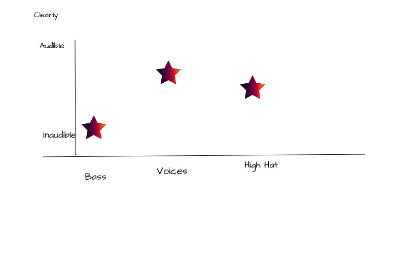

This interesting article as well as recent discussions have made me think again about how I test the speakers that I am experimenting with, and also evaulating the entire sound reproduction system.
I do not have the sensitive instruments to test my speakers, no an anechoic chamber, but this may be beside the point. I have been, after all, listening to music and testing what I hear 'subjectively'.
I have come up with some working guidelines to evaluate audio systems by ear only:
  • Frequency range - do I hear the lowest frequency and highest frequency instruments?
  • Clarity - Can I hear all the instruments playing all the time clearly. If it is a familiar track, can I hear what I hear with headphones and do I hear any detail I had not heard before?
  • Can I hear what seems to be distortion?
  • Are the percussion sounds sharp and clearly defined or sort or muffled and woolly?
  • Do I hear any unnatural (to me) colorations of sound- boxiness, sizzling sounds from the tweeters?
  • Do the music and vocals sound natural?
There are only a few high powered systems and headphones that will pass fare well in the above set of tests, so it is kind of a basic hi fi filter.
Anything more to add? It seems a good way to do things.
Joined 2015
Basic HiFI system reviewing chart
Rudimentary testing chart. Of course it needs to be refined but you get the idea. Interesting to see the variation between people who review a system using this chart to review systems.
What I have shown is what I remember from my on wall open baffle without the tweeter connected.

Attempt at actual audition in living room
Listened to this album (CD)
on the Sony reciever I have pictured in my thread, with the original mini-fridge sized speakers (Sony ES-333).
This time listening for specific instruments. This was a real eye openener - the bass is nowhere as well defined as I want it to be, and I had to listen hard to hear much of the treble - high hat, cymbals.
Also, I now notice that some songs seem to be recorded more loudly than others.
Angling the speakers in a little I seem to have built myself a nice soundstage.
All this from simply attempting to come up with a system for listening to speakers. Meanwhile my friends amp and speakers are so clear and they sound brand new.
