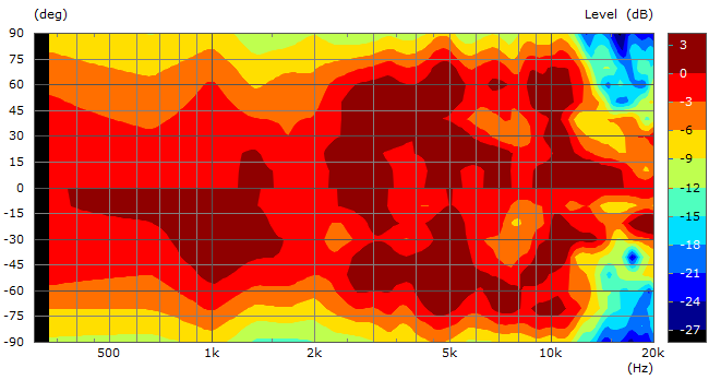

Here's a measurement of his design. Note that at low frequency, it's a straight line array. At high frequency, it's a Bessel array.
Note that the response is not flat. One might use the design 'as is', perhaps they'd like the bass-heavy sound. Another option is to flatten out the response using an equalizer. One 'neat' thing about this improved array is that it would have significantly higher output potential than a conventional Bessel array, due to the higher efficiency at low frequencies.

Here's the polar response of this array:
One thing to note, in all of these polar plots, is that the array is oriented vertically. But this array type is really intended to be flipped on it's side. The entire point of these patents is for soundbars. So if you've been thinking about building a 'soundbar' type of speaker, this could be a great option.
