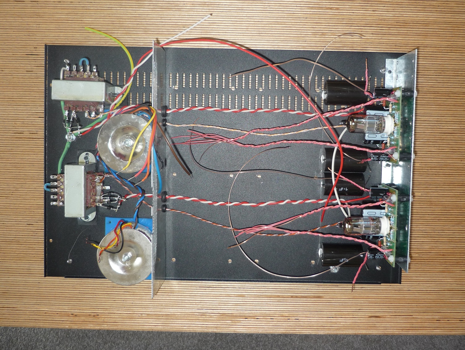

andyr 19th October 2017 06:55 AM
1 Attachment(s)
Pic is here ... the space in the middle is for my 2 RelaiXed PCBs - which give me an 8-channel, digitally-controlled analogue volume control.
These 4 channels are for mids & ribbons - they are fed by one of the Relaixed boards. Subs & bass panels are fed directly from the other 4-channel Relaixed board.
Andy
AKSA 19th October 2017 10:19 PM
Hi Andy,
I can see the custom EI transformers set up for the two TLP - four channel - preamps, what are the toroids being used for? Smallish, too, maybe 25VA?
Hugh
andyr 20th October 2017 05:08 AM
Quote:
Originally Posted by AKSA (https://www.diyaudio.com/forums/aksa/299013-aksa-tlp-solution-digital-issue-post5218310.html#post5218310)
Hi Andy,
Hugh
Hi Hugh,
Each powers 1 RelaiXed 4-channel volume control board. Yes, I think they are 30VA.
There is a 3rd small toroid mounted on the case side - this powers the digital control circuit.
Andy

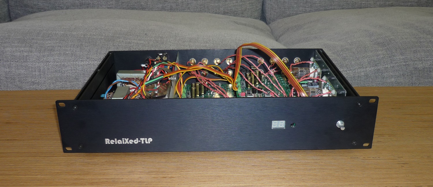

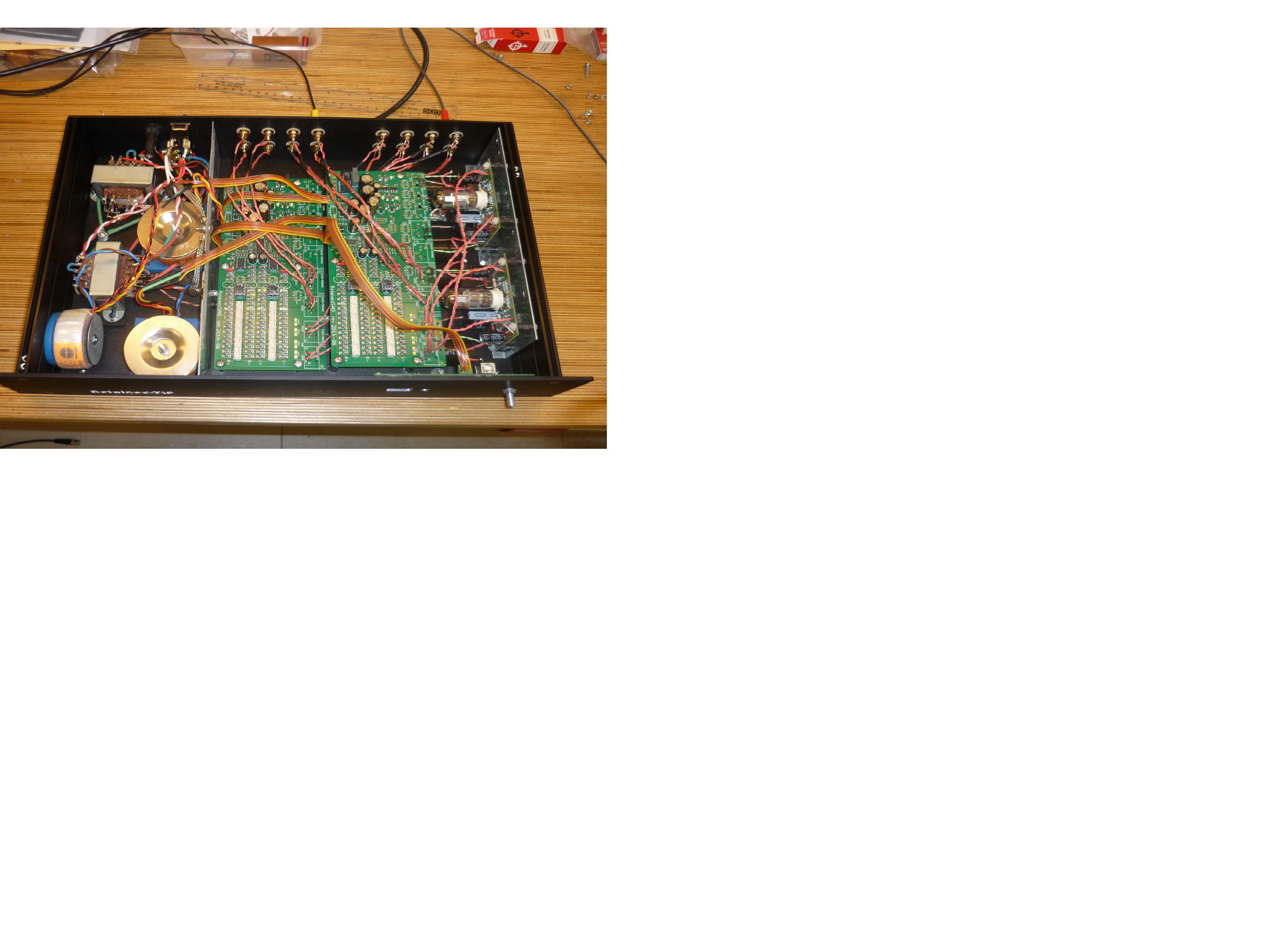

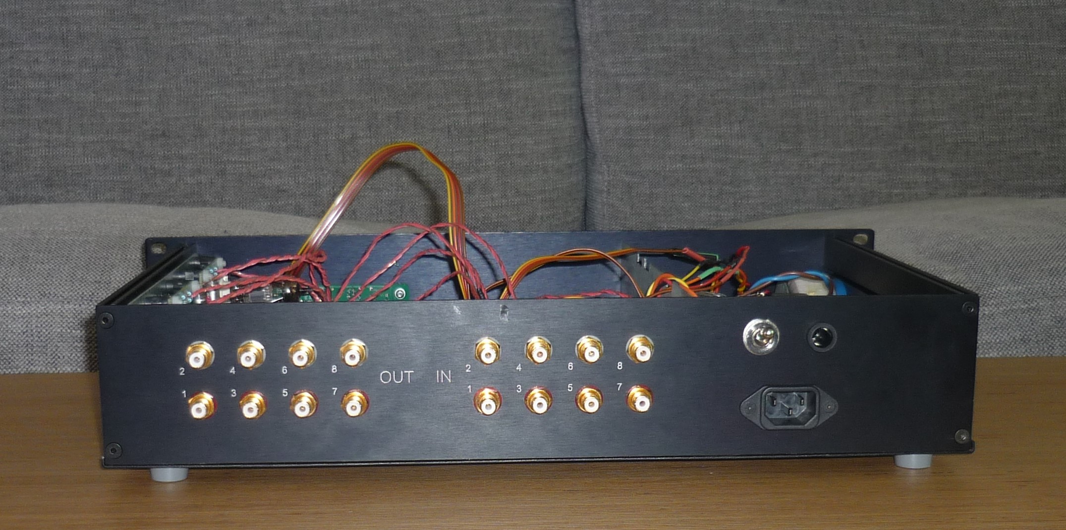

andyr 13th February 2018 05:43 AM
3 Attachment(s)
Quote:
Originally Posted by Fitero (https://www.diyaudio.com/forums/aksa/299013-aksa-tlp-solution-digital-issue-post4892590.html#post4892590)
I am curious to learn your impressions.
Well, it's taken 14 months - not 6! :( - but I finally listened to the new setup, yesterday! :D
First impressions are:
* it sounds great! :)
* but I can hear some hash on the mids & ribbons - not hearable at the listening position but certainly noticable when your ear is right at the driver. I was afraid this might happen so I think I know how to solve this problem. (Put an earthed shield over the 6v & 15v feeds from the power transformers that run close to the I/O wiring, on the other side of the steel divider between transformers and signal boards).
Monday is the "real test" - when my panel of 'golden ears' (including Hugh) comes round for a listen. :)
Pics attached.
Andy
