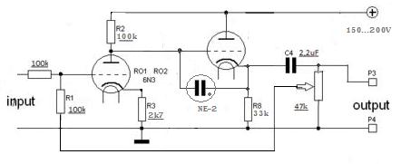

Dear Folks,
Does anyone do this 6N3 based preamp can share the schematic ? My friend give me 4 these tubes. I want to DIY the preamp and use in between the DAC and Power AMP (FET)
CK
Why make it more difficult than nessesairy :confused:
Like this you can adjust the gain between 0 and ~20dB (1x...10x)
The Ne bulb is to prevent high voltage between cathode and grid at start-up.
Mona
