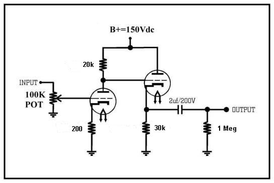

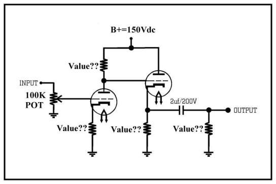

2 Attachment(s)
Trancy,
Attached is a cathode follower followed by a common cathode stage. I was told that tubes such as 6DJ8, 6922, ECC88, 6N1P can be used for such a configuration.
Federico,
Would it be possible for you to provide values for the resistors using 6N1P and ECC88 tubes? I have a couple of 6N1P sitting here waiting to be used. :D
Thanks!

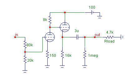

fscarpa58 4th March 2004 12:53 PM
2 Attachment(s)
Hi trancy
Sorry for the delay, but yesterday
I had not success in connecting
to the forum.
here is the pic
ciao
Federico
fscarpa58 4th March 2004 12:59 PM
JojoD
what is the input resistance of the amplifier?
( I am supposing that this is a preamplifer
which will drive an amplifier)
ciao
Federico
