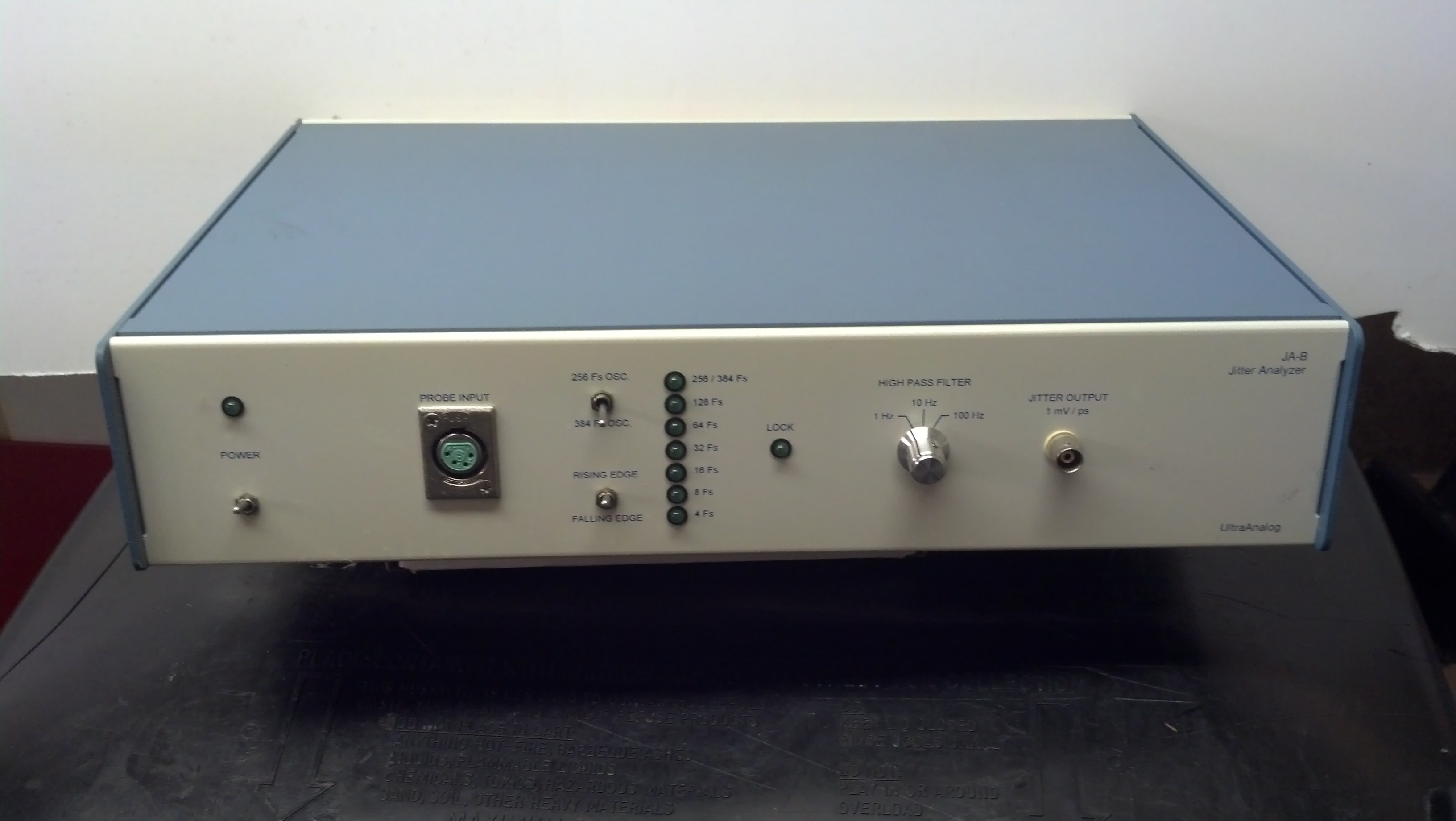

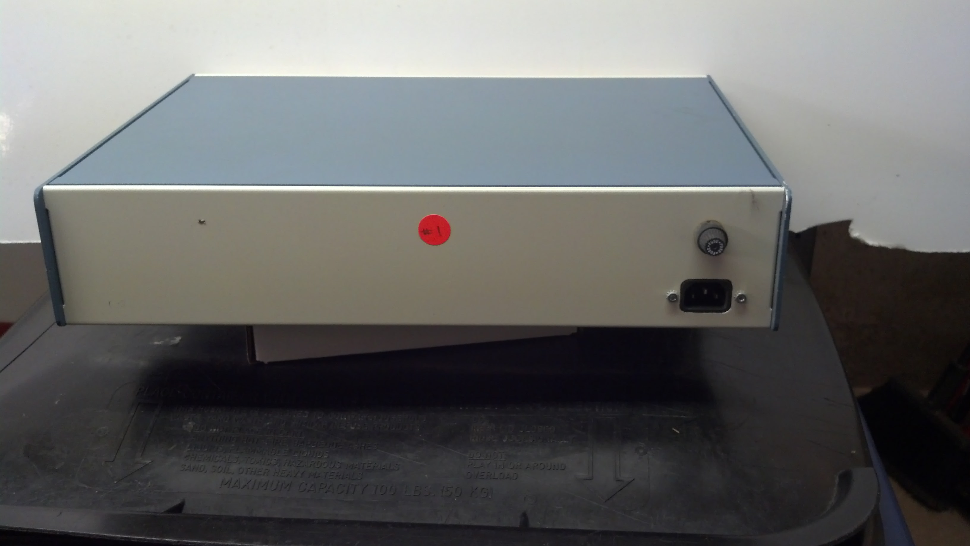

A long time ago I acquired this UltraAnalog JA-B Jitter Analyzer. I can find ZERO Information on it. Does anyone recognize it? have any info on it? It may have been custom built. I have it listed FS on eBay but I have very little info about it.

That goes back to the dawn of digital audio. It really does work for 44.1 KHz. Its based on the standard jitter analysis system used in industrial environments. The core is a Crystal receiver and a good VCO as I remember. You won't find much on it anywhere.

I purchased the unit - but not had time to look into it much.
Its missing the input probe, and from what I can see the probe converts the Logic clock signal to Balanced Logic levels terminated into 75Ohms at the analyser.
Maybe the Probe head used a pair of Simple XOR's - the odd thing is that the analysers input circuit is not truly balanced - but one of the 'Differential' inputs is used (selected by the Edge Switch) for measurement... Really this should be a truly Differential input circuit - I might design and modify the unit - once I design a suitable circuit (Low noise).
BTW - this is the "Clock Analyser" not the SPDIF analyser.... and yes its only for 44.1KHz based signals, but still useful and can be extended with a little modification.

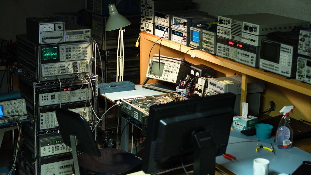

I have same here, although most of it has been re-purposed;)

Brilliant :) yes indeed, originally I had a 89441A in the rack but replaced it with the 3561A as the 89441A is more useful on the lab bench - nice lab you have there.
I'm always battling trying to measure Phase noise across the Audio Bandwidth ""Offsets" with adequate dynamic range.. hence the interest in developing such a unit...

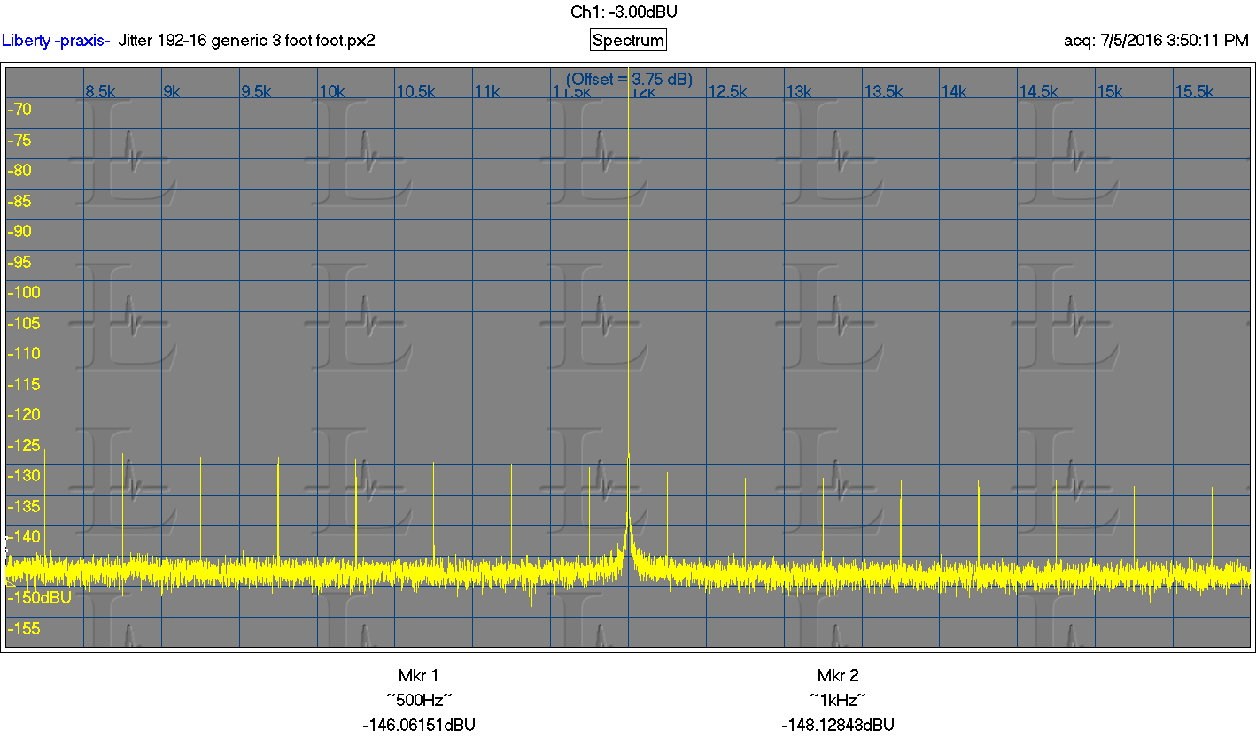

Probably looking at the output of the DAC will show what is actually important. Looking upstream is good for finding sources of problems but if its not in the output of the DAC its probably not important.
For example, this is the output of a very modest ($70) USB DAC I got from China via eBay. Its the usual 16 bit Jtest presented similarly to Stereophile. This analog output is virtually identical to a pure digital link with no jitter. In this case I'm not sure what is to be gained from lower jitter.
