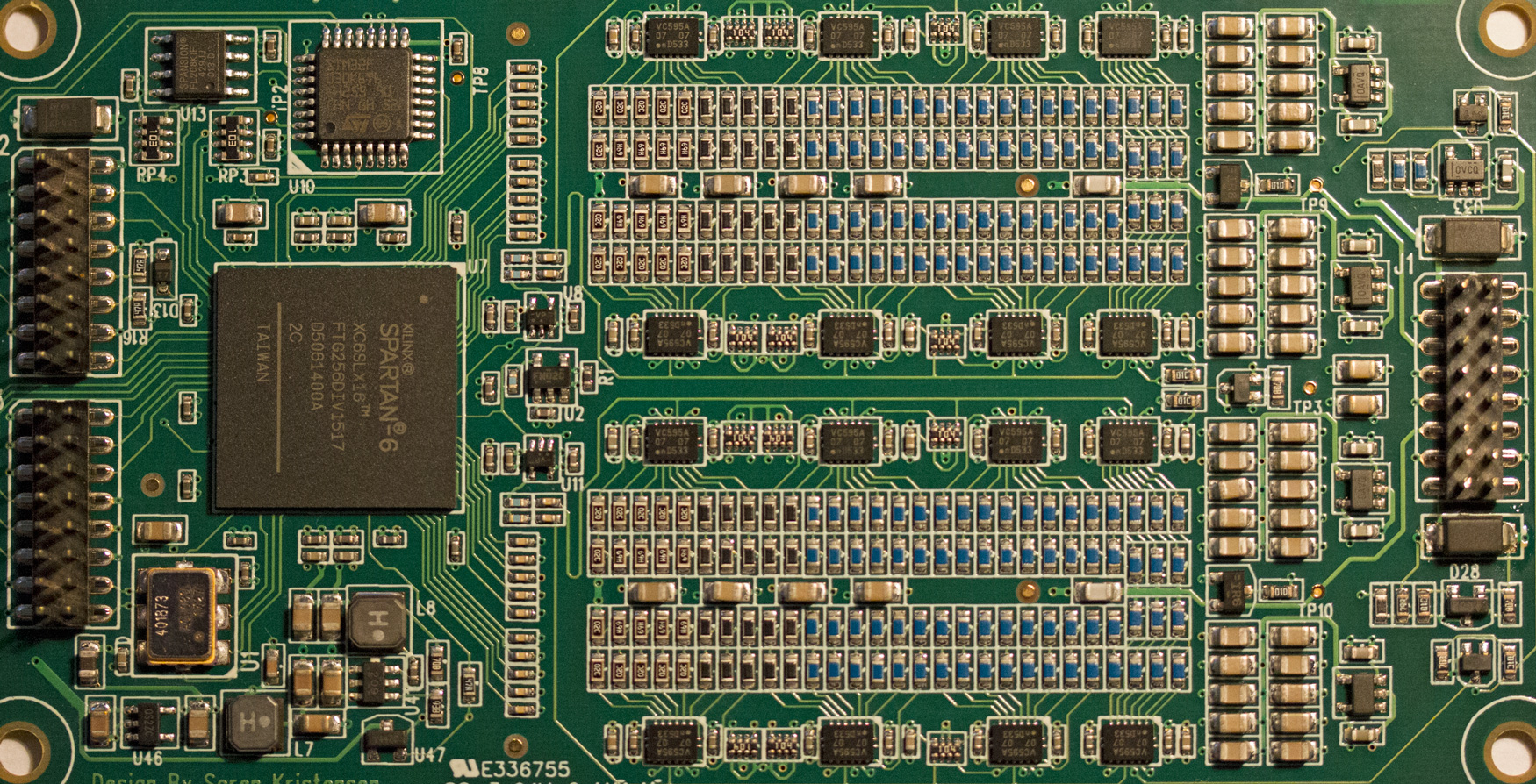

Took delivery of 2 pcs. Small board :) - now wait for the rest of the needed stuff.
