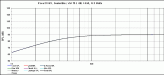

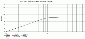

JdAo,
The fact that you have read here or somewhere else these
conclusions does not guarantee its validity. People make mistakes,
including me.
We know for a fact that loudspeaker's measured behaviour can be
presented in the frequency domain using an appropriate algorithm
for an easier interpretation. The shape of the time domain curve
depends on the signal it represents. If it doesn't contain higher
frequencies, the first peak appears to be dulled or if there is not
much low frequencies, then the impulse appears to be shorter.
Lower frequencies have greater time period and this shows in time
domain. I have included simulation graphs so you can see how a
different box volume(tuning) changes both the time and frequency data.
Ringing appears to be an issue when the FR becomes so exaggerated
that it sounds boomy.
