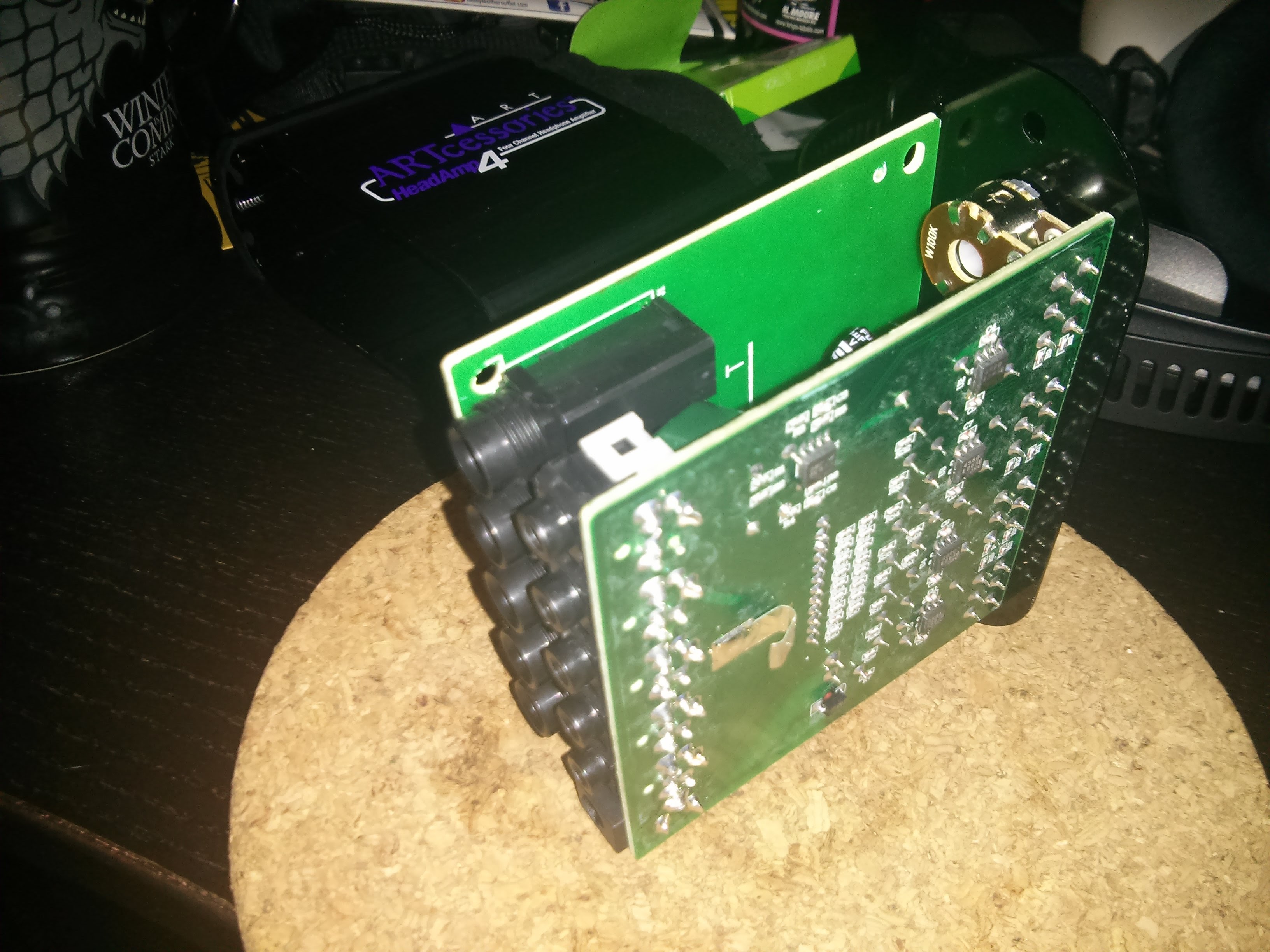

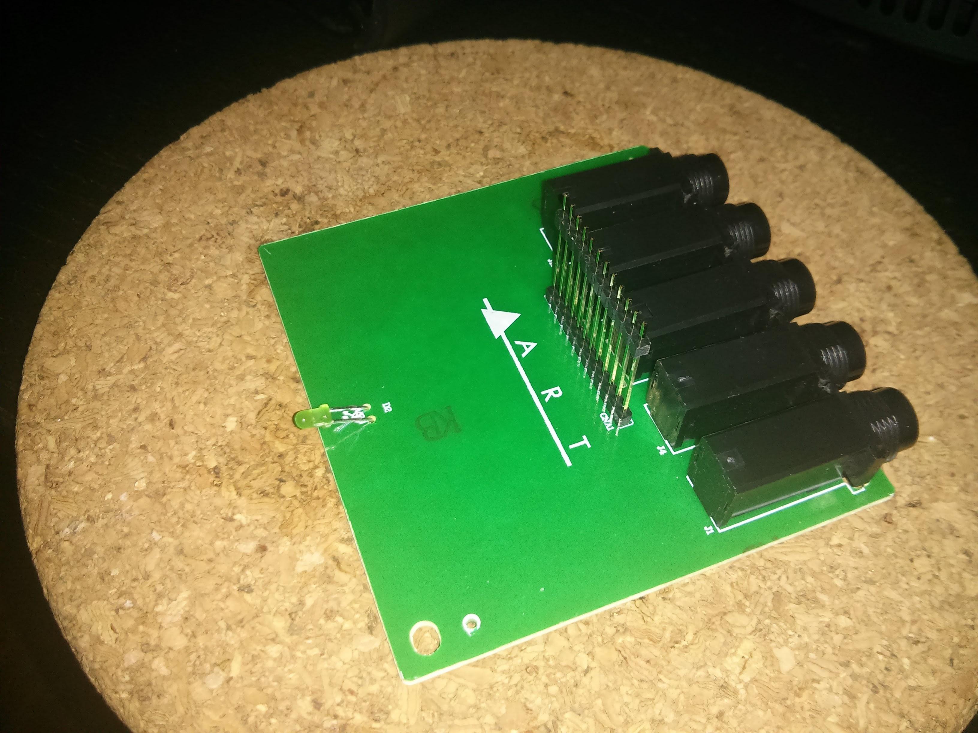

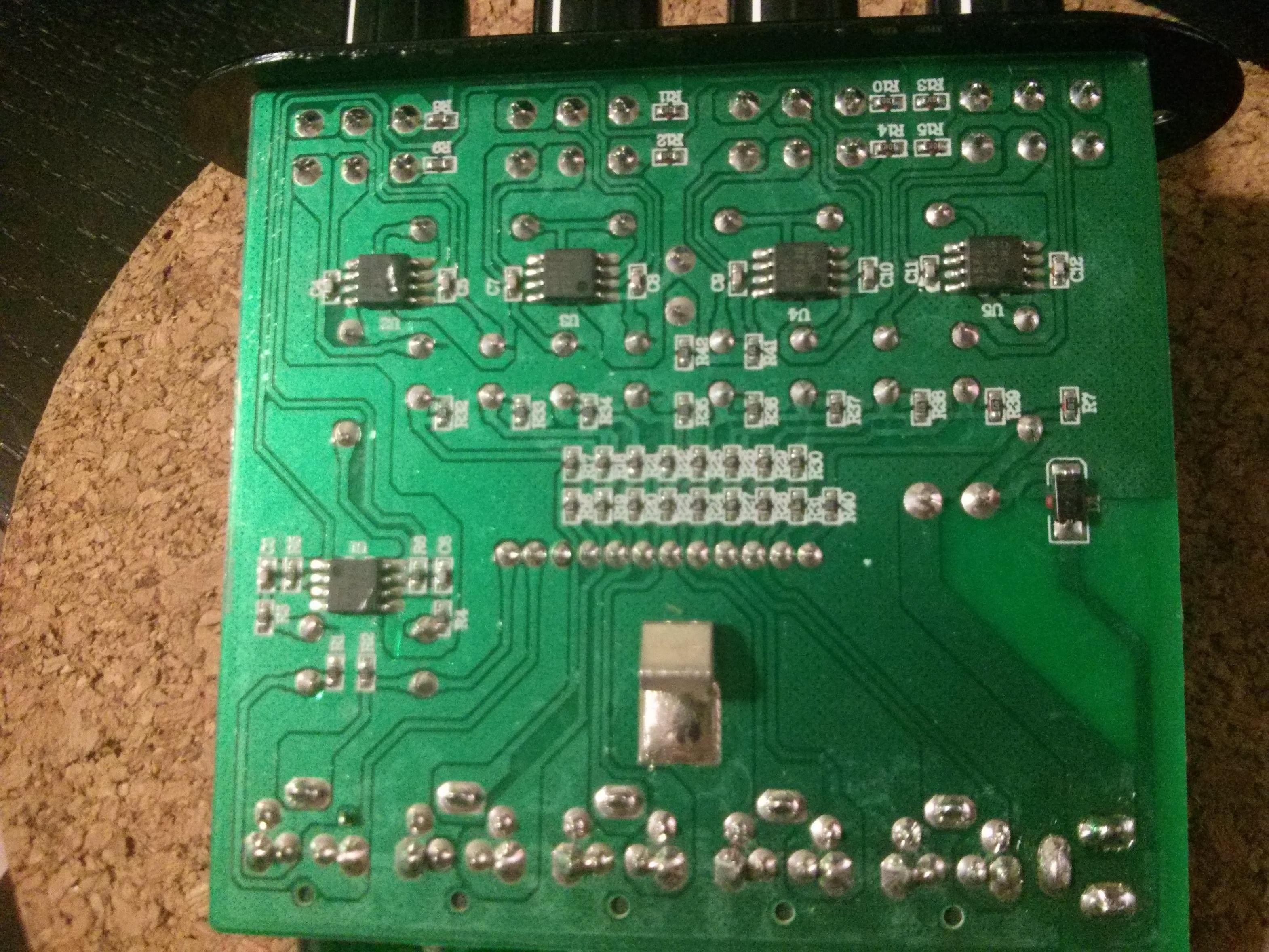

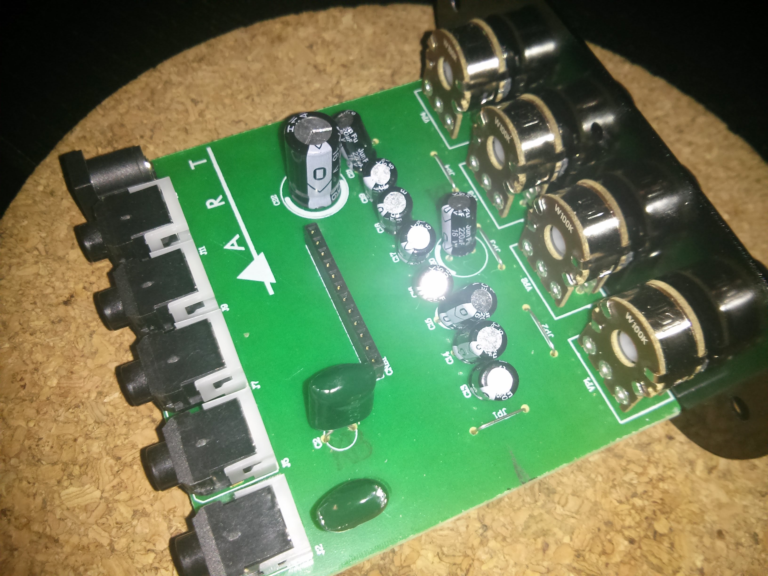

sgrossklass 1st November 2015 01:07 PM
That's the ART HeadAmp 4, if I see that correctly? Would you mind opening it up and taking a few photos of the insides? I've never seen any, and from reviews I suspect it uses a MOSFET SE Class A buffer or something like that.
For the R70x you could get away with as little as a 2x 9V cMoy (*) even if you're not a quiet listener like me. Half-decent voltage swing, not an awful lot of current needed, output impedance under 100 ohms should be fine. The kind of stuff that works well with other 250-600 ohm cans.
*) Note that some changes in the virtual ground/power buffer setup are recommended in the 1x 9V version, as that has lousy PSRR stock.
Jekotia 1st November 2015 11:36 PM
4 Attachment(s)
Quote:
Originally Posted by sgrossklass (https://www.diyaudio.com/forums/headphone-systems/281672-amp-connecting-ath-r70x-pc-post4502174.html#post4502174)
You are correct. We tend to call ART products Yorkville since that's the parent company, and ART product arrives with our nightly Yorkville shipment. Rambling aside, here are the pictures!
https://www.diyaudio.com/forums/atta...1&d=1446423706
Both PCB's "stuck" together
https://www.diyaudio.com/forums/atta...5&d=1446423697
Top of lower PCB
https://www.diyaudio.com/forums/atta...4&d=1446423697
Bottom of lower PCB
https://www.diyaudio.com/forums/atta...3&d=1446423697
Bottom (when considering installed orientation) of upper PCB
Didn't snap one of the top side of the upper PCB as it was just traces & solder.
A bit off-topic: if there's common interest in seeing internals for other ART/Yorkville product, just let me know. I work at Long & McQuade, which is the retail child company of Yorkville. I have access to a lot of used equipment that no one will mind if I pop open and snap some pics. The same can be done for some other brands, but the majority of our used product is Yorkville, since we offer equipment rentals (easy access to repair parts, since not all customers treat the gear with care). I work in receiving, not sales, so hopefully I'm free of bias.
sgrossklass 10th November 2015 07:52 AM
Cool, thanks. Looks like a bunch of 4580s for the output plus whatever that is on the input (the interesting stuff is blurry, of course). Reasonably standard single-supply circuit I'd say (much like I'd do it), similar to but less cost-cutting focused than the Behringer HA400. It will appear the output stage is inverting with the pot being the input resistor? Not entirely sure what would give it its "character" (apparently it does not become entirely unpleasant when approaching clipping like other cheap amps usually do). Even-order distortion due to power supply sag?
