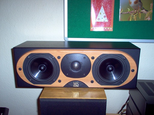

The commercial guys usually do a 5" 4 ohm polycone, with a simple crossover as in the Epos ELS-3. I like these sort of phase-plug polycone woofers. In fact I have a couple lying about as in the last Mordaunt Short centre speaker image. Really must do something with them. :eek:
