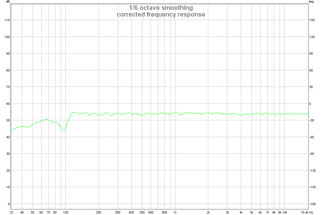

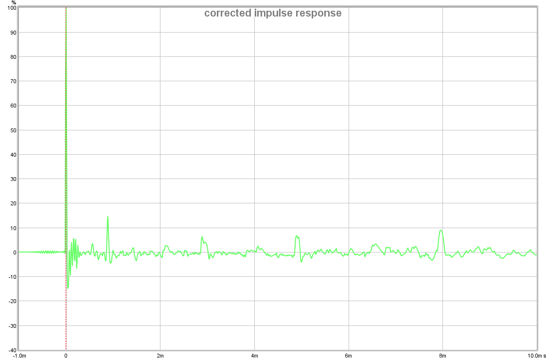

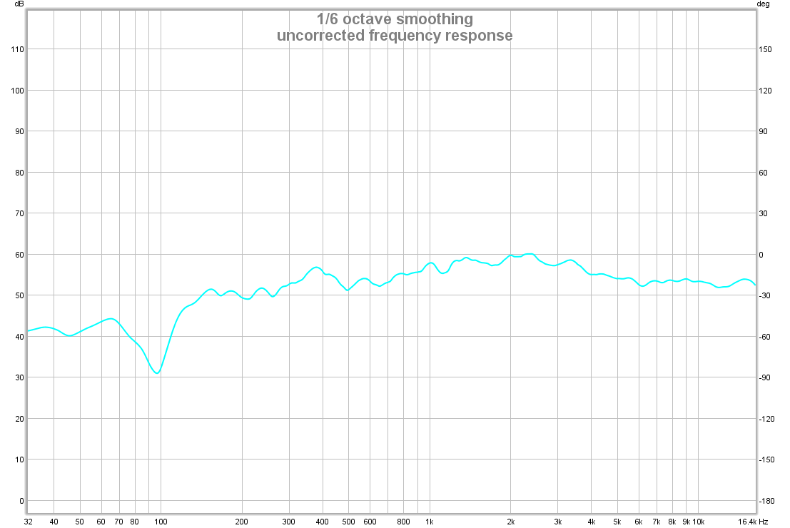

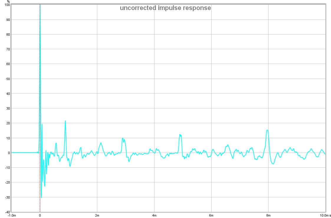

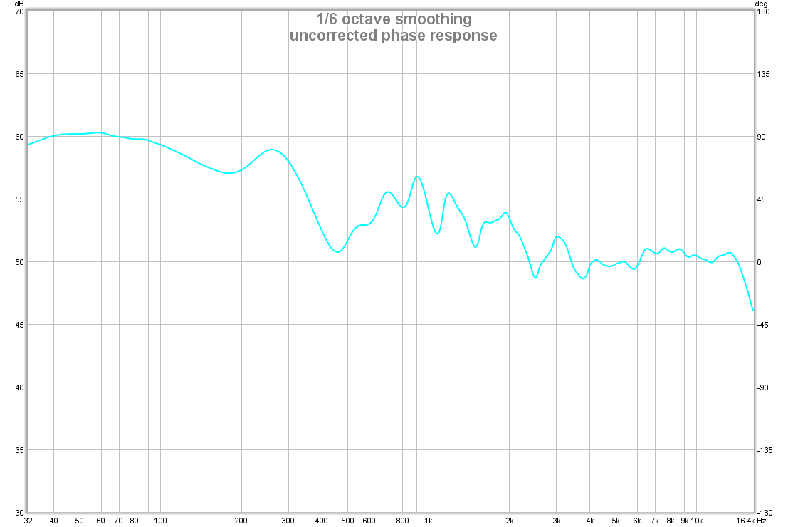

example result
Attached are some graphs showing the response of my left speaker (a small single driver hypercube speaker) from the listening position both before and after correction with the 4cycles filter (using the supplied highpass target file). The phase plot was done with a 6.5ms window to highlight the direct sound. There is no electrical network used for the speaker; the amplifier is connected directly to the speaker terminals.

That's the windowing from a normal template using 10 cycles. Do you want to output the result of that windowing (obviously with different parameters) to a wave file? I took the normal template as an example because that one uses 10 cycles of correction.
That allows you to see the input in DRC is in samples.
10 cycles at 20 Hz = 500 ms = 22050 samples.
No problem. I saw X's post about adding pictures and I had already started something like that, so I finished it and posted the "Get started" guide.
I did have a look at your package. Tried to figure out how to use your scripts with DRCDesigner, and this is what I came up with:
I used the preset "strong-44.1.drc", opened it, deleted everything (but kept a duplicate) and copied over the content of the script "4cycles-44.1.drc" into it, then saved.
Now, opening DRCDesigner, I made my target curve and selected Strong in the presets, then generated the filter. That should give me a filter based on your 4cycles script, right?
It's too late tonight to test out the filter. Will have a listen tomorrow.
