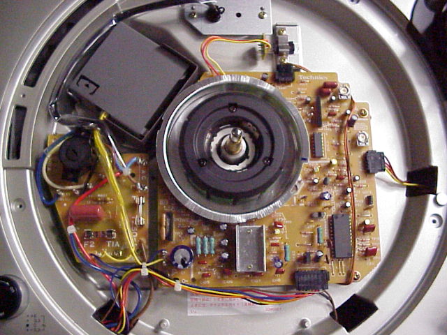

I don't know the SP10 but if it has the same electronics as the SL1200 I could maybe help you.
If not, ignore this post.
/Hugo :)
