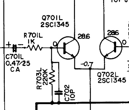

calculating high-pass filter for these components
I understand that the formula for determining f3 for a high-pass, CR filter is 1/(2 Pi RC)
(please correct if that is not right)
The sample given in Horowitz and Hill does not have the resistor in series with the capacitor, i.e. the 1k R701L. That is what is confusing me.
Q: What would be used for R to solve the equation?
Q: R can not be R701L alone, because the result would be too high. But does that resistor have any effect on the f3 value?
Q: Is there a low-pass filter here too? What is the function of C702?
thanks in advance...

The low pass filter is the 1k and 10pF.
The high pass filter is the 0.47uF and 220k.
It's a little confusing when they're combined as shown.
The low filter is far apart in frequency from the high filter,
so you can neglect one filter's parts when calculating the other filter.
Thank you rayma
I calculate the high-pass f3 to be around 1.5Hz
I have read elsewhere that high-pass to amp inputs are generally kept below 5Hz, so this example is well below that already.
Would there be any harm in increasing C701L to 1uF? That would decrease f3 to around .72Hz

Yes, the formula works for both the high pass filter CR and for the low pass filter RC.
These are passive single pole filters.
Your 0u47F + 220k has F-3dB= 1.54Hz. The F-1dB is ~3Hz. A scope would show a 10% drop in output at ~3Hz.
The RC time constant for your 0u47F + 220k is 0.1034seconds (=103ms). This is a very convenient way to compare filters.

It's not quite as simple as that. There may be some Miller capacitance to add to the 10pF. There may be some BJT input resistance to add in parallel with the 220k. In each case it depends on the rest of the circuit, so the effect could be negligible or significant. Also, there may be some source resistance to add to the 1k.
Just trying to keep things simple for a beginner.
