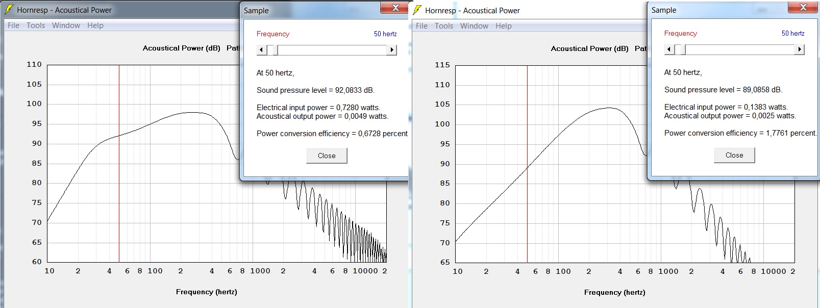

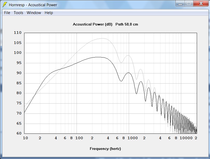

Maybe we could take this 15" woofer - Two in series = 8 ohm. Can you identify something that will not work, or is not optimum.
SPL15.1
Revc = 3.6 Ohm
Fo= 30.642hz
Sd= 779.310 CM Sq
BL= 12.970 TM
Qms= 6.151
Qes= 0.748
Qts= 0.667
No= 0.477%
SPL= 88.8db
Vas= 128.173 Ltr
Cms= 148.624 uM/N
Krm= 9.174mOhm
Erm= 0.777
Mms= 181.61g
MMd= 169.006g
Kxm= 47.238mOhm
Exm= 0.657

I need to find a +90 dB woofer with fs below 30 Hz high excursion and a Qts around 1. I still need to play with some simulators.
I'm still not sure about the importance of Qms and Vas (what does a very low Vas do compared to high Vas in an open baffle)

That sounds as if you tried to go very low.
IMHO, there is little point in trying to play 30Hz through OB in an acoustically small room. In theory (which typically assumes free space !), you can get it with enough driver area, Xmax and amplifier power. In practice, a normal living room induce very significant additional boundary losses below lowest mode (dipole can't pressurize the room). See: Boundary effects
Later edit: this also happens to be one reason why OB bass is hard to get right. At the end of the day, in-(your)-room equalization is going to be the only accurate way.
40Hz is a more realistic target - and for some people, like me, quite enough for music. If you do movies, multiple subwoofers are your friends.
Quote:
Originally Posted by Kjeldsen (https://www.diyaudio.com/forums/multi-way/269676-baffle-woofer-post4221779.html#post4221779)
I think Vas has in itself less relevance in OB context, because Vas is a measure of equivalent air compliance that determines the a driver + enclosure Fs and Q. For OB, there is no enclosure. See this discussion: http://www.diyaudio.com/forums/multi...-question.html
Thiele/Small parameters are not independent, but interrelated (Thiele/Small - Wikipedia, the free encyclopedia).. Vas is given by the driver's stiffness and the latter is linked to the driver's Fs via it's mass. In the context of open baffle, it makes more sense to look at things from Fs and Qts perspective.
