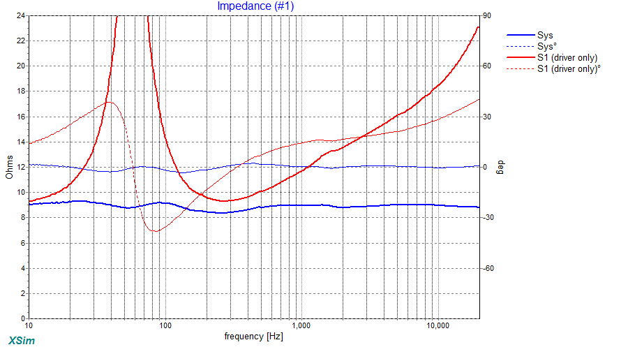

Hi find this free XO program from bwaslo to be exelent finding right component values http://www.diyaudio.com/forums/multi-way/259865-xsim-free-crossover-designer.html. Put a little time in learning the program it's great for this, quick guide is pick a amp and perfect driver, now measure your real world drivers impedance in the final box design and make a dot zma extension file that is linked to the before perfect driver, add a RC network and toggle R and C up and down till curve suits you in the impedance window. Attach a example picture from my A10.2 driver where both inductance and resonance is compensated. Because changing something on the box design (ports, dampening material, any sizes) changes the measured impedance, the impedance measurement and final network components values has to be last point in the building process.
To measure impedance i use the DATS device, but free REW can do same and make a dot zma file.

Setup from the attached picture did measure cleaner impulse/step response but both RLC and dual RC networks added this full range driver. On this driver it's a night and day listening result and raise sound quality. Think it's good idea measuring before after effects using REW to confirm impulse response and group delay is getting better and not worse by the network, acoustic domain verse electric domain can behave different and probably worse for full rangers that not behave perfect piston and minimum phase LF to HF. RC network in measurements i can't see it change in HF frequency response, the RLC network do some small change in LF area which depend design and speaker placement in room can be benefit or not, normal i use EQ so doesn't matter. On request when time allow can do some before after measurements in REW, or try linearize yourself and measure + listen effects before and after.
