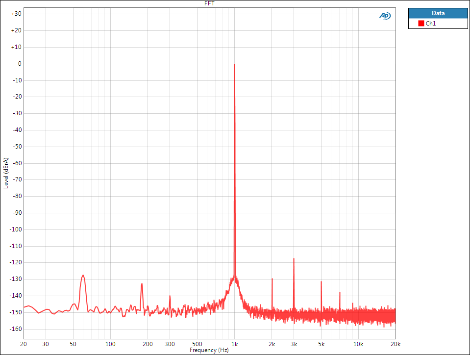

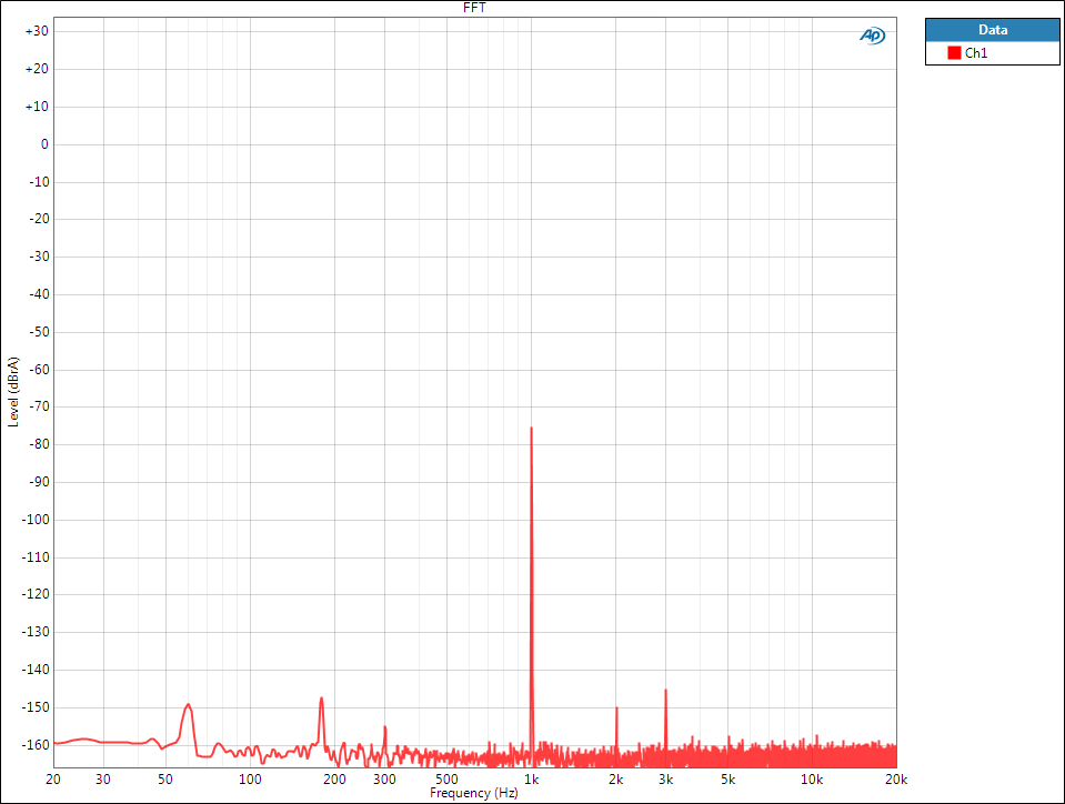

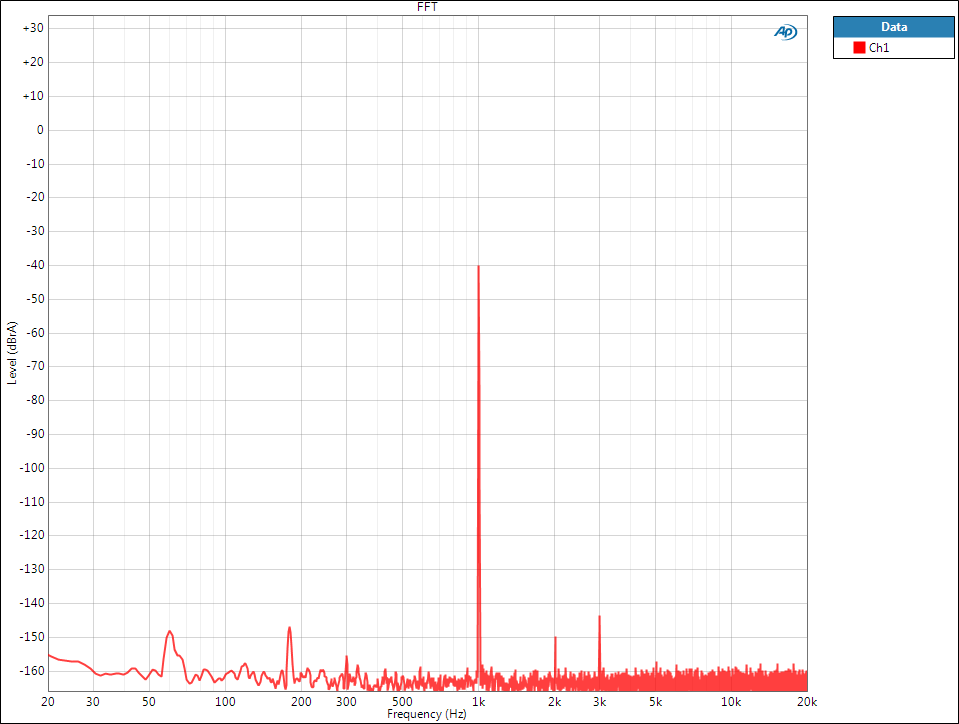

Hey guys, sorry for the slow reply on this. I did some reading on the original thread above to understand Mr. Cordell's concern and found that in that thread the potentiometer used was 1kOhm. I orignally tested the pcb from TIPD136 with a higher impedance potentiometer and didn't see much in the way of distortion, so I ordered a 1kOhm potentiometer and swapped it into the board. I took FFTs of the output signal for a 1kHz sinusoid at 2Vrms. The FFTs are taken at attenuation levels of 0dB, 40dB and 75 dB. The y-axis in these FFTs are dB relative to 2Vrms for ease of comparison. I also measured the frequency response at a these attenuation levels.
For 0dB attenuation and a 2Vrms signal, the 3rd harmonic is dominate at -117dB, the other harmonics are down 130dB or more. At 40dB of attenuation the 3rd harmonic is still dominant and is -103dB below the fundamental. At 75dB of attenuation the 3rd harmonic is 70 dB below the fundamental.

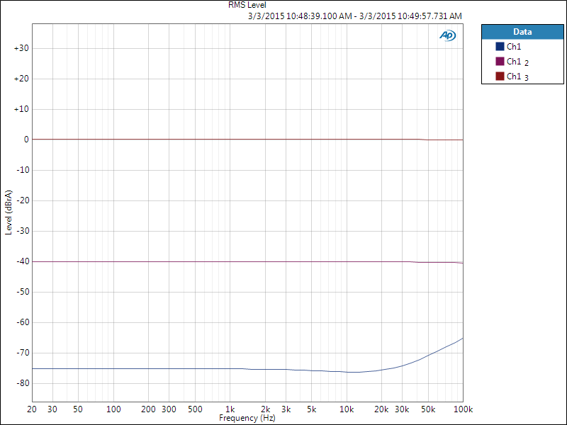

Frequency response only changed in the case of 75dB of attenuation, where there is about a 10dB loss in attenuation at 100kHz.
Overall I feel that if this performance concerns you, a good option would be to use a higher impedance potentiometer.

Err, not at all. Thank you for running the tests and providing the data so clearly. And these really are worst case results using a 1k pot rather than a somewhat higher value. Even so its pretty decent.
The frequency aberration comes as a surprise to me with what seems a very small increase in attenuation above 1.5kHz or so before the loss you mention. The variation is obviously small though, I'm guessing, perhaps 0.1db or so.
Was the opamp the OPA1604 as mentioned in the pdf ?
The distortion artefacts were of course the main concern and it seems you didn't observe much at all with a higher value pot.
Thanks again John for taking the time to run these tests.

Yes, the op amp tested was the OPA1604. My first guess is that the variation in attenuation for the 75dB case is due to the changing output impedance of the op amp. This effect is somewhat magnified when using a lower impedance potentiometer because the variations in output impedance are a larger percentage of the pot value.

Nice work, John. Notice that the magnitude of the distortion components is about the same at -40 and -75. This is basically the constant amount of signal-current-induced distortion in the output stage of the op amp. With relatively constant distortion voltage at the output of the op amp, it follows that % distortion will go up as output signal level goes down. What we basically have here is that the output impedance of the op amp is slightly nonlinear.
If the tests were done at a higher fundamental frequency, one would likely see significantly increased THD - probably 10X as much at 10kHz, but I'm just swagging here. I realize that a PC-based distortion measuring setup limited in the highest frequency it can see, may not permit such a test. Alternatively, one could run a 15+16kHz CCIF test and look for IM components in the spectra.

Hi Bob, just to clarify, this isn't a soundcard based PC measurement system. It's an Audio Precision APx555, which is capable of FFTs up to 1MHz. And you're right that the distortion harmonics are most likely increasing at 20dB/dec as the loop gain of the OPA1604 rolls off (35MHz GBW).
But, again, this behavior appears when using a low impedance potentiometer in the circuit (1kOhm) . Isn't this just another example of the design trade-off that often arises between noise performance and distortion performance? For example, what if we changed all the resistors in the circuit to 10 ohms? We would certainly reduce noise, but drastically increase distortion! It's up to the engineer to decide whether noise or distortion performance should be prioritized in their application :)
ChristianThomas:
I should point out that the idea of using a pot in parallel with the gain resistor of an inverting amplifier will have the same distortion behavior as the Baxandall circuit. You are attenuating the signal while simultaneously increasing the output loading on the op amp.
