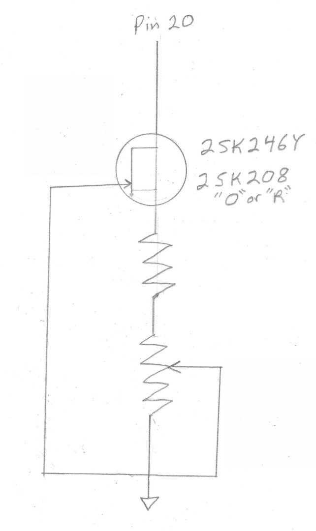

Many different constant current devices and circuits have been tested on pin 20 for sq improvements and temperature stability. Two JFET types meet these requirements. The 2SK246Y is a TO-92 style and not in production but is readily available and affordable. Make sure to get the "Y" version. The 2SK208 SOT-23 JFET is in current production with the “O” and “R” versions sounding great. In fact Toshiba officially lists the 2SK208 as the replacement for the discontinued 2SK246Y which may explain why they sound so similar. The 2SK246Y has a small negative temperature coefficient. The 2SK208 “O” has a slight positive temperature coefficient no greater than 1% from 25C to well above 40C.
See circuit below. The JFET source resistance values vary considerable depending on the JFET device used. A 1000 ohm fixed resistor and a 2000 ohm pot cover the entire range of 2SK246Y JFETS with 1800-2500 ohms covering most of them. A fixed resistor is a more temperature stable device, so it is desirable to have as much resistance from the fixed resistor and the least from a Bourns pot. A Susumu RG SMD resistor is preferable to a Dale RNxx. A bread board can be used to determine what resistance value gives the desired 0.40 ma so that the optimum components can be purchased. This circuit can be easily made using a perf board.
The 2SK208 JFETS require much less source resistance. I used a 470ohm fixed resistor and 500 ohm pot for the “O” types I tested. A forum friend reported that 308 total ohms provided the desired 0.40 ma for his “R” types that measured an Idss of 0.60-0.63 ma.

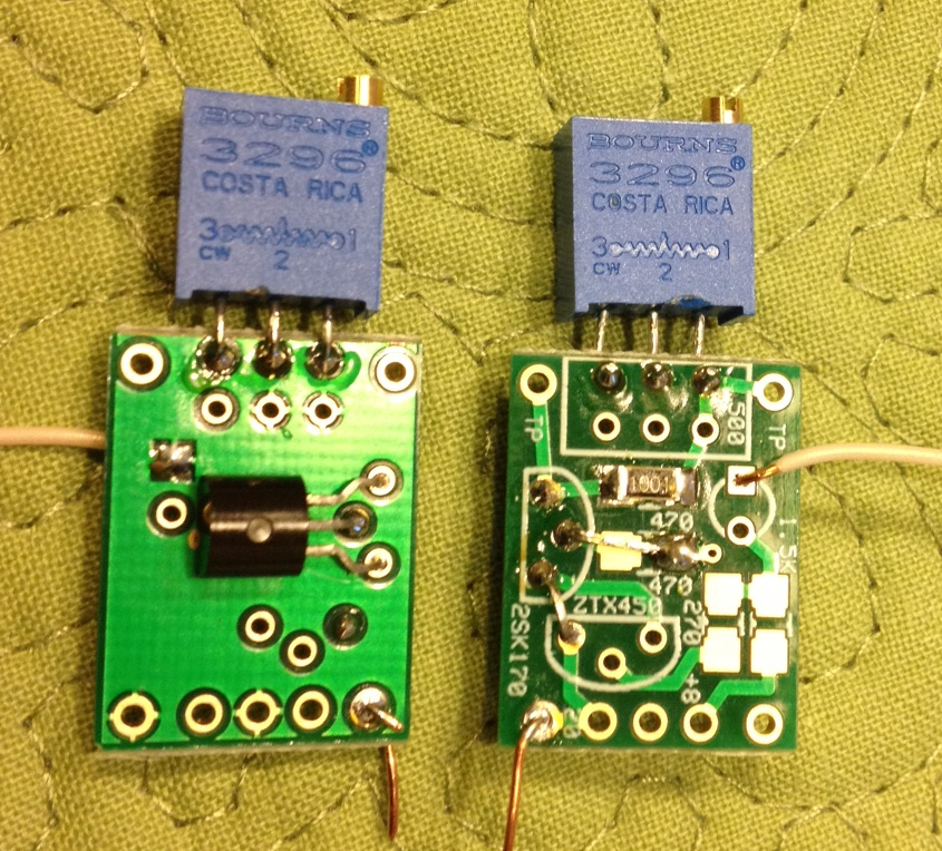

Also below is a mini-circuit board that was made when cascode circuits were being tested and only through-the-hole CCS devices were being considered. The JFET and Bourns pot can be installed from either side or any orientation depending on the space requirements of your surrounding DAC components. If the ground termination end of the 6K resistor is too difficult to reach then run a wire from any ground "star" pad hole to the Rload common or any other analog ground point. The next revision would have alternate pads for a SOT-23 JFET and probably eliminate the cascode circuitry. Please send me a PM if you have any interest in these CCS boards or in a future revision.

Thanks, subscribed.
I'd be interested in a little board which will allow for the one SOT-23 package + resistor/potmeter. Any suggestions anyone?
From the post from carlsor the small board already exist as per his initial circuit with cascode and led. Should not be so difficult to redesign a new small board with the SOT 23 with or without cascode.
Thanks, subscribed.
I am thinking of using the resistor and transistor in smd package, it will not be difficult soldering these to the legs of a bourns multiturns pot. This will keep the footprint small for easy mounting at the resistor position on the dac board.

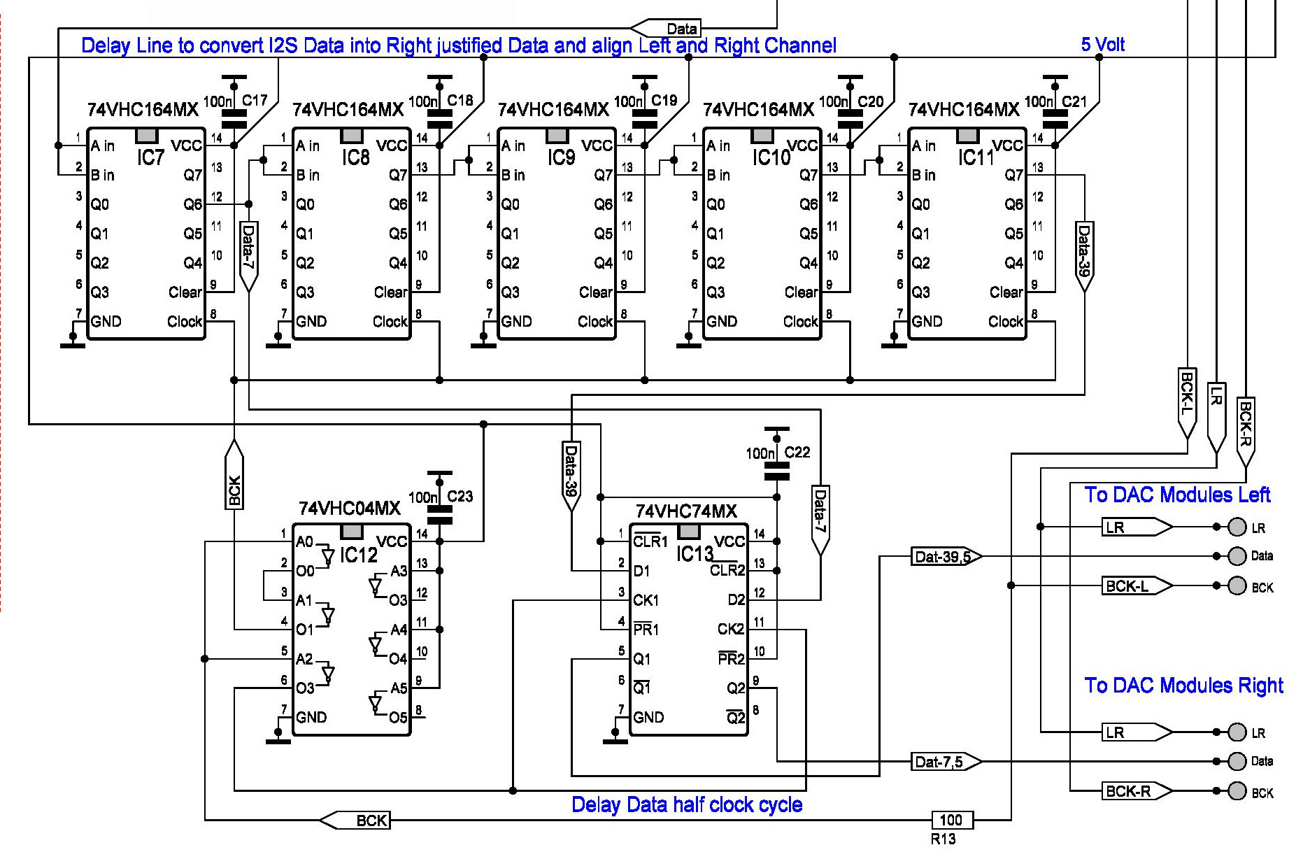

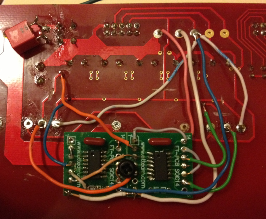

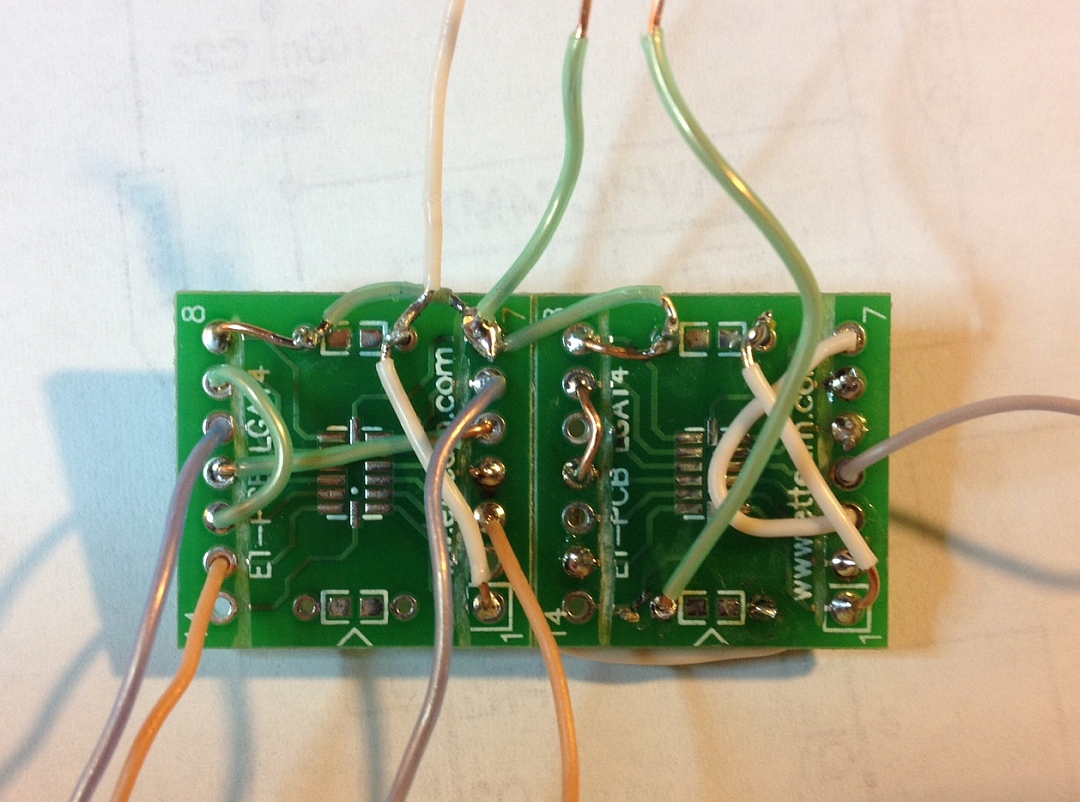

1/2 Clock Delay Circuit
This upgrade takes most of an afternoon to build and install, but is well worth it.
These are my initial sq impressions from this change: I hear MORE music!
- Cymbals sound 100% right for the first time.
- Voices are more articulate
- Sound is more crisp and vibrant. No smoothing here.
- Same amount of detail, but it sounds more coherent and "right"
- I got drawn into musical nuances of familiar CDs that I never noticed before.
- More focused placement of instruments in the soundstage. I could almost hear the size and shape of instruments.
The board is about $10 usd of parts, but I also bought a 5V Belleson SPM78 regulator ($36 usd) to comply with the Blue Main Board voltage. Yes, a 5V regulator makes the DAC with this upgrade sound more accurate and smooth compared with my original 3.3V Belleson. According to the data sheets the 74VHCxxxx chips switch state many times more quickly when operating at 5.0 volts. Adaptor boards can be bought on eBay but could take a month to receive. 3pcs SMD Converter Adapter PCB SOIC14 LGA14 to DIP14 | eBay

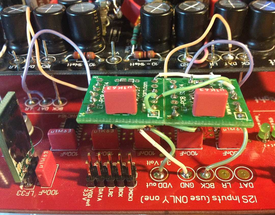

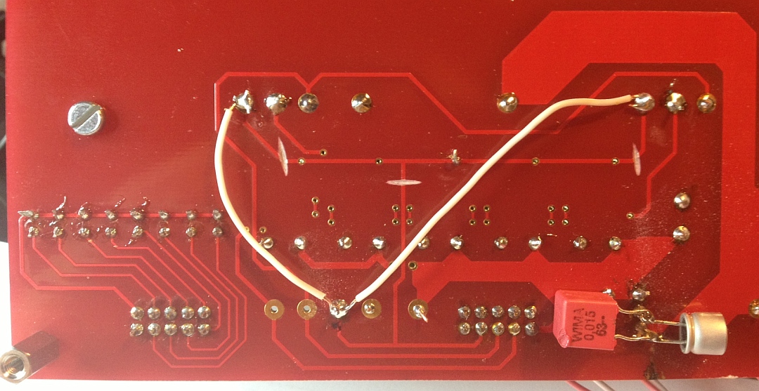

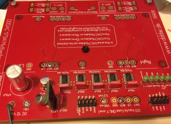

The I2S resistors should all be 100 ohms – the 1000 ohm resistor for DATA must be replaced with 100 ohms! The bottom of the main board had to be modified by cutting BCK foil traces and adding jumper wires. See pictures below. You can see the delayed signal wire from the 2-Chip Board going through one of the clock foil trace holes to the five 74VHC164 chips.
I initially built and installed a 1/2 clock delay circuit above the main board. Later I built a second 1/2 clock delay circuit board but installed it on the bottom of the red main board which puts it out of sight. I think some of the wires lengths may be a little shorter, but this location is no less time consuming to implement. I used 24ga CAT 5e solid wires. For multiple connections I loop a single wire through the points as much as possible.
For the bottom installation I drilled an M3 hole through the adaptor board pair and main board with a plastic nut spacer and screw to hold it firmly in place.
The Belleson and some other Vregs need more load than from the seven 74VHCxxxx chips to provide optimum regulation and sound their best. The connection to the WaveIO isolator provides enough extra load, but if you are using an rpi or reclocker with its own isolator you may need to add a 330 ohm resistor across the Vreg load.
My engineering mind cannot figure out why new components, circuits, PS, etc in the digital domain of 1's and 0's have to go through a burnin period, but my ears tell me this is necessary.

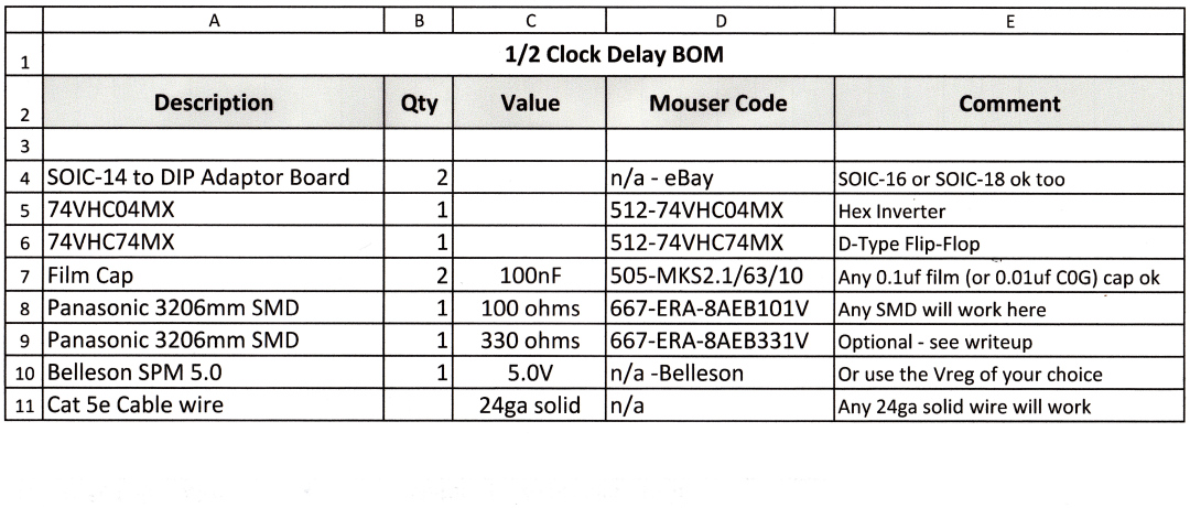

Below is the 74VHCxxxx chips circuit diagram pulled from page 3 of the DDDAC 1794S NOS manual that should be used as a guide for wiring and installing this circuit board. Also included is a BOM and installation pictures.
