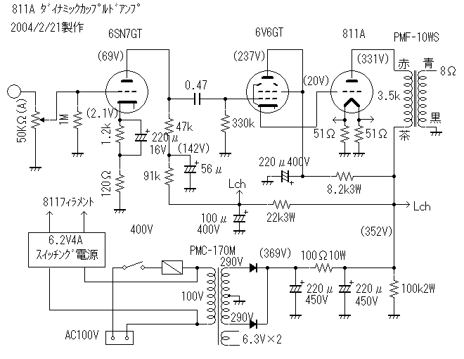

SE 811 amp schematic...
Please note that the referenced schematic is not using a standard 811A transmitting triode, but a newer Svetlana tube which is not the same... it has no plate cap for starters. A real 811A transmitting tube will not operate in the referenced schematic. As with most transmitting triodes (3C24, 808, 811), you will need to operate them in Class A2 mode (meaning the grid is always positive).
You might want to start with something similar to this:
I-811A.SE
Search around his site... he has several 808/811 amplifiers complete with schematics and measured specifications. The dynamic driver (shown) is a cost-reduced setup, while an interstage transformer would be better albeit more expensive.
Regards, KM
I-811A.SE
Regards, KM

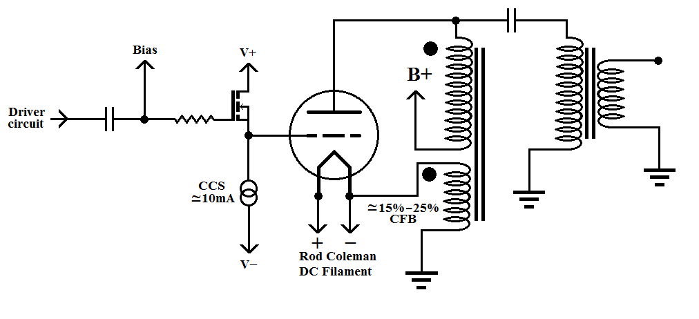

I've had very good results using cathode feedback (CFB) in parallel feed with Tube Lab's Power Drive. To me CFB sounds better than global feedback - YMMV. I have a plate choke wound with a 15% to 25% CFB coil. This is a very flexible setup because you are not stuck with an expensive high end custom transformer if you change your mind. You can always reuse the plate choke and parafeed transformers are less expensive than air gapped series feed transformers.

Overall, a nice simple design. One thing to note however... as the 811A is biased with a positive grid voltage, any fluctuation in line voltage will yield a corresponding fluctuation in both plate voltage "and" positive grid voltage. This will result in a rise in plate and grid currents with an increase in line voltage.
When the output tubes are biased with a negative grid voltage, the opposite happens (negative grid voltage increases as well as positive plate voltage) which helps to self regulate static current flow. This is a slight downside for running transmitting type triodes which require positive grid voltage at lower plate supply voltages.
On a 3C24 amp design I did some years ago I used a 5651A voltage reference tube for a regulated positive grid supply to the dynamic driver triode. This results in less drift from line voltage fluctuations and could be a first mod of sorts for the circuit you are showing.
Regards, KM
Regards, KM

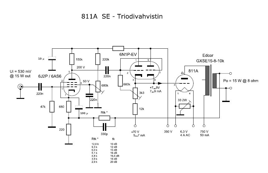

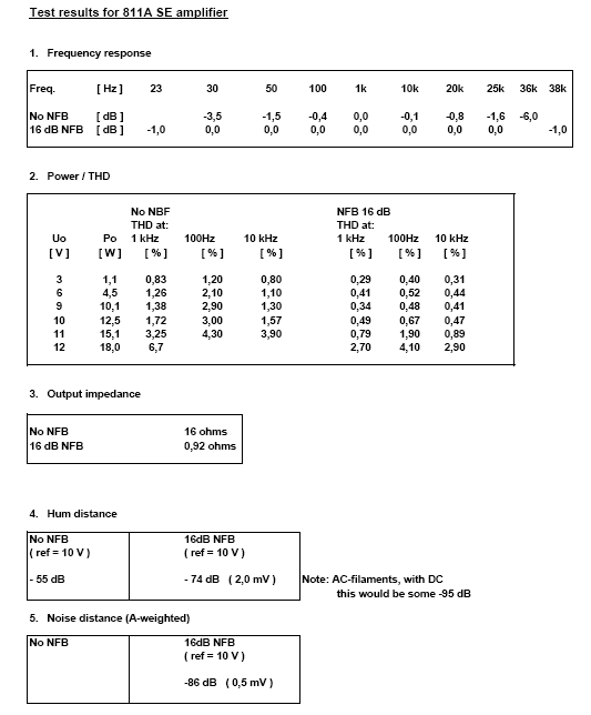

Artosalas.
Very good circuit.
OUT put impedance of 0.92 ohms is very good, from such a high impedance tube as the 811A
One of the most important measurements, as it gives a good idea of the type of speakers you can use, without getting a lot of boomy bass.
Very few manufacturers, DIYer's ever give the out put impedance.
Phil
Agreed, nice circuit Artosalo,
A bit surprised on the OPT choice as these are somewhat small and have a limited frequency response. I imagine the 811A dwarfs the OPT as well. Still, the performance with NFB is admirable.
In the old days (circa 1950's) Damping Factor (DF) was typically quoted for power amplifiers. In simple terms, it is the ratio of output impedance to (rated) load impedance. The venerable Dyna ST-70's DF was listed as 15, or ~1.07 ohms output impedance (assumimg 16 ohm tap as that's where the feedback loop is taken). Artosalo's 811A amplifier would calculate to a DF of ~8.7. Going with a larger OPT with lower DC resistances on the primary and secondary would improve this somewhat.
Nice to see actual noise measurements as well... which has always been a bit of a pet peeve for me, as most manufacturers (and some DIYers) tend to gloss over specifics of what the reference level is to calculate this. For all amplifiers I design, all specs are done referenced to 1-watt output. Depending on output power, additional specs are done to show headroom and power bandwidth as well.
An example:
1- A 1-watt output into 8 ohms = 2.83 VRMS output level
if your s/n ratio is 80dB (referenced to 1-watt), output noise would be no more than 283 microvolts (0.000283 VRMS).
2- A 100-watt output into 8 ohms = 28.3 VRMS output level
if your s/n ratio is 80dB (referenced to 100-watts), output noise would be no more than 2.83 millivolts (0.00283 VRMS).
This is typically a misleading spec in most ratings, as the 100-watt spec looks good on paper, but is quite noisy in comparison to the 1-watt spec. Normalizing the s/n ratio between the specs, the latter only has a s/n of 60dB.
As Artosalo shows specs with AC filaments on the 811A, the NFB is working hard to quiet things down.... so implementing a proper DC supply would improve this quite a lot as he notes in his spec sheet.
