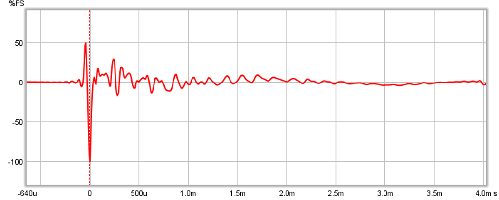

And the Impulse response isn't too shabby either:

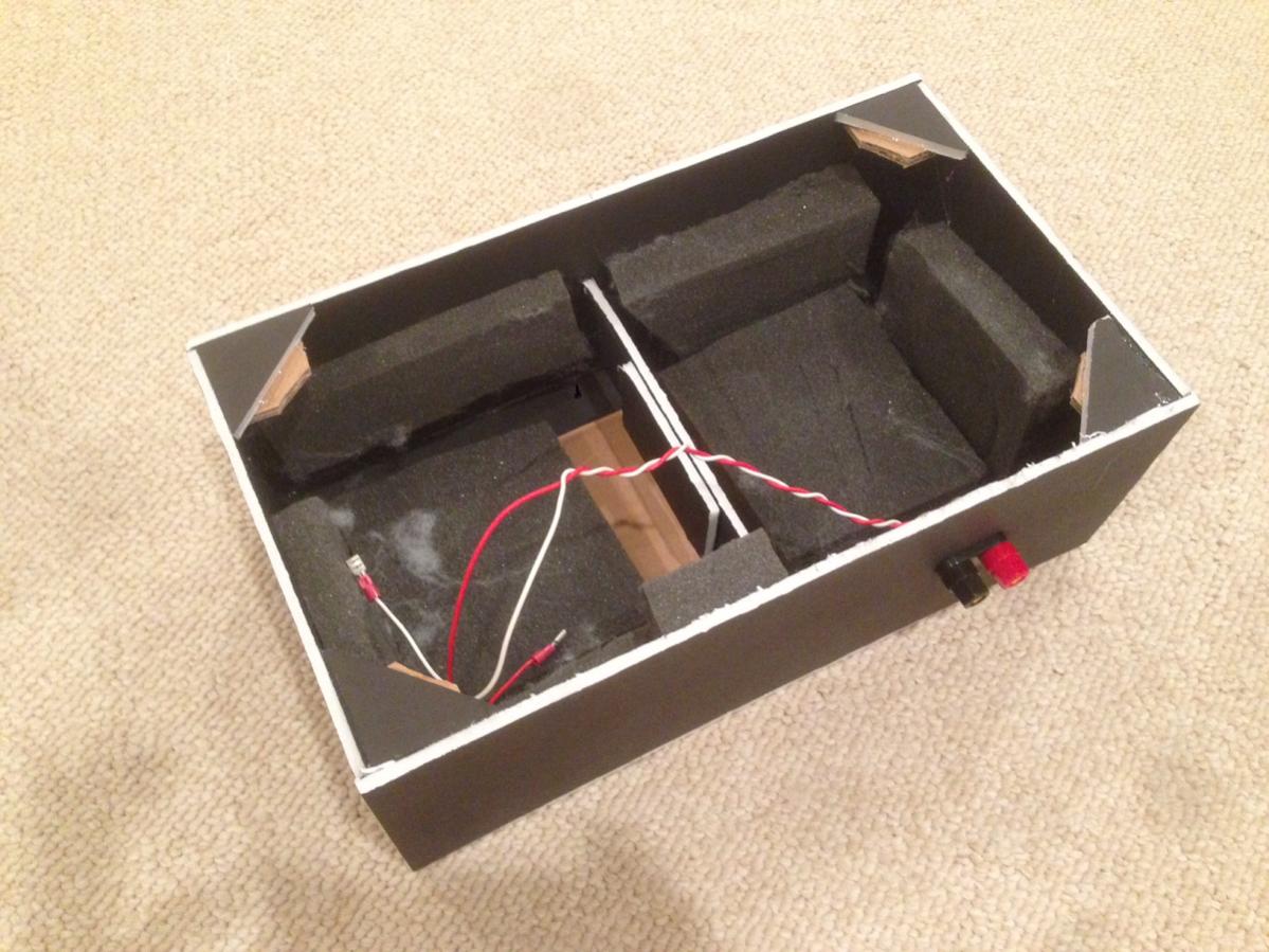

Here is the rear sealed chamber (6in x 6in x 4in and lined with open cell grey foam):

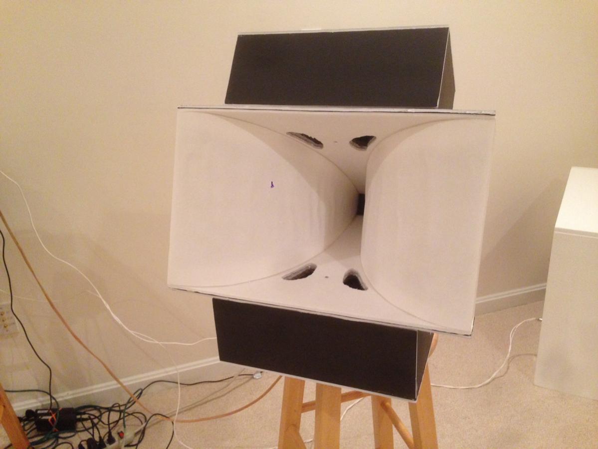

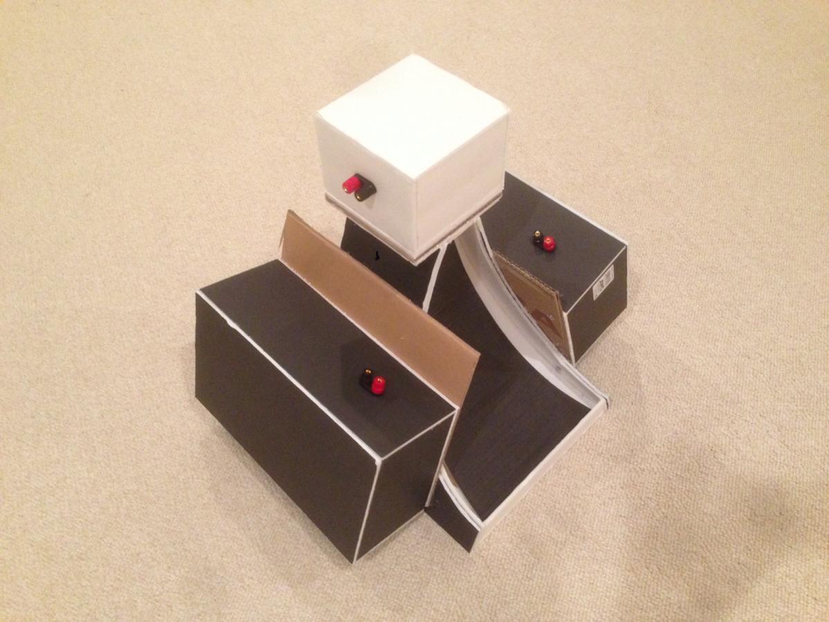

Here is the horn before I put the woofers on (note the black panels on top of the white panels - those are the constrained layer damping (CLD) layers used to reduce panel resonances using latex caulking in between the white horn walls and the black foam sheets):

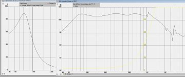

I normally model stuff before building, but in this case, I had some buyout PE 6.5in woofers lying around. There is only so many ways to fit these drivers into the tractrix so I went for the build it as you go approach sans modeling and got this after 90 minutes of cutting foam core/cardboard and hot glue:

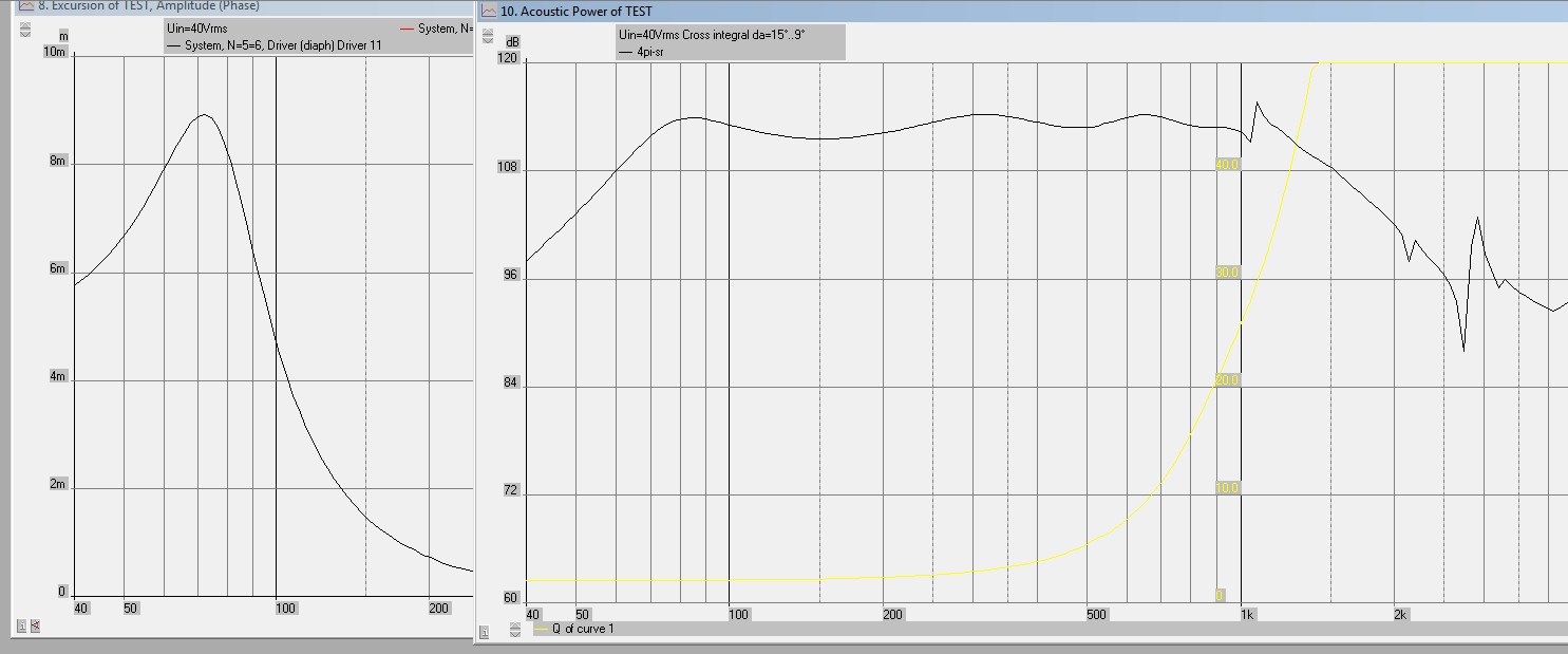

After building it, I then modeled it and saw that it needs a rear sealed chamber on the woofers otherwise there is no bass to speak of due to proximity of the backside of woofers and the mouth causing cancellation. Here is the predicted response with the woofers and the TC9FD:
With 3.5 mm xmax being reached at 21 volts:
Giving a corresponding max SPL capability of about 113dB at 1m and 21v:
With the corresponding electrical power input predicted to be 30 watts per 6.5 in driver, which is OK per the manufacturer's rating:

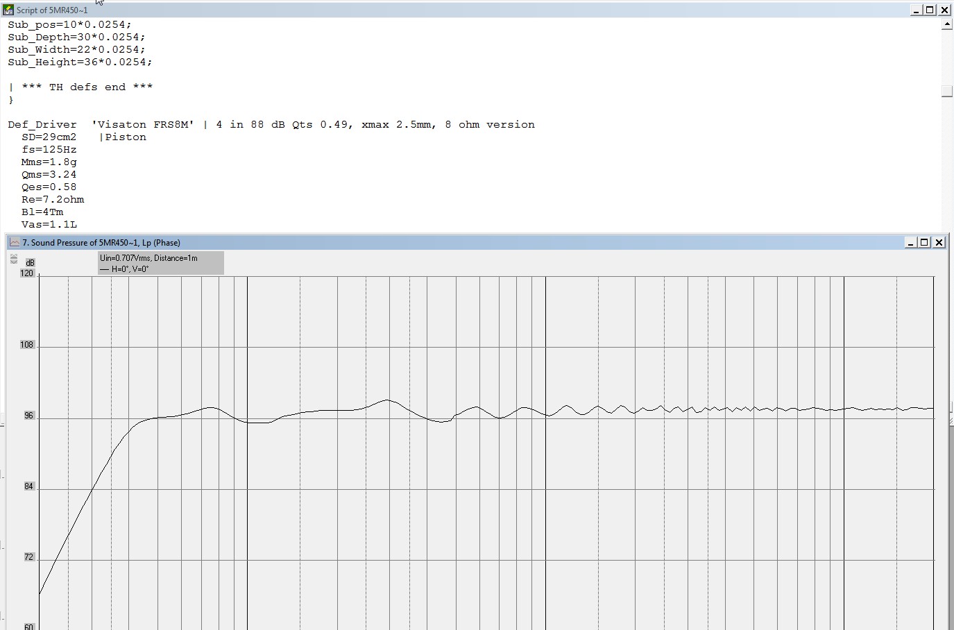

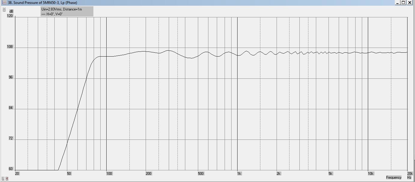

I have play some with the Xmax, and have in akabak the ports adjusted so that I have 120 dB 5mm Xmax (speaker is max 8 mm), the implemention of the reflex ports is very nice for this.
the FRS8M from visaton is also very good for you it is a small fullrange who go to 20 Khz.
I have change your script a little, like the power to them, high has now 1.5 and not 1.95.
chamber is smaller because it is little woofer, but handle 40 watts.
I get 120 +dB with 20 volts on it xmax 4mm that is small, wauw.
second photo are the phillips woofers in normal conic horn.
regards
kees

Kees,
That is some impressive bass you are getting out of the Phillips and it would appear seamless integration with the Visaton. 120dB+ is very good without hitting xmax.
You should build it based on how good the sim is coming out. My quad 6.5 in woofers can get lower bass but then the box volume has to be very big because they are rather large Vas drivers.

The sealed rear chambers may just be a simple box, but it took almost as long to cut and assemble as the tractrix horn (lots of cuts whereas the horn was two panels and a top and bottom sheet)! I ended up reducing the volume down to about 9 liters for more bass punch at expense of extension. I checked in the model and a 9 liter rear chamber provides a 97dB at 2.83v and 1m sensitivity and about 103Hz as the -3dB point. The other reason for a smaller chamber was to keep the physical size smaller with the box being 8in x 14 in x 5in tall. I installed grey open cell foam on the inside, added a layer of cardboard on the large top panel to add stiffness as bracing is tough to put here with magnets in the way, I added one cross brace, binding posts, and wired in series on each side. This gives me option of externally wiring for series/parallel for 4 ohms or bi-amp each side at 8ohms (which allows me run the woofers like a DVC subwoofer in pseudo-mono).
Here is the inside of the rear sealed chamber:

Here is a view of the tractrix Synergy sitting on the stool-cum-speaker-stand fitted with a couple of foam blocks to stabilize it. The exposed parts give this speaker a bold chunky look that reminds me of a Transformer robot Kind of cool...
Here is a front view of the horn with the bass injection ports visible. The ports are hand cut using a template from the backside, but by the time the razor goes through 3 layers it looks a bit jagged. In any case, the CSA is eyeballed at about equivalent to a 2 in dia round port. Thus I used 5cm dia for the port in the model. In order to measure the volume of the driver chamber, you will never guess how I measured it! Well, since the surround is rubber, the cone and dustcap are polyethylene, all waterproof - I simply poured water into the cone like a bowl and poured the water out and measured the volume with a graduated cylinder It is exactly 185 mL No harm done...

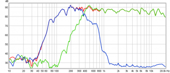

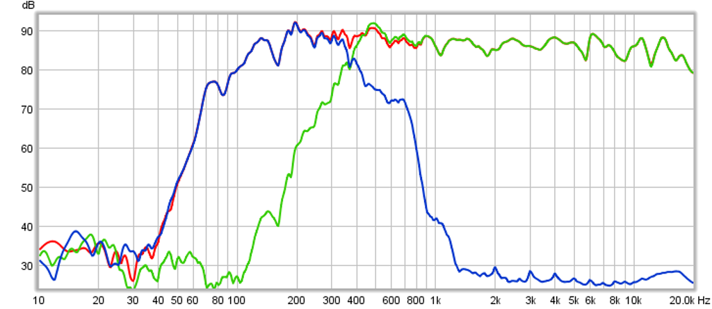

Ok, so let's get to the good stuff... measurements. I used the EQ that I previously set for the TC9FD tractrix, but I removed the two rather agressive peak cuts for now. I set the woofer to flat (no EQ) and set the XO's per the simulation: -24dB/oct BW @ 300Hz LPF and 90Hz HPF for the woofers, and -24dB/oct BW @ 350Hz HPF for the TC9FD. I threw in a 0.5ms time delay on the TC9FD (to be tweaked later). Based on the simulation, I also set the TC9FD gain at -6dB to match the lower sensitivity of the four woofers (which is predicted to be 97dB at 2.83v), making the predicted TC9FD sensitivity about 103dB at 2.83v before the cut.
Here is the combined and individual responses of the TC9FD and the four woofers in the tractrix Synergy. As you can see, the XO frequencies worked out perfectly. Akabak is a great help for initial XO setups. There is a well-known room mode dip at 80Hz and 150Hz in my speakerlab. You can see those here, but otherwise, the woofer behaves just as predicted.

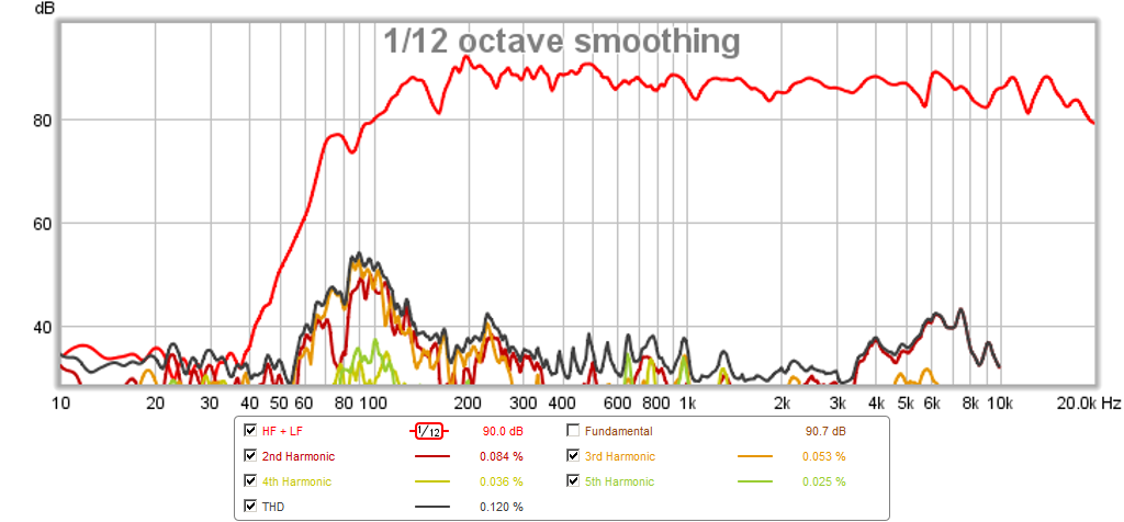

Here is the harmonic distortion (HD) of the system - below 100Hz, the drivers are exciting panel resonances that are below the bandwidth of the constrained layer damping (CLD) that was used which was very effective for sub 1kHz vibrations. This just means that if one wants to make a clean sounding Synergy for sub 100Hz, it probably needs to be made of something heavier like wood. My goal was to use this down to 100Hz where it will be crossed-over to a bass horn sub, so it has satisfied that goal very well. Above 100Hz, the HD levels are very low - characteristic of a TC9FD, which is already low, and when combined with horn loading for very small excursions, the HD is even lower. This results in a super clean purity of tone. Despite what some may say if harmonic distortion is perceptible or meaningful, in this case, the ultralow HD *IS* perceptible when listening to music. Especially vocals or complex passages with many instruments. The notes are distinct and "clear as bell".
The EQ could be cleaned up a bit more to smooth things out, but as is, it gives a pretty decent impulse response as seen here:

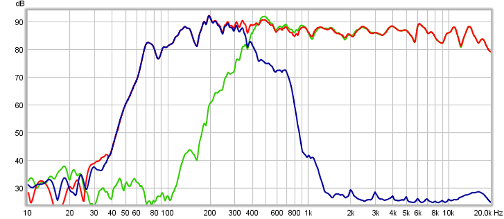

I also tested out what the woofers could do if I set the XO highpass at 70Hz for a little more extension:
Now finally, for the subjective question of how does it sound? Well, drum rol........... In a word, MAGICAL! There is something very special about a single point source covering a 100Hz to 18kHz coming from a tractrix horn that reduces the room wall reflections due to directivity. There is less junk bouncing around the room to mess with your perception, and the sound is *CLEAR* and clean. I have heard this description of the Synergy before: like listening to a big headphone without headphones, but this is in a good way. I can imagine that with two of these in stereo, the imaging and soundstage will be unbelievable. So for only $40, a little sweat, lots of modeling and designing, I am now a Synergy convert and can say without a doubt, this is perhaps the best sounding speaker I have ever built or listened to. Superlatives like best are difficult to use, as there generally will always be something better somewhere. So to caveat this, it will probably lose out to its bigger brother, the 1.0x scale tractrix with the 5MR450NDY, if that were ever "Synergized" with the dual 12in Kappalites for bass drivers.
I haven't had time to do extensive listening, maybe 4 test tracks so far. But each one just blows me away - it's like watching HD TV for the first time. Here is the first sound clip I recorded. One of my favorites to check vocals and articulation. Hope you like it...

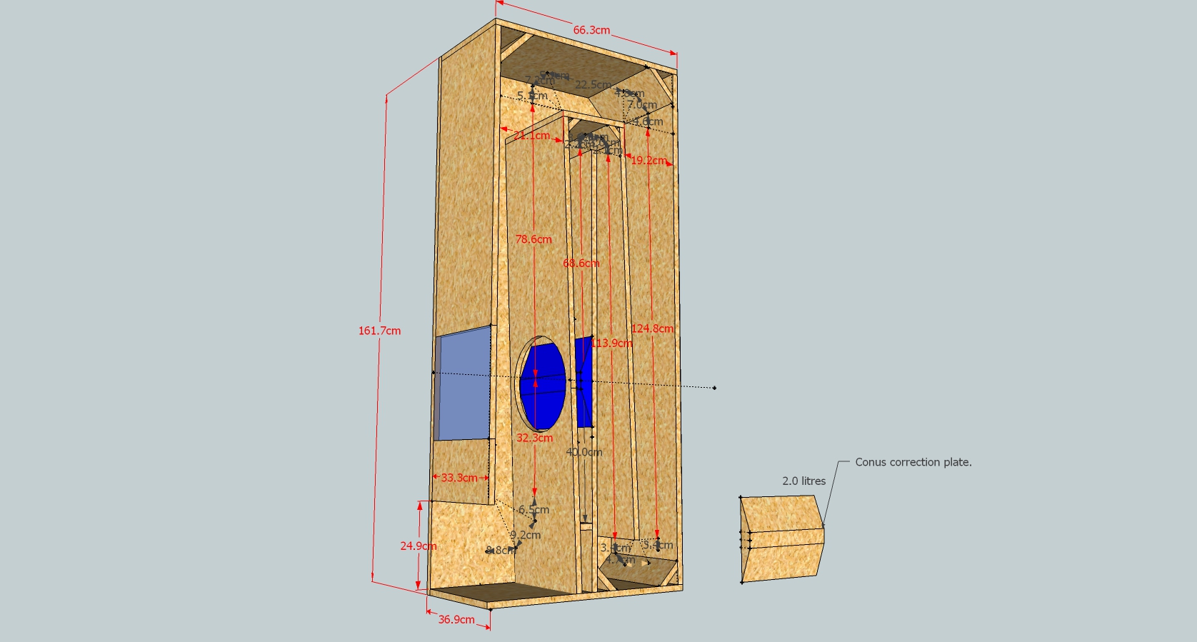

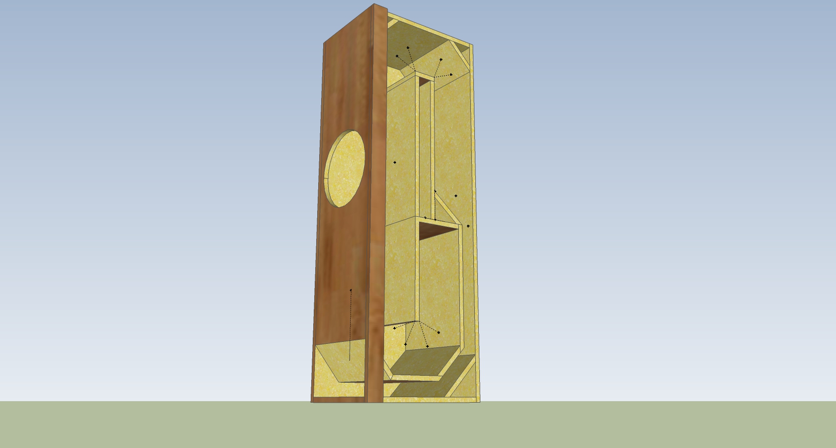

Kees,
How How, the bass is include tapped horn you did als include.
this is without that horn, my tapped horn I have fold and drawn go to 70 Hz, so it fit well here just for the overlap to bass mid, however efficienty of the tapped horn is not extreme in comparison of your tractrix, and i need analog so I go use a amp for the tapped horn and a stereo amp for tractrix or in my case conic first..
ML-TL picture go to 16 Hz
regards
