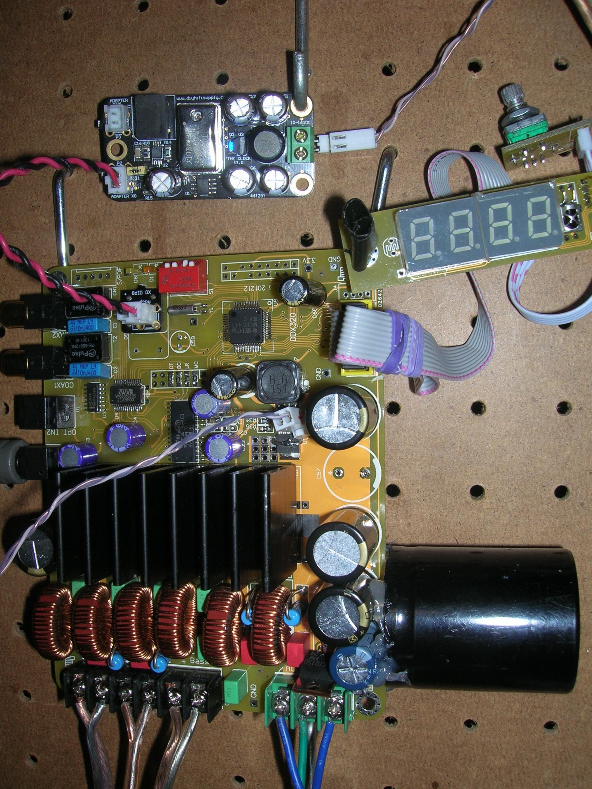

AudioLapDance 26th May 2014 06:21 PM
4 Attachment(s)
Quote:
Originally Posted by AudioLapDance (https://www.diyaudio.com/forums/class-d/256281-noob-digital-audio-post3940046.html#post3940046)
...The 8804 outputs I2S to the STA320 (there's also some control signals on the side). The STA320 converts the I2S to amplified PWM which is filtered and goes to the speakers ... yep no DtoA and AtoD!
:spin:
The DDX320 accesses some of the STA320's cool features: 2 vs 3 ch, xover 80-360Hz, eq settings ...
Err, sort of! Its 2op+2coax spdif in, WM8805 to STA320

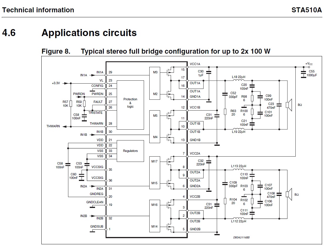

Then STA320 to:
STA510A (2x100W@6ohm) for stereo
Attachment 420572
Attachment 420570

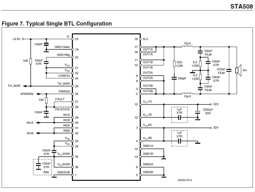

and sta508 (160W@4ohm) for bass channel.
Attachment 420571
Attachment 420569
Wow, forgot how powerful it is ... hmmm, with 3 SLAs 3x12.8V=38.4V maybe I'll put it in the car ....
