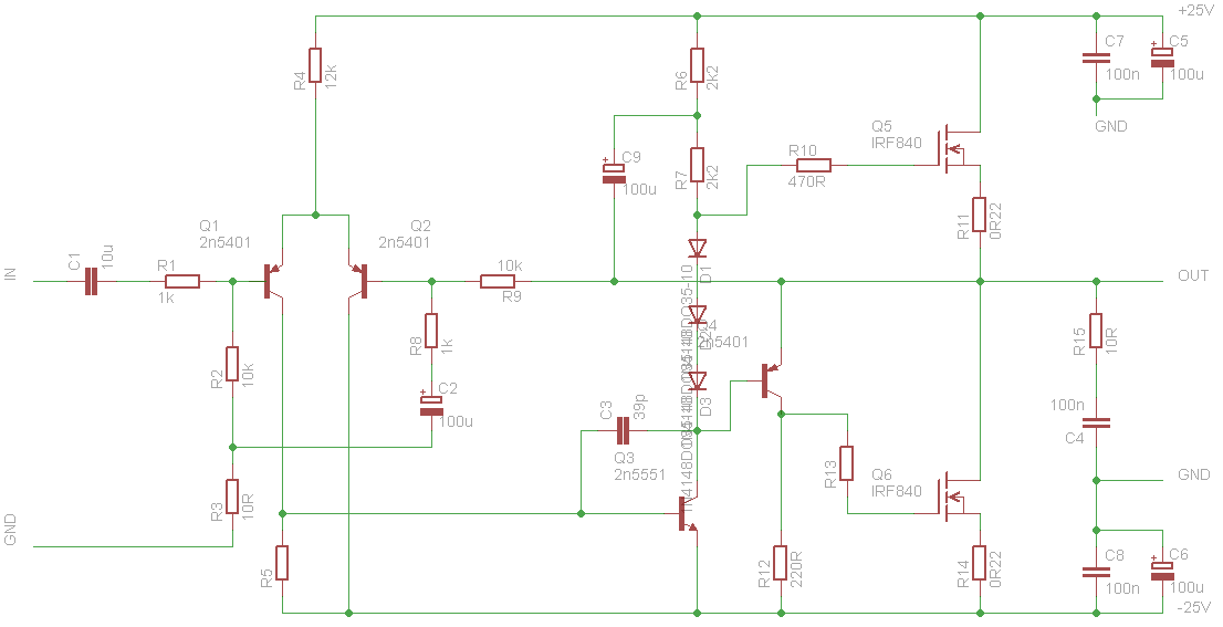

By way of background, I've been intrigued by some of the very simple amplifier circuits presented here, and have wanted to explore quasi-complimentary designs for several months now.
Inspiration for this project has come from Gareth (TGM lineup), Hugh (AKSA-55) and Carlos (original DX amplifier). I had originally planned to assemble Quasi's Nmos200; however, difficulties procuring boards has left me with a bag of IRF840 MOSFETs and nowhere to turn!
The schematic I present is as simple as I can possibly make it, without comprosing it to the point where it is just a giant oscillator. If you can think of any way to reduce the parts count further please let me know. Likewise, if I've omitted something essential for function or stability I'd like to know too.
I know there are 101 ways I can make this 'better': CCS on the LTP, degen resistors, bootstrap or CSS on the VAS, RC filters on the rails, etc. For this project I want to keep it as simple as possible and then my next project will be to embellish this circuit with some extra features.
Please let me know if there's anything I've missed (noting my Keep it Simple design ethos) and check my R values.
Next step will be to prepare a board layout and send the Gerber files to my board house.

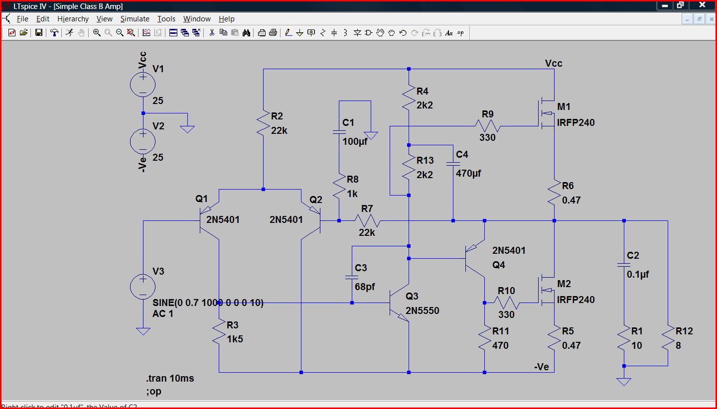

FET's are voltage driven rather than current drive which means you can not connect the gates as shown. Q5 is wrongly connected too. It should be from "gate to output", not gate to source. As it is now it can only pull the gate down, not turn it on. Also you need "gate stopper" resistors in series with the FET gates mounted as close to the FET's as possible.
Bone - thanks for the reference to Nelson Pass' project. Reading this article and studying several other schematics from this vintage, I believe the performance will be inadequate without a bootstrap on the VAS.
All - updated schematic attached. Is this workable? How to I go about optimizing the values of R10, R12 and R13?

Mooly, would you please explain the function of the gate stops and your reasoning for the large value? The stoppers on quasi's nmos design are only 27R. Thanks
Higher values will "play safe" and make the design more tolerant of any compromised layout and so on. That was my reasonlng. It removes a potential source of trouble for you.

Yes, its workable although it may need need more refinement to get the very best from it.

Bias. it would be much better (more thermally stable) with a proper vgs multiplier in place of the diodes. You could just copy a normal bjt transistor one (one NPN transistor, one resistor and one preset) and use that. The transistor must be in thermal contact with the heatsink.
MOSFETs are finicky things, they will oscillate just if you look at them funny... in addition to gate stoppers I have included additional footprints on all my latest pcb's that use MOSFETs at the output to include an SMT zobel network between gate and drain. A series R and C. You don't have to populate the pads, but they are there if needed or if you end up trying a particular MOSFET that's more finicky than the others. Put some nice rail caps close to the FETs on the pcb too.
Depending on which MOSFET you want to add gate protection zener diodes - most MOSFETs need them.
I would also allow space for lead compensation, a small cap from VAS collector to the feedback node.
I'd add a resistor (e.g. 82R) in the power rails with cap to ground, to isolate the front end from the power output stage. This is fairly common, to avoid unintentional feedback via the power rails.

I agree with Mooly's suggestion for the LTP tail resistor (your R4, his R2) which shoudl be 22K not 12K. This does cut the current through each transistor in half but it allows the collector load resistor to be twice as large in value which helps push up the open loop gain. Although less current means less slew rate, you can ameliorate somewhat this issue if you keep Cdom small by adding the lead compensation cap I mentioned already.

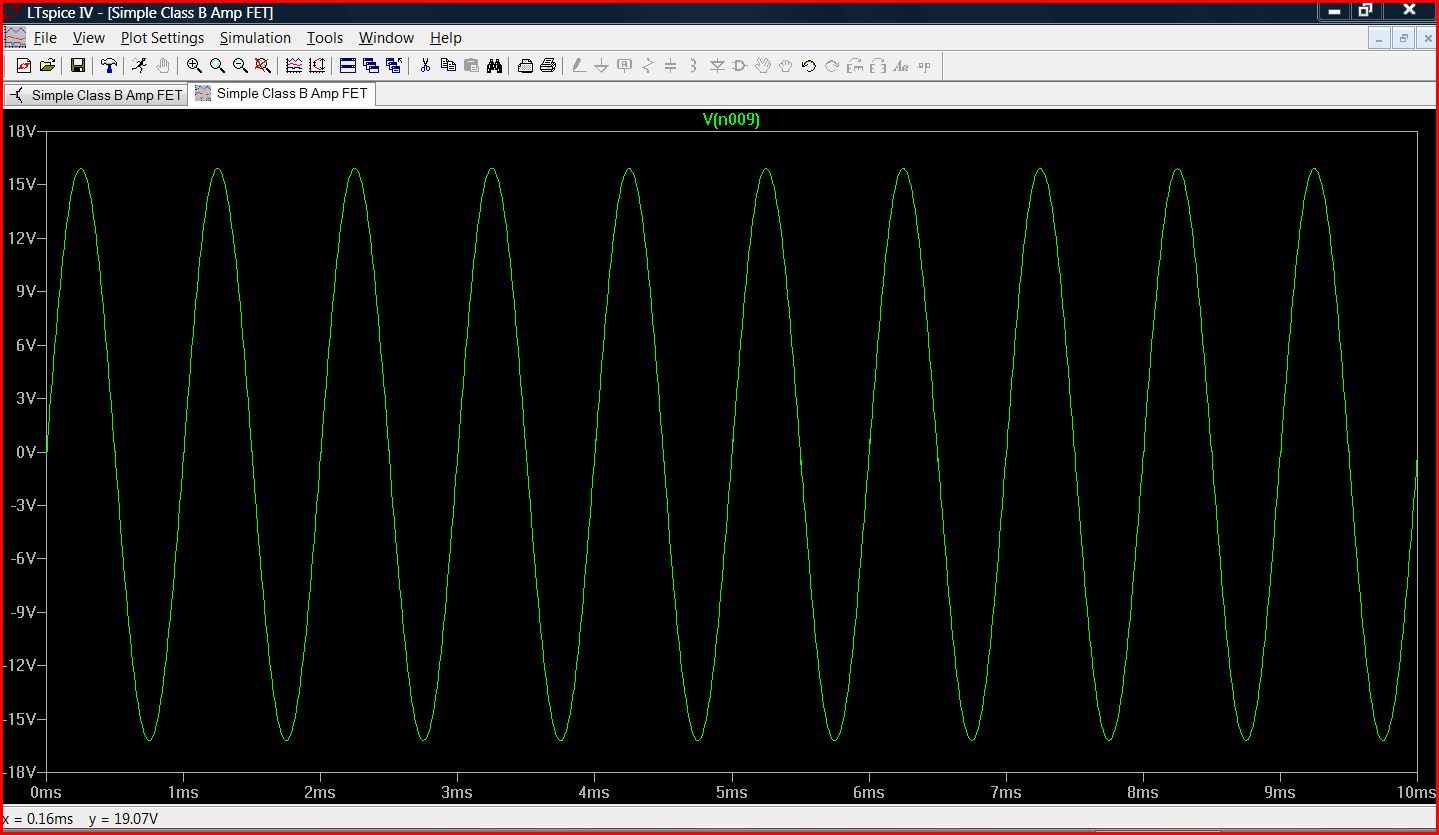

This works at a basic level. It needs the bias network adding :)
Very generous of you to take the time to simulate this. Any chance you would send me the files to play with?

I can see you are conspiring to turn my simple amplifier into a complicated beast :D
The prospect of adding the 4 passive devices (even pads) for the zobel networks makes me very unhappy indeed :( I need to read more about about the causes and remedies for parasitic oscillation in MOSFETs.
Bob Cordell published a paper discussing the issue on his website here: CordellAudio.com - A MOSFET Power Amplifier with Error Correction I'm hopeful that with only a single pair of outputs, the relatively high gate stopper resistances in this design, close decoupling around the source/drain and careful PCB layout will save the day. But I will take your suggestion under advisement and may incorporate it in the PCB layout after further research.
I plan to put place rail decoupling caps as close to the MOSFETs - as large and as close as practical. My aim is to lay out a 2ch amplifier on a single 10x10cm board. Ideally I'd like the bulk filter caps onboard (say a 4,700uF cap per rail per channel) but if space constraints dictate otherwise, I'll move the bulk caps offboard and put some 100-220uF decoupling caps there instead.
I'll give serious consideration to the gate-source protection diodes, thanks for the suggestion. I'm a little perplexed that the large majority of MOSFET designs here (including Quasi's popular Nmos project) omit this protection.
On a different note, you might be pleased to know I've decided to give the LTP a fighting chance by adding a modest RC filter to the +ve rail between the VAS and the tail resistor.
Sounds like good advice to me and I'll adopt the 22k for the tail resistor. Mooly has also increased the feedback network attenuation in his Spice model to give a more reasonable closed-loop gain - something that was on my "to do" list - noted and adopted.
I'm interested in playing with the Cdom value and experimenting with lead comp once I can get this thing into Spice.
