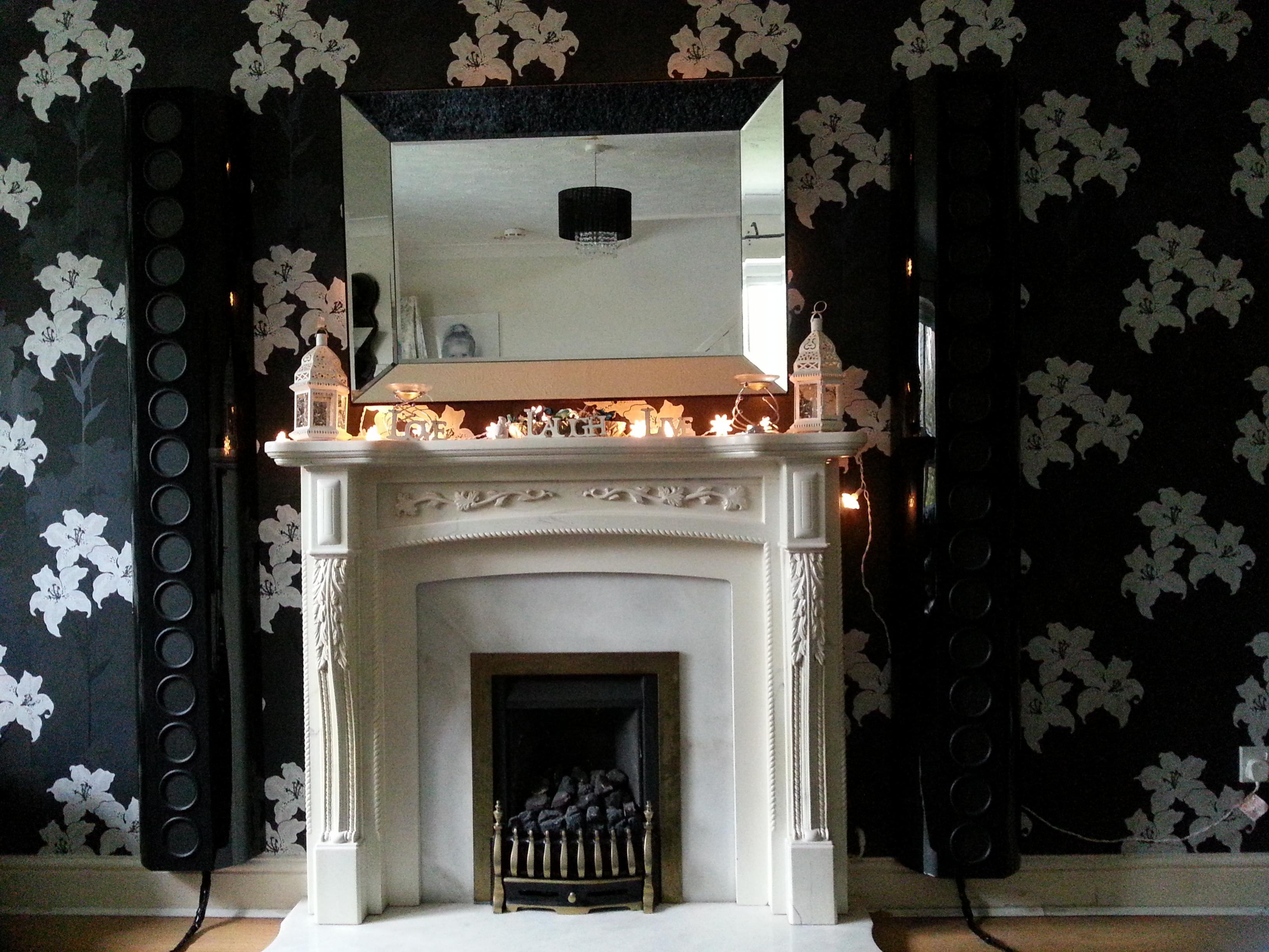

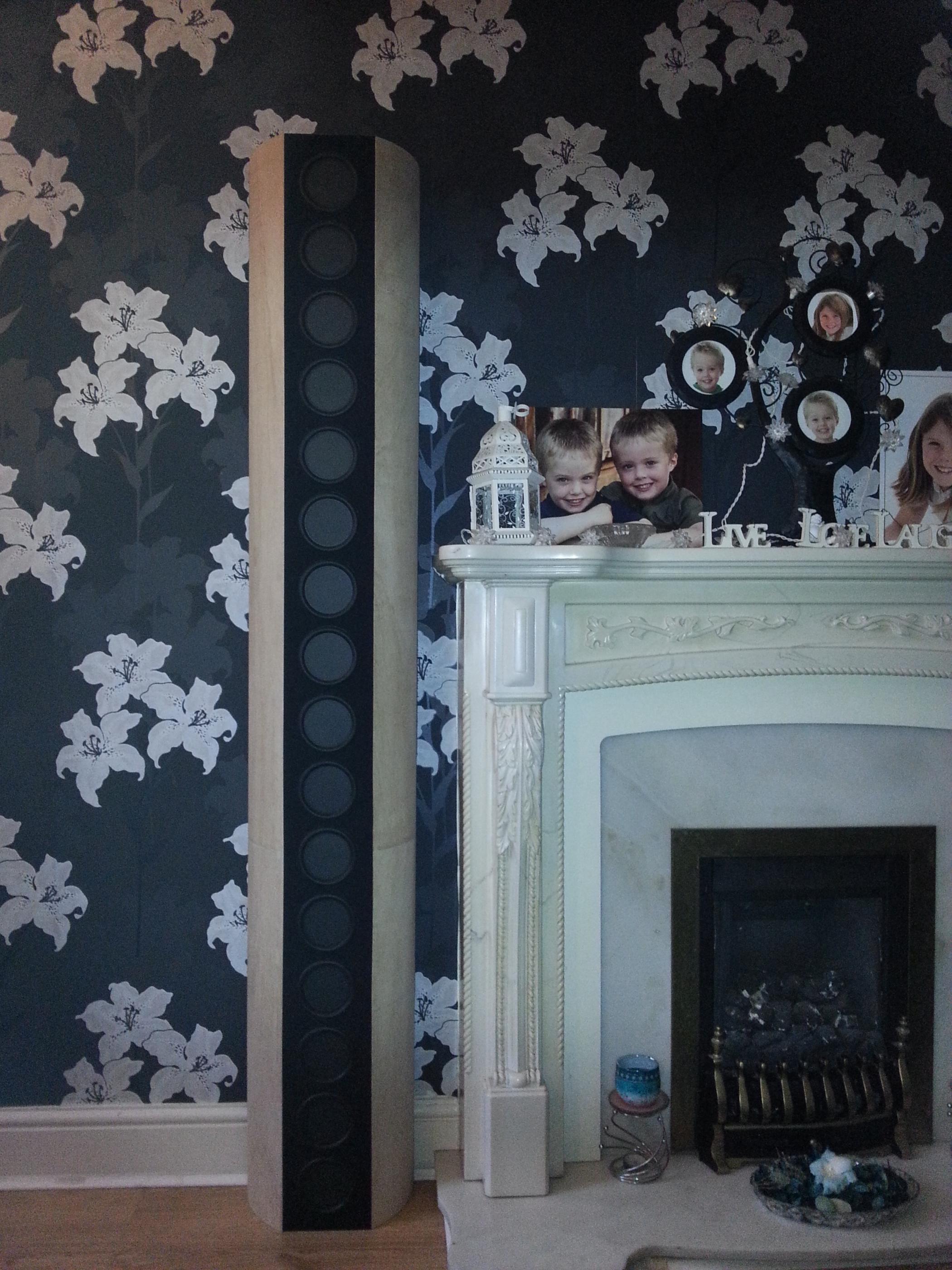

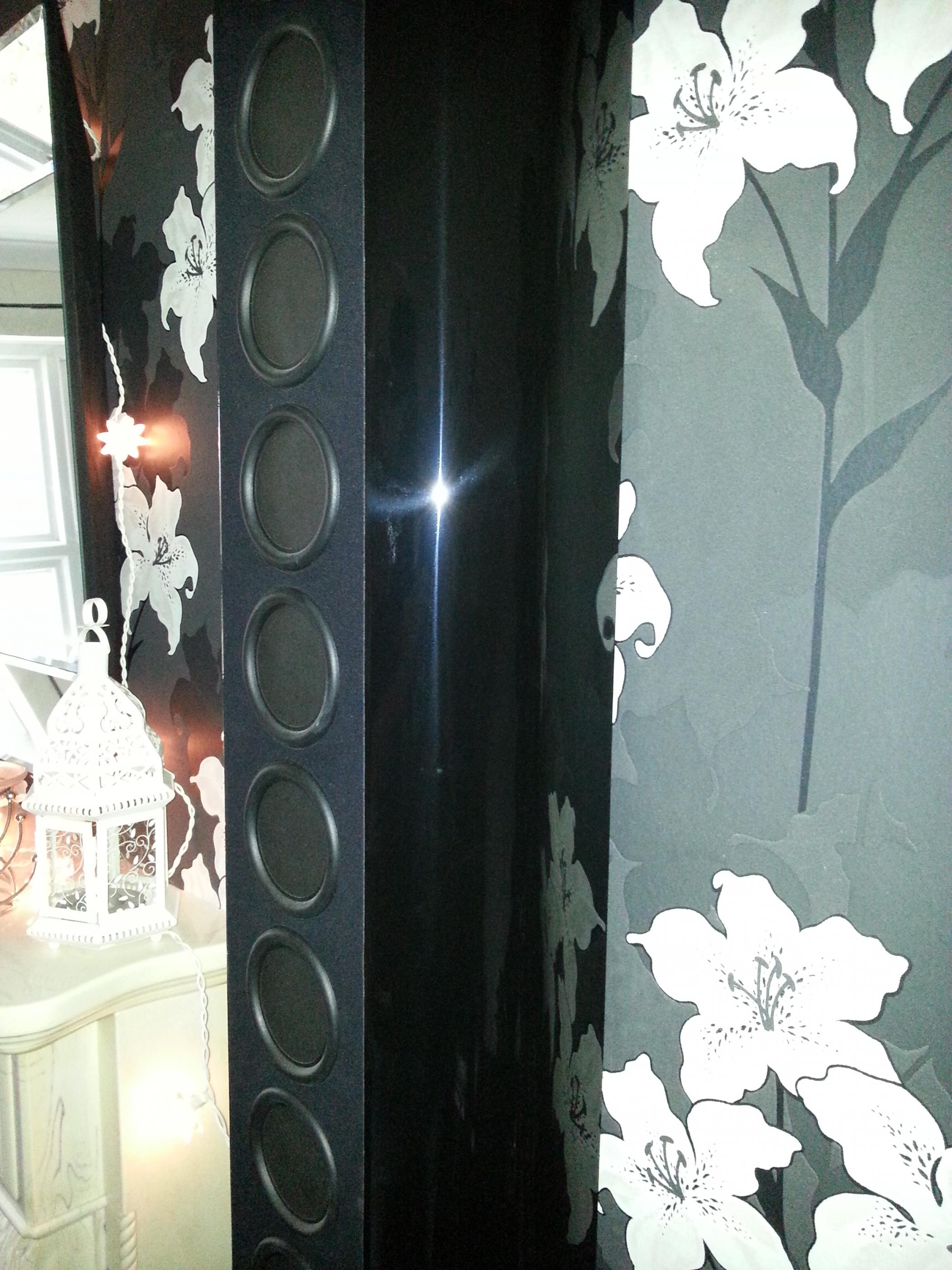

On wall Line Array
3 Attachment(s)
Hi Perceval,
I agree with Scottmoose, six of these drivers drivers will not make a good array.
Using conventional drivers you need to have a LA that is at least 50% of your ceiling height, ideally 75%, to avoid various sonic issues.
So I guess around 16 drivers per side is a good start, 24 drivers would be ideal.
Your room is great! Perfect for on wall mounting where you can take advantage of boundary reinforcement to best advantage and keep a high WAF!
Some Eq ( from any good AV receiver or in the fantastic JRiver media centre) around 150Hz to 300Hz to lower this band and a wee bass boost around 40Hz will be great.
I'd suggest a sealed box of around 3 to 4 litres per driver using 12mm thick bamboo plywood and good internal cabinet wall dampening and approx. 0.5 litre volume ( when lightly " fluffed up") of Twaron or similar internal dampening per driver.
Avoid stranded cable and solder joints as this has a big effect when using 40 or 50 drivers per pair of speakers, use 0.5mm silver plated solid core copper and crimp the joints, no solder!
Your suggested driver looks good value at $18...Buy 50 or 100 ( centre channel and rear speakers too?) and you will get a good discount, say $12 each...That would be a deal!
Adding in a line array of tweeters will be expensive, add complexity, introduce crossover phase errors ( unless done with a sophisticated DSP / software like Accurate) and take a lot of test and measurement equipment / experience to get right.
Stick with these drivers for your first build and if you get hooked you will be able to sell them for a profit ( they will sound great!) and then move on to a more ambitious mark two version.
I have attached a few pics of some of my Line Arrays using the fantastic ( but more expensive) 4.5 inch Neo motor BMR driver.
All the best and hope some of this helps.
Cheers
Derek.

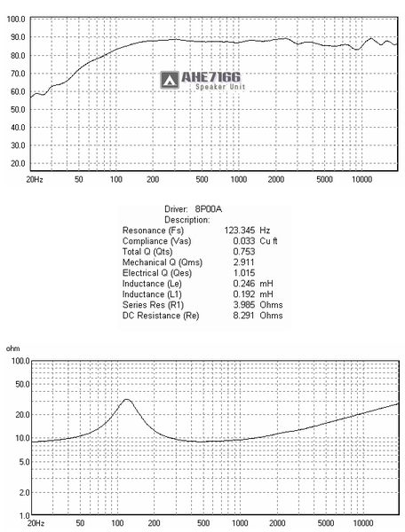

perceval 23rd February 2014 11:54 AM
1 Attachment(s)
Cool.
Now, I can get the 4" with the specs I've showed before, but they also have a 3" full range as well.
The 3" doesn't go as low as the 4", but they keep their strength over 17,000 ... where the 4" falls after 17,000.
Wondering which is better... lower end or higher end in the array. I do have 2 subs in the room.
xrk971 23rd February 2014 12:13 PM
If your sub is capable of crossing over at 200 Hz, go with 3 inch as you keep center to center spacing smaller for reduced comb filtering effects, better HF, etc. This is a good way to do it as you will be running a FAST line array.
