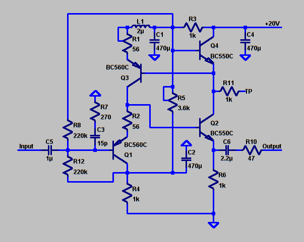

RCruz 17th February 2014 08:17 PM
Can it be modified to be powered by a 0 to +20V PSU ?
I know I would need to use a cap in the output but I would like to use it in a circuit that has not simetric psu :)

1 Attachment(s)
Quote:
Originally Posted by RCruz (https://www.diyaudio.com/forums/analog-line-level/251413-kuartlotron-keantokens-simple-error-correction-superbuffer-post3823300.html#post3823300)
For single-rail use, do this. This version has 110k input impedance. Use 22k instead of 220k for R8/R12 for 11k input impedance, but you'll probably want a larger input cap.
EDIT: Better schematic.
